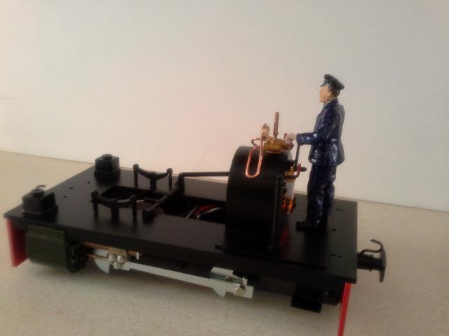

Post by pandsrowe » Wed Jul 01, 2015 9:05 am
Mine is also the cabbed version shown here before the body was fitted. I have found that to get effective haulage power I have to run the motor too fast for a realistic scale speed. The chassis comes with a 15:1 gearbox fitted and I have purchased a 30:1 gearbox to see if that makes a difference, although I have not yet fitted it.
I also fitted the batteries inside the saddle tank and the control gear, charging socket etc is between the frames under the cab. Quite a tight fit!
Generally speaking I think that it is a very worthwhile project and the kit from GRS does represent good value. (Usual disclaimer) It is definitely not a five minute glue together kit though, a lot of thought will be required to accommodate and fit your chosen control system, as the kit does not come supplied with anything.
