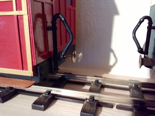

Bought some brass chopper couplings from Slaters yesterday. Had a good session today putting them together but had to put some of my own ideas into fitting them to my coaches as the small instruction sheet does not make things very clear. One great addition is one coupling has an up and over hook that locates over a horn on the opposite chopper, holding it in place. Hopefully the photo makes this clear.
Also, when not being used the couplings retract into the coach somewhat using hidden springs. When connected and pulling, the couplings pull out by about 7/8 mm allowing for a greater sideways movement on curves.
Anybody have any ideas on how to simply blacken the brass as I want it to look like old metal not painted.
