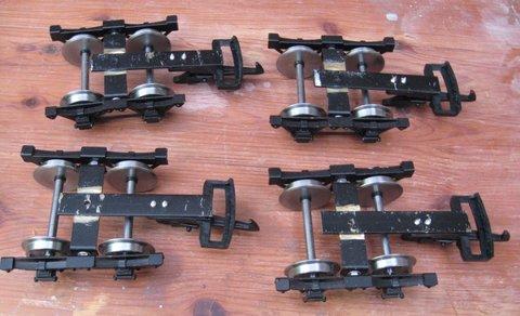

On my own three Bachmann coach conversions to 32mm gauge I removed the bogie couplings and use chain link instead. Because of the balcony overhang I have to use 4 rather than 3 links of chain and am restricted to forward motion only. Despite this I much prefer to see chain rather than bogie couplings.

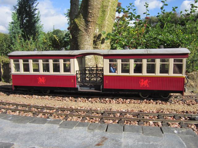

Another method to achieve much the same result is to follow full-size practice and pivot the coupling independently of the bogies. The picture of Ffestiniog carriage 19 shows the slot in the buffer beam that allows the coupling arm to slide from side to side, but the arm has its own pivot between the buffer beam and the bogie pivot. Most Ffestiniog rolling stock has this arrangement, including the locos.
https://www.flickr.com/photos/rpmarks/4346697728
Tony Willmore
