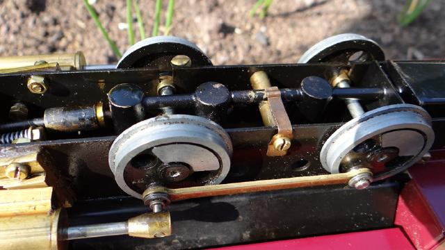

I've put the engine on a flat surface and it wobbles enough to say the wheels are buggered. When running over the points, it would get into the vee then either wedge or it would physically lift the engine out the point and off the railway completely. Frames are parallel and flat leaving the problem at the wheels.
Back to Backs are both 28mm but the tires on the rear set are about 1.2 mm thick compared to the 0.5 mm thick of the leading set. I suspect that's where the problem is with getting though the points. I think replacement is going to be the solution for this problem.
Hieght of the steam pipe inside the ome has been measured and its 10.5mm high so that shouldn't be a problem. There are no steam leaks bar lots of water in the cylinders when being run at the moment.

Sounds like MSS quality control has taken yet another nosedive.
The wheels should be made from the same Mazak castings which are machine finished, and then the appropriate coupling pin is fitted. So there should be no difference in the tyre/flange thickness between the axles. Just checked my MSS wheels, and a set of unused old Mamod SL wheels which I'm Loctite 603'ing back onto the axles. Both axles are the same and both sets of wheels are effectively the same - flange thickness is 0.05"/1.3mm & back to back 28.5mm.
I'd approach Dream Steam to have them repaired/replaced before you modify the loco thus invalidating your warranty.

I've contacted Dreamsteam and they've been very good about sorting it out. They're sending out a complete spare set of wheels so that a good pair can be made out of the four wheelsets for the engine. Hopefully that problem should sort itself out over the next few days.

Well the wheels arrived yesterday which considering I picked them up from the sorting office the day after Royal Mail tryied to deliver it. Bar a messup at my end, 24 hours from complaint to parts arrival, its safe to say I'm very impressed with the service.Chris Cairns:100596 wrote:That is great to hear Jon.
Hopefully PeachBottom will see your posting and similarly get some replacement wheels from Dream Steam for her problem MSS loco kit.
Chris Cairns
The wheels have been fitted and the improvement is massive. The engine is a lot better running and will now safely run though my points. Also because its now a better runner, the steaming problem isn't anywhere near as bad as the wheels are rubbing on the frames (there are rubbing marks on the frames around the rear wheelset).
Jon

Hi,gamma:100668 wrote:I am a newcomer too to the steam locomotives world, my MSS , fortunately, since the beginning had no troubles at all to steam up. Only the wheels have the same problems of yours, i can run the loco safely only at low speed.
Is is my intention to replace the wheels, is it a ddifficult job?
It was relatively easy but you do have to take a hell of a lot off to remove them and replace them.
I had to take off the following to get the wheels out:-
- ~Rear drawbar
~Rear bodywork
~Centre frame spacer
~One side of the frame spacers on the reversing block
Jon
