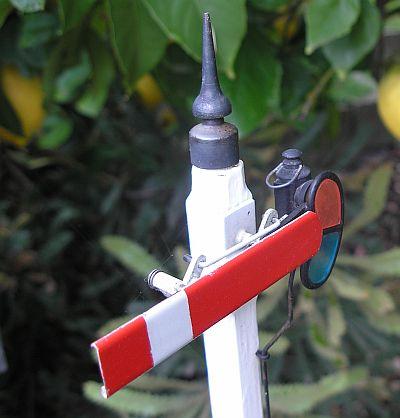

I used the Cambrian signal parts as my guide, so nothing very scientific. I'm sure there will be others with more knowledge of IoM prototypes for example who will give you dimensions which are more prototypically accurate:
My arms were 12mm x 65mm (with a 5mm based triangle taken from one end)
I then soldered on the spectacle frames, which were roughly 12mm x 25mm (wound round two dowels)
I think the arms look slightly overscale - but then it could be argued that on narrow gauge railways there wasn't really a 'standard' size

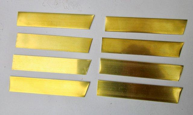

Guess I'm a bit late coming to this topic. For the signals on the LNR, I came across some old office furniture that had a brass section on the drawer fronts shown in the pic. made to slide name plates into.
It scaled out to Victorian Railways size, and allows you to build the pivot point on a brass plate and slide it to the appropriate point before fixing. Very important especially with somersault type arms. Also allowed thin lead to slide in for balance, and adds some rigidity to the arm. Don't know if it exists in England, but I'm guarding my piece.
Grant
