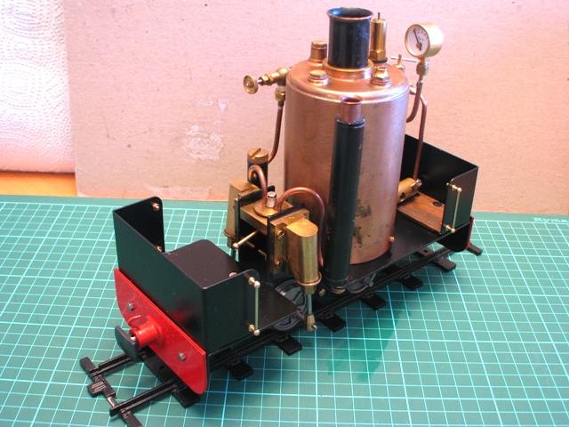

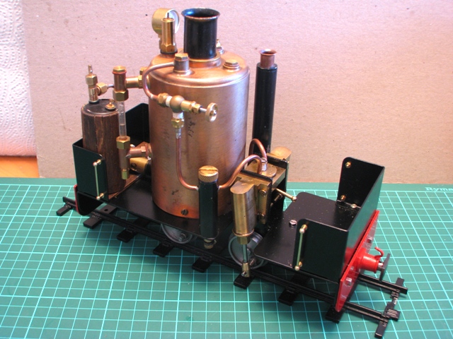

One of my recent locomotive purchases is a PPS/RWM De Winton. Although I have the prototype PPS De Winton which is in the long term restoration queue, and a Mamod Brunel which is still waiting to have a modified lubricator fitted, I was intrigued with this PPS/RWM De Winton as it was not a finished running model. The RWM optional boiler cladding is included with this project.

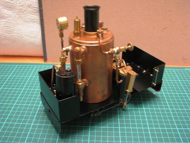

This started out as the vertical boiler being bought from PPS for a Railcar project by the previous owner. The boiler was made by Cheddar Valley Steam. It has 4 bushes on the top (adjustable safety valve, water top up valve, blanking plug & steam outlet). The sight glass fitting has a neat drain valve on the bottom. I had to supply one 'O' ring for the sight glass tube, and a fibre washer for one of the sight glass mountings. The fibre washers for the top fittings were very dry so these have been soaked in oil a couple of times to get them to swell out & seal better. One of the changes Roy Wood made was the use of a banjo bolt fitting for the steam outlet rather than the previous PPS screw-in fitting.
When the Railcar project was cancelled the previous owner bought the remaining parts from RWM Steam to complete this as a De Winton, and subsequently I purchased it to finish this project. It is a unique "one-off" with the equal low height cab side panels

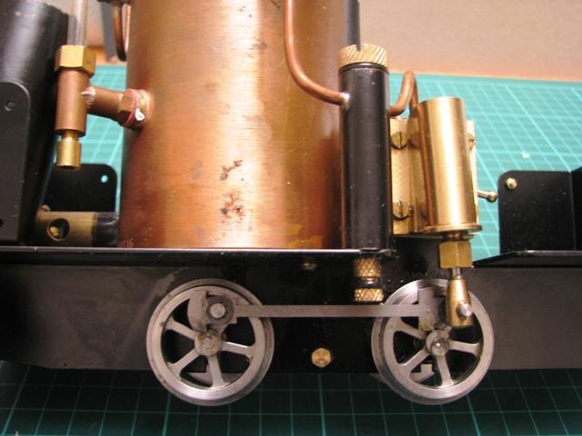

The chassis side frames are inverted elongated 'T' pieces where the oscillating cylinders are mounted on the vertical portion. It has the RWM upgraded cylinders which are mounted with brass spacer blocks for 45mm (see below for gauge changing), and the RWM upgraded reverser valve. Interestingly this uses the same style of block as MSS do (with a slight misalignment of the steam holes on the side as well) but a properly machined rotary valve. I had to open out the steam holes in the chassis side frames, and open out the corresponding holes in the paper gaskets used to mount the reverser valve, spacer blocks & cylinders. The screw used to mount the rotary valve of the reverser is somewhat loose so does not always rotate when you move the reverser so this will either need the use of a tightening bolt or some thread lock. The chassis side frames are mounted using 5 spacers, with the 2 uppermost being screwed to the main chassis by hex head 6BA bolts from above.
The main chassis is 'U' shaped and comparing several photos of these De Winton's it looks like some of the 'U' bends were reversed. There are 2 holes just forward of the boiler to mount the lubricator on one side, and the oil separator tank or optional Summerlands Chuffer condenser/resonator (as this one has fitted). Most of the De Winton's I've seen have the lubricator recessed towards the boiler and the oil separator on the edge of the chassis, but some like this one have those holes reversed. So my lubricator is mounted on the edge of the chassis which requires its pipework re-bent so the globe valve regulator is not sticking out too much. I'll complete this after the boiler has been painted, clad & mounted properly.
There have been two styles of lubricators used by RWM. One is a shorter version of the Roundhouse style lubricator with the protruding drain plug, but the other style as fitted here has a more convenient drain plug fitted to the mounting stud. I've not managed to run this on 45m track yet so limited to running on blocks (the coupling rods are not compatible with my John Prescott rolling road), plus a couple of goes over some carpet tiles, but it does not seem to use much 460 steam oil. So I've been using 220 steam oil instead during the running in which is clearly being used & lubricating.
So the other changes that Roy Wood has introduced is fitting the globe valve regulator prior to the lubricator (PPS did it the other way round which caused problems with oil being sucked back into the boiler by the vacuum when it cools down after use), plus fitting 2 large steel weights to the chassis to improve traction plus to help lower the C of G (the boiler is too tall for 16mm scale).

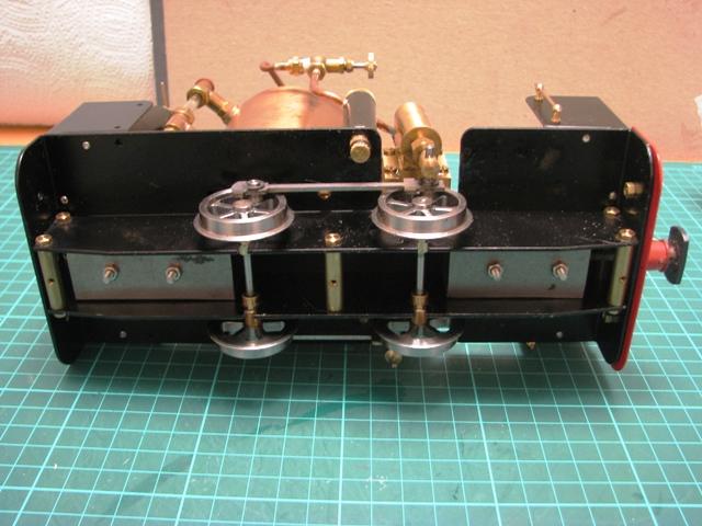

So on the RWM Steam website it says "De Winton is available in either 32mm or 45mm gauge but is not alterable between the two" but is that strictly correct? Although it is not as easy as changing gauge on a Mamod SL/MSS locomotive, because the chassis side frames are spaced for 32mm wheels (the 45mm wheels fitted here use the same push fit bearing & spacers as Mamod SL/MSS's use) and the cylinders are 32mm ones which are fitted with brass spacers for 45mm, then you can change gauge but there would be a lot of dismantling involved.
The gas tank that came with this project is leaking but I'm hoping I can get it soldered up (there appears to be a lack of solder where the gas pipe screw fitting has been mounted in the turret, so I'm using another gas tank for now). The boiler also needs 2 mounting holes drilled out and the corresponding mounting blocks tapped. I'm impressed with how easily it runs and it is very well controlled on blocks. But as I do not have a decent pair of 32mm push fit bearing wheelsets at present (one axle still on the rebuild 'To Do' list) I'll probably run it in 45mm initially.

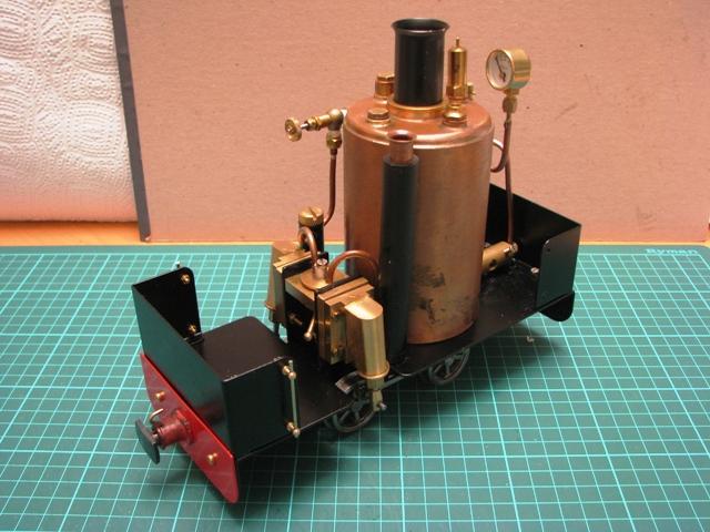

Handrails all trimmed to length and fitted, rivet detailed buffer beam overlays fitted and mounted using 1 size smaller head 6BA bolts & nuts (still to be painted), resonator/chuffer assembly moved further outboard on the chassis away from the boiler, stained wood floor panel fitted to firebox end, repaired gas tank clad with stained stirrers, coffee filter paper added to gas burner (after clearing a blocked jet) and the ceramic material edges sealed with instant gasket, and chimney fitted to boiler collar.
I purchased this kit of bits in 45mm on the assumption that it could be re-gauged to 32mm. Our 16mm NGM Group attended a Model Railway Show last weekend and initially I was going to run this on blocks on our demonstration table still in 45mm.
However a recent posting from dougrail advising that the RWM Steam spoked wheels were not a direct replacement for Mamod SL/MSS's sent me into a mild panic. My intention was to fit some Mamod 32mm wheels which I'm fitting to replacement axles. However as Doug had posted you need to ream out the Mamod SL/MSS chassis holes to fit those spoked RWM wheels. So I now had the opposite problem with the RWM chassis holes being oversize for the Mamod SL/MSS bearings.
Much that I like them I could not justify buying a new set of 32mm spoked RWM wheels. I did consider fitting new axles to the 45mm ones but a cursory glance at those wheels confirmed they were not just a push fit like the IP Eng ones. So I was left with a set of early Dream Steam steel wheels (probably old IP Eng stock) which I'd removed from a modified SLK1 project because I could not get them to free run.
The RWM De Winton chassis has 5 spacers which offered slightly better alignment options for those troublesome wheels, and after nearly a full day of tweaking this & that I had a very free running chassis. As I had not removed the coupling rods from the 45mm wheels, and they still needed painting up, I decided to run the De Winton as an 0-2-2-0VB.

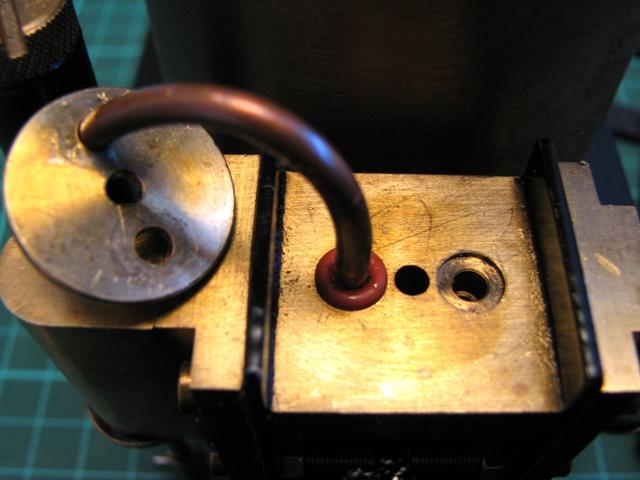

So I re-assembled the loco but a quick run found that the reverser valve was leaking more than before. This was dismantled again, pipe geometry confirmed or adjusted to be at right angles, lots of steam oil & re-assembled.
I ran this loco on blocks, plus one short run around the portable layout on the Saturday with a noticeable leak from below the 'O' ring retaining plate, plus some leakage forward from the reverser valve itself.
The valve retaining screw still works loose as you cycle the direction back & forth (I try to even out my running in both directions on blocks), so during the preparation for Sunday's running I tightened up that retaining screw again, which reduced the leaks quite a bit.
Just been through it again in more detail today. Looks to me that the 'O' rings are slightly oversize for those chamfered holes, and the spring is the wrong type (the photo above shows it in the position from Sunday's run, and is effectively fully compressed). I do not have any alternative springs so I've fitted another washer below the spring, and for now have just oiled up the 'O' rings. I do not have a suitable threaded nut to use on the end of the retaining screw, so will need to retighten it where necessary (I tried some threadlock which did not hold up to the heat, and I do not want to use my high temperature threadlock in case it causes problems with disassembling later).
