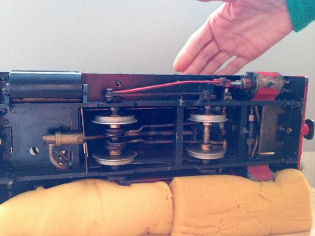

Nice to see you again Mrs F. Interesting little engine you have there, in not convinced its a Dacre though. The chassis looks like an early Lady Anne example with the horrizontal rocker arms and the smokebox is very close to the Lady Anne too. Has the boiler got any marking on it ? If it is a roundhouse boiler there should be a plate on the back, if so a standard safety valve should fit. I cant see a regulator, is this missing also ?

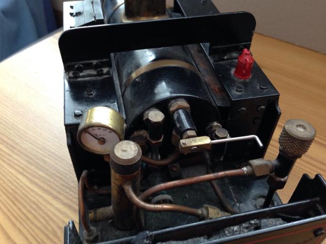

Ok, I've forgotten how nice it is to share a problem! Yes adding more photos and have now investigated both ends of boiler! The front is stamped 50PSI there may be something before it but there is a fitting in the way! The back is stamped
MJC
11/94
There is no roundhouse plate. To answer a couple of questions yes I am pretty sure it is a Dacre as I also have the original plans with builders notes! It has got a regulator it sticks out the back of the boiler into the footplate. There is also some sort of missing valvewhich Mr F C assures me is to do with regulating the amount of water as in the Accucraft Mortimor we had. This sticks out of the side of the footplate and following the pipe goes into the boiler and off to the sight glass. We know it was also converted from meths to gas fired. Hopefully the photos will load up!

Thanks for the photos, very interesting. A few observations...
The cylinders look to be from Roundhouse. If the 1994 date on the boiler is accurate then it is a little surprising that the cylinders are of the older rectangular valve chest type as these went out of production around 1990.
The axles, wheels, cranks and valve gear all look to be from Roundhouse as well. In particular, the wheels and axles look to be of the current gauge-adjustable type. Replacement valve gear is still available I believe, should it be needed.
The lubricator looks to be a Roundhouse item too.

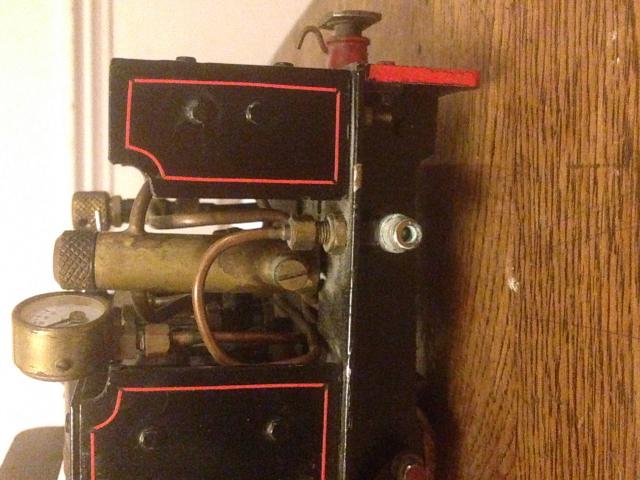

The fitting under the left-hand doorway is an Enots connector for pumping water in to the boiler, presumably via the clack valve on the right side of the boiler backhead.
It is hard to tell from the photos but that bush on the top of the boiler looks as if it would happily take a Roundhouse safety valve.

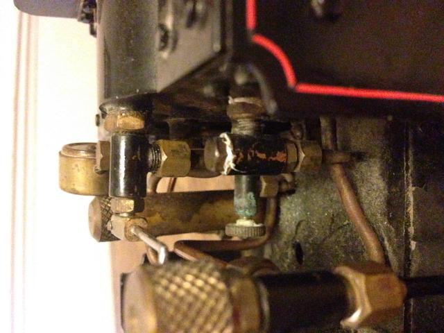

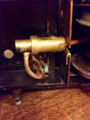

The little pipe that comes out the bottom is the blow down for the sight glass, that's what the little valve is for. When bubbles appear in the sight glass, a quick flick of the valve will clear it. Its a feature normally found on larger scales. As Tony has said the fitting below the footplate is the water top up valve which then connects to the check valve. If the loco has indeed been sat for 10 years then I would carefully clean this part. It contains a small ball bearing that plugs the hole in the bottom, again more common in the larger scales. The one thing that's puzzling me more than anything is the gas burner which appears to be a length of copper pipe, I'd be interested to know if it works.

Well chaps you have been very enlightening so far! Just got a telling off from Mr F C for describing the pipe wrongly. You are indeed correct and it goes from the emits valve by the left side doorway to what is indeed a check/clack valve across the other side of the footplate and into the boiler. The other little pipe with the end cut off underneath comes from the sight glass and through a little wheel which presumably if you could reach it but actually you'd burn your fingers off you would crack open when necessary! So yes I am sure you are all absolutely correct in your diagnosis!

Would that be the SV?Mrs F Controller:108336 wrote:Found it!! Fits perfectly so must be the right one. Just went back to where I purchased it and asked if they had any box of bits and there it was! 👍
If not, you could take an impression of the SV fitting thread in plasticene or similar, measure up and see if it matches a standard thread. That might be enough to finger what you need.

Yes it was sorry didn't make that clear. Piece of luck wasn't it!
