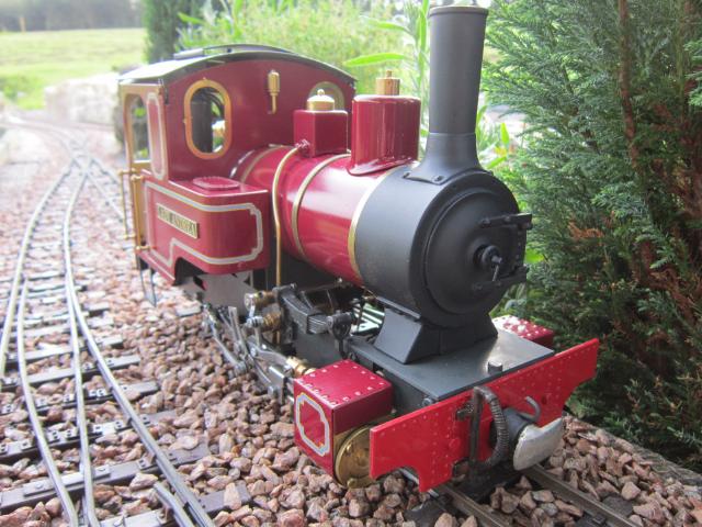

Chris Cairns:106379 wrote: I'm considering repositioning the bottom handrail knob and fitting longer handrails as the current ones just look too short to me.
Chris Cairns
Agreed Chris.... and this is what it will look like with extended handrails

Those look more prototypical Peter. Have you used rivets to fill in the original bottom holes?
I like your colour matched cylinder covers - might have to copy that enhancement idea.

The original holes were filled with round headed brass pins/nails with the shanks cut short and secured with epoxy (as I recall!) but I'm sure solder could be used and leave no marks at all.
The Roundhouse cylinder covers do look improved with colour matching and the lining helps too!
