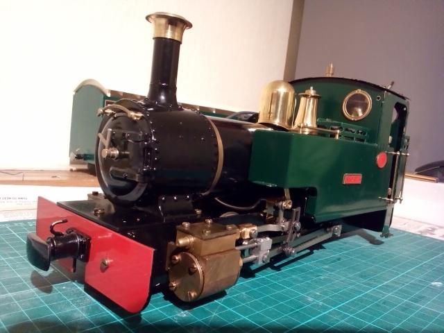

Hi. This is my Lady. Kit built about 20 years ago and is still my main service loco. (I really must get around to changing all of those slot head screws.
.) Just get a good set of small files for fettling stiff joints and maybe have a practice at solderting sheet brass beforehand. A joy to put together and still runs beautifully. Maybe needs new piston O rings by now. I might get around to that this winter. I have not added much apart from Timpdon radio control and a Summerlands chuffer. Hopefully running her with my WHR stock in North Wales tomorrow, weather permitting.
