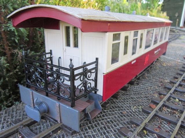

Hi guys,
Got my hands on three beauties of custom Bachmann G Scale bogie coaches - at a handsome steal of a price. Some work needs doing though.
1)Wheeling. They came with plastic 45mm wheels. I've got a ton of Accucraft WL 'Z5' 32mm steel wheelsets on order, so that's the easy part.
2)Transfers. These coaches came in a mishmash of transfers - 1920s GWR, crests, 1930s shirtbuttons and two came with "OCEAN MAILS" on but in mismatching fonts [different fonts for each carriage].
Anyone have any advice on removing transfers? They don't seem to be varnished over but I would not scratch or unsettle the paintwork.
3)The big one - couplings
This is how the three carriages came.
As mentioned I have some steel wheels on order. I wonder though, to get some decent couplings, whether the entire bogie at each end should really be replaced to boot?
Or is there a way to fit 16mm couplings - Multiheighters or Accy choppers - to these current bogies?

dont GRS sell a whitemetal casting that centre buffer coupling that can be screwed onto the coupling shank from the bogie, matches up with roundhouse couplings ok i believe. Could always bodge an accucraft coupling onto the end of the shank, or maybe replace the bogies with accucraft ones? Trackshack used to sell them as a seperate item i think?

If the transfers have not been varnished over, and the transfers are waterslide, then applying some water to them should make it possible to slide them off. Alternatively, applying oil based varnish might dissolve them (that's what happens to Brandbright waterslide transfers anyway!)
Not sure what to do about couplings, whether you can attach them to the current bogies, use Accucraft L&B bogies or maybe fit a new bufferbeam with coupling.

Post by GTB » Fri Sep 05, 2014 10:33 am
dougrail:103876 wrote: Bogies, wheels, transfers, I have a start on. The next part will be the balconies - the Bachmann efforts look positively rickety. Wonder if Accucraft do their Pickering gates separately too, or if I should get some 3D-printed?
Bachmann copied the bogies on the Jackson Sharp cars from LGB and the coupler mounting is the same, more or less.
They usually come fitted with a knuckle coupler, but if you remove the circular plastic boss under the tip of the coupler mounting arm, a Roundhouse CCBR type centre buffer coupler screws straight on with a suitable size self tapper. The square pillar further back can go as well.
The coupler will sit at about 25mm above rails and just clear the headstock as it swings. Coupler height obviously depends on wheel dia. though and the Bachmann ones are 31mm dia from memory.......

Thanks for the info there. I'm looking back and the LB bogie may not be an idea. I've selected the Accucraft W&L 31mm diameter "Z5" wheelsets to replace the plastic ones, so I should avoid the height issues.
The bogie replacement - not worth it. I have wheelsets in hand and have secured some Roundhouse couplers with the "tails" on that I can secure to the bogie shanks directly for a centre-buffer coupling [much easier than multi height couplers, and much less cost too!]
