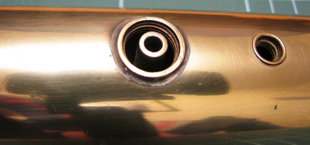

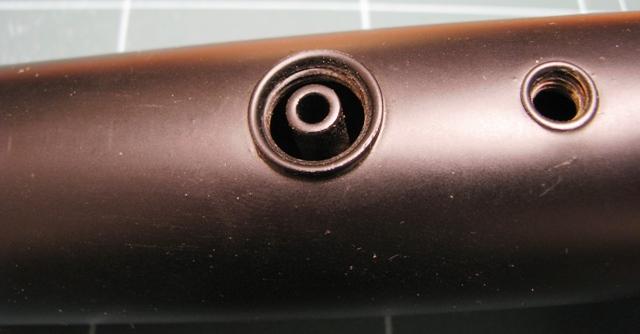

Steam Dome Boiler Inserts
Post by Chris Cairns » Thu Nov 07, 2013 7:16 pm
Ace,
Thank You for your answer regarding sealing the steam dome nut. I've never managed to find an off the shelf fibre washer that fits properly but that may be because it is not a British thread size as you would think (the rest are) but a metric size (M12 x 1).
Another useless bit of Mamod/MSS trivia. Here is my workshop Mamod boiler which is a refurbished riveted back plate model.
This is typical of the type of steam dome insert I'm used to experiencing with a flat top (most are in worse condition than this one, possibly because of the sharp edges left on the dome nut after machining).
By comparison here is the steam dome insert on my MSS kit built loco.
This one is clearly shaped on the inside edge so that an 'O' ring will mate with that surface.
However here is another interesting comparison.
Looks just like my MSS above, but in fact is the boiler from my collection unmade SL1K kit. This is an Ascot, Berkshire Mamod Limited version which would date it between June 1982 & Dec 1984. Be interesting to see what the insert looks like on my SL6 (the last SL to be made only in 1989) but it is currently buried in my collection boxes for now (just added to my "To Do" list the next time I rummage through them).
Chris Cairns.

Thanks for the triva Chris. It is interesting to see the difference, when I get home I'll check out my sl6 to see what is there.
If I could remember the packet or part number, there is an off the shelf washer that can be bought and lightly filed to fit. I see no point in doing this because the o ring is a better fit and very seldom gives trouble. I'd rather grind or file out the edge off the inside of the dome insert to fit it and it allows the dome nut to be done up finger tight.

Until recently my MSS running experience was limited to their Saddle Tank which has a smaller steam dome nut which is not normally accessible. So I have adopted the practise of injecting steam oil into the cylinder back plate holes on locomotives without a dedicated lubricator.
Whilst I do not like the visual effect of the smaller MSS steam dome I can see the advantage of it being easily removable to allow steam oil to be injected down the main steam pipe instead. In fact I actually purchased another used MSS steam dome from Doug (dougrail) via eBay to experiment with further on my non-lubricator fitted Mamod SL's. So it is now just getting the right size 'O' ring and having a closer look at those steam dome boiler inserts.
