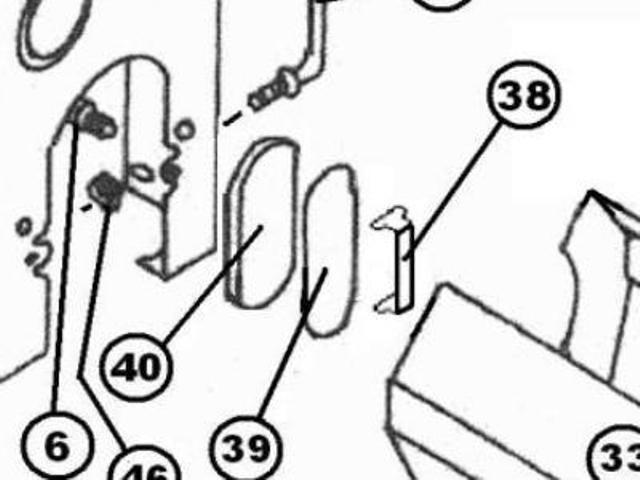

The original Mamod SL boiler design included a reflector behind the sight glass plastic ( Part 38 ).
This worked very well in conjunction with the marked maximum & minimum marked levels on the brass back plate. It did not however stop some boilers being boiled dry, probably with meths or gas burners.

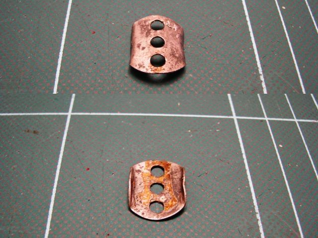

For those wanting to replicate this reflector here is some appropriate measurements of one from an SL1K kit.
Worth pointing out that none of the current Mamod locomotives have a reflector (Golden Jubilee, Harry the Rocket, William, William II, Mamod Train/Mark I, Mark II & Diamond Jubilee) and with the bigger boilers and black gas tank alongside (not Harry the Rocket) it is a lot harder to see the water level. Not having access to suitable stainless steel sheeting I have used a strip from a metal food container but it is difficult to get a smooth surface with that material (still better than nothing).

Isn't this a reverser o ring retainer washer? What a funny place to use one?
Chris Cairns:89764 wrote:Image
I must confess that when it comes to the sight glasses, in my opinion if they don't leak then leave it well alone. I'd rather not put unnecessary wear and tear on the threads of the boiler for the sake of a foggy glass. I know my Mamods quite well and know by timing that they are due for more water. The ones I have with filler valves as Sam said, I use a torch. If you de scale the boiler regularly enough it keeps the fogging down to a bearable minimum.
That's what I do anyway. :)

ace wrote:Isn't this a reverser 'O' ring retainer washer?
I had not considered that possibility but it is actually made of a different material - aluminium.
Just goes to show the poor quality control that MSS operate with - What day is it today, oh it is Wednesday so I guess I should fit a reflector. D'oh!

Chris Cairns:90054 wrote:I had not considered that possibility but it is actually made of a different material - aluminium.
Chris Cairns.
Umm that is sad.... From your image it look like it is made of brass with solder on it.
Chris Cairns
Posts: 2372
Location: Glasgow, Scotland
Post by Chris Cairns » Thu Oct 03, 2013 1:12 am
No that is just the discolouring that has gone on since I last ran this loco, probably a few years ago now. I tried to polish it up before refitting it but it has still got some pitting that would need sanding out. But it will just go off again when it gets wet so it would be a bit of a wasted exercise.
