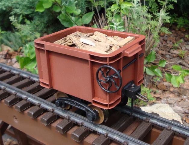

It's the handles on the end that gave it away to me, you could try disgusting those?

Someone made some and displayed on the 7-8ths.info site sometime ago. They used the clips that hold the tops on as bogies
Your effort is superb...it looks the real thing...i must have a go

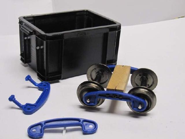

For those interested there is lightly embossed lettering on the box. This can be lifted off with a sharp blade and when painted doesn't show. The larger area of letting on the end can be covered with a square of plasticard that looks like a panel.

Hi, these are cheap wagons...thanks for the reminder as I have several at home to do...must empty the screws out of them.
Just for you RylstonLight here is the link to 7-8ths.info page where John Foley has done something similar...as it would seem others have.....who needs the major suppliers...just need Staples!!
http://www.7-8ths.info/index.php?topic=16682251.60
Read the who topic it also discusses paint that will stick to the plastic..
John well done...I hope you don't mind the link
I upload two pictures of Johns fine efforts which will show what he did with the locking handles.......I wonder if the really big ones would run on 3 1/2" or 5"?????????

Now those handles are really clever....

And to think I just threw away the fasteners!
Is there a problem getting paint to stick? In my innocence I just sprayed them with Halfords Yellow pastic primer chosen for it's colour. Seems to have worked okay.
EDIT: Thinking back I am sure I burnished the sides with a fibre-glass pencil to improve glueing on the extra trim. That may have helped the paint stick too.
