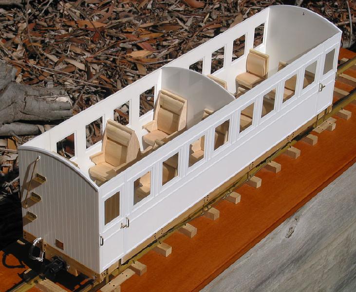

This pic shows an assembled first-second class car body sitting on the underframe, with the seats sitting in place, but not attached. The sides are my usual three layers, with recesses on the inside for the window material and with the beading built up using Evergreen strip. The seats were built up using homemade wood mouldings for the cushions and plywood frames. First class has head and armrests, while second class is more basic and the seating is 2+1.

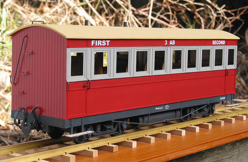

The sun finally appeared this afternoon and this pic shows the first-second car completed, painted and assembled, ready to enter service.

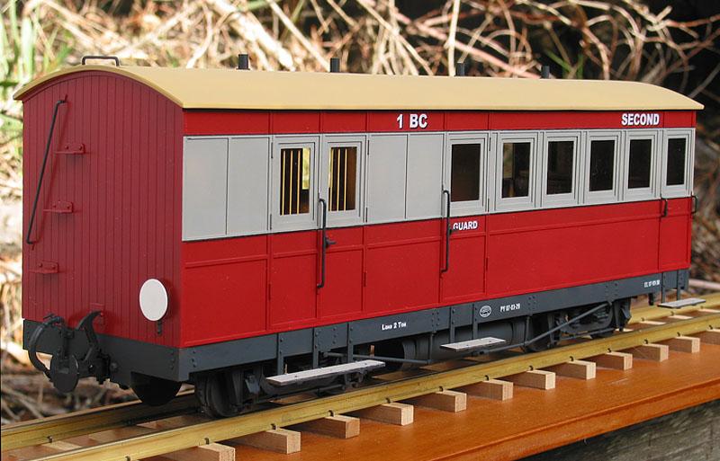

This is one of the second class with van cars as completed. The other one is the same except that it was built as a mirror image, which was another quirk of some VR built passenger cars.

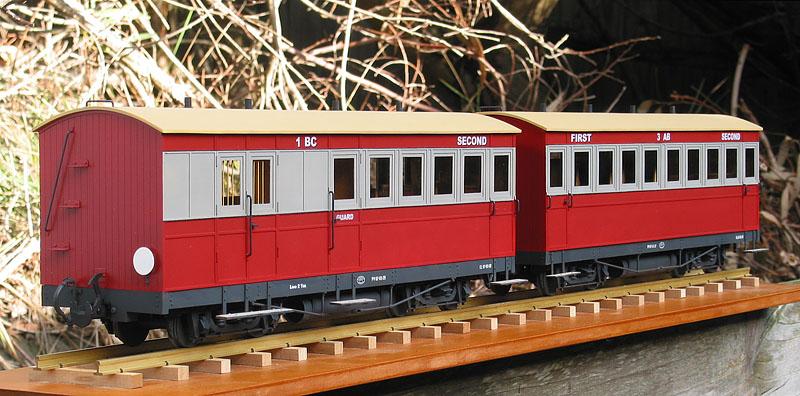

My photo track isn't long enough to show all three cars, but here are two of them to give the idea. A standard TVT passenger train would have a van at each end, with extra cars added in the middle as needed. The white disc on the van end is a taildisc. The VR used these on the rear vehicle of a train during daylight to show railway staff that the train was complete. At night a red tail light would replace it.

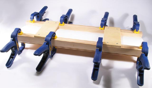

The roof on these cars was too long for my usual method of forming a polystyrene sheet roof, so I made a wooden former and laminated three pieces of 0.020" sheet to form the roof. Three layers was enough to give a rigid roof that held it's shape without extra bracing after the glue dried. The pictures show the arrangement.

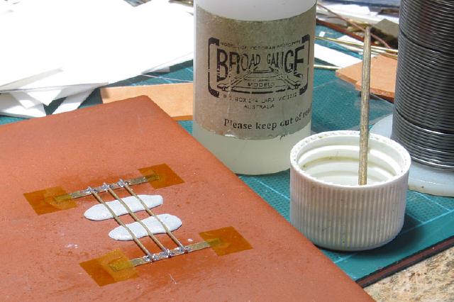

The grill in the van doors was soldered up out of brass wire and strip. These were drawn on an old tile with pencil and the parts held in place with kapton tape and Blu-tack, which isn't as heat resistant as the tape, but keeps parts in place if you are quick. The photo shows a soldered grill still in place on the tile.

Really lovely. Can you share any more on how you laminate the roof - what solvent you use, and how you get it done neatly, etc.? (I'm a bit useless at these things with plasticard - confess I normally buy the plastic roof mouldings from GRS.)

hussra:84726 wrote: Can you share any more on how you laminate the roof - what solvent you use, and how you get it done neatly, etc.?
I normally use MEK for glueing polystyrene sheet together, but it evaporates too fast for laminating. MEK can also cause cracks in polystyrene that is under stress, eg. when being forced into a curve.......
For laminating polystyrene I use a solvent called d-Limonene. It evaporates fairly slowly so gives a little working time. To laminate sheets, I put the first one on the bench, brush a layer of solvent over it and quickly place the next layer in place. Repeat for the third layer then run a brush load of solvent around the edges in case any bits got missed. Being slow drying, there is some slip available for a few seconds, giving time to move the layers a little to line up the edges if necessary. In the case of a roof, the sheets are cut a few mm oversize to allow for trimming to final size when everything is hard.
For a roof, the layers are then placed on the former, the clamps put in place and it's then left for at least a few days to slowly harden. I leave them for a week to make sure and get on with something else. The wooden former I use is a little smaller in radius than the actual size needed, so that the roof pulls down to a neat fit along the sides when it is in place.
Once everything is nice and hard, I mark the roof to final length and width with a pencil and trim to the line. A file and a sanding block for the ends, a small block plane for the sides. Polystyrene sheet is actually easier to plane than wood as it has no grain, just make sure the plane blade is sharp and take only light cuts.
d-Limonene is a byproduct of making orange juice (it's the oil in the peel of citrus fruit which gives them the distinctive citrus odour) and is available in hobby shops in small quantities from several suppliers here in Aust. It goes off over time in the bottle when exposed to air, so is best bought in small quantities.
Microscale from the US sell it as 'Micro Weld', so it may be available in the UK from hobby shops that sell their products. It works well on injection moulded kits, which is why I think Microscale sell it.
Laboratory suppliers sell it, but the minimum quantity will probably be 1L and it's also available in industrial quantities. I'd be lucky to use 10ml a year, so I buy it in 30ml bottles from a hobby shop.
It may also be available from health food shops and similar places, as it is a 'natural' product. A Google search turned up some UK possibilities.
It can't be posted in Aust. or the US, as it's a class 3 DG. Probably the same in the UK.
