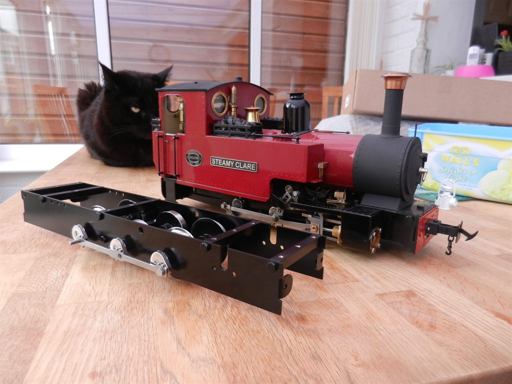

Post by tom_tom_go » Sat Jun 01, 2013 2:03 pm
So back on topic after my thread was hijacked ;)
I always thought I would only ever have just one live steamer, how wrong was I :)
Molly (the cat) looks annoyed because I sold the diesel chassis that was meant to have her name on it to help fund this coal fired project.

tom_tom_go:84172 wrote: Molly (the cat) looks annoyed because I sold the diesel chassis that was meant to have her name on it to help fund this coal fired project.
My sub-miniature tiger wears that expression frequently, especially when I chase her out of the workshop.
Nice paint finish on the new chassis. When is your Riverdale boiler due for delivery?
I see Riverdale are proposing to do a coal fired kit for Katie. Now you know the next project to start saving up for........ ;)
Post by tom_tom_go » Sun Jun 02, 2013 1:33 pm
Having owned a RH SL for a few years now I can say although it's very pretty and has rivet detail, simulated drain cocks, sprung chassis, etc if I could start again in this hobby with the knowledge I have now I would of gone down the kit building route and bought a Lady Anne saving myself quite a few quid. I really don't think the sprung chassis makes a difference in performance in this scale.
I can't take credit for the paint job on the chassis as this was done by a family member who runs www.smtsmodels.com as I am building their website. It has a satin finish unlike the RH factory paint which I prefer. The boiler is due in October which seems a long, long time away!
