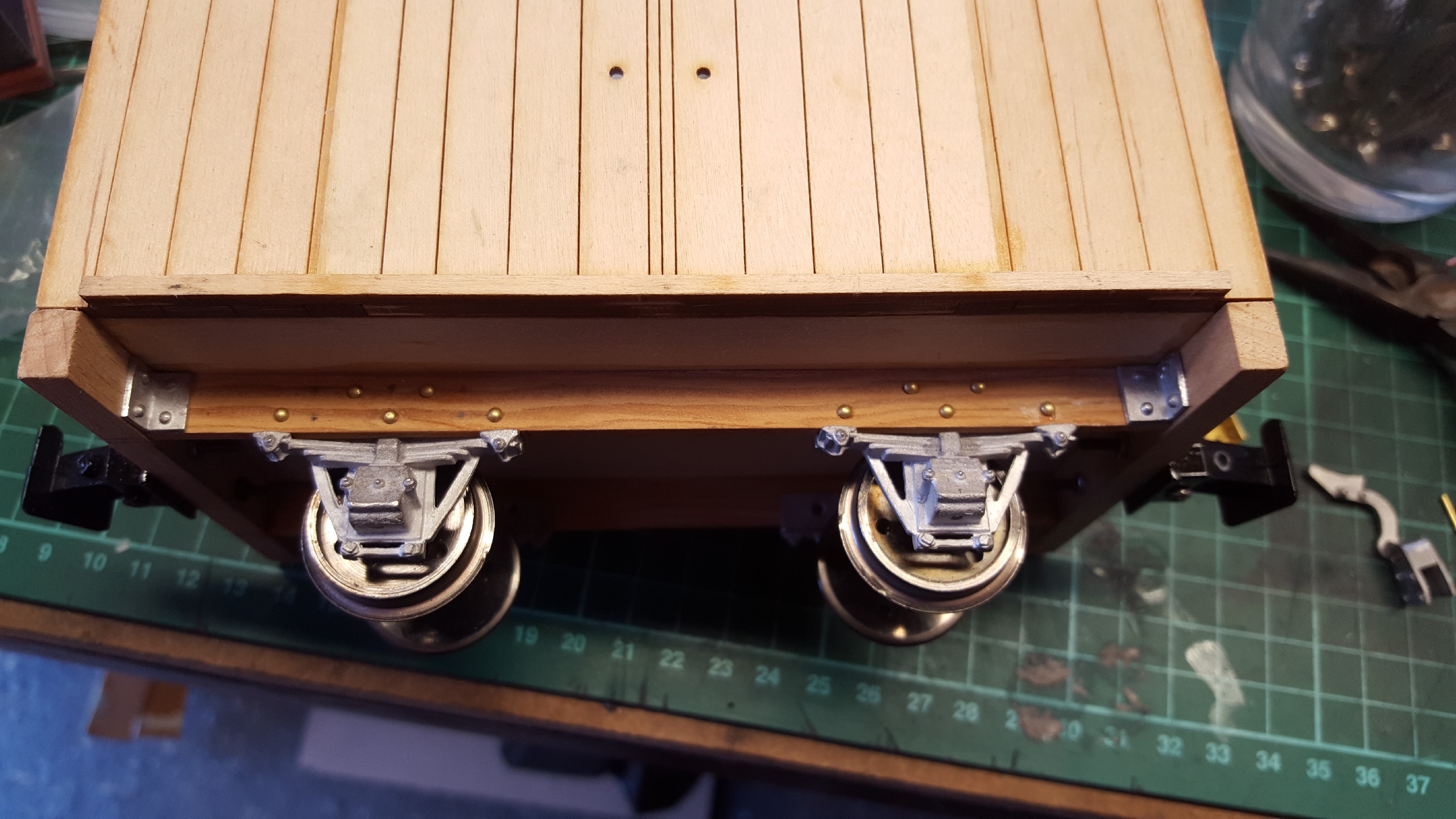

Sole bar detail started:

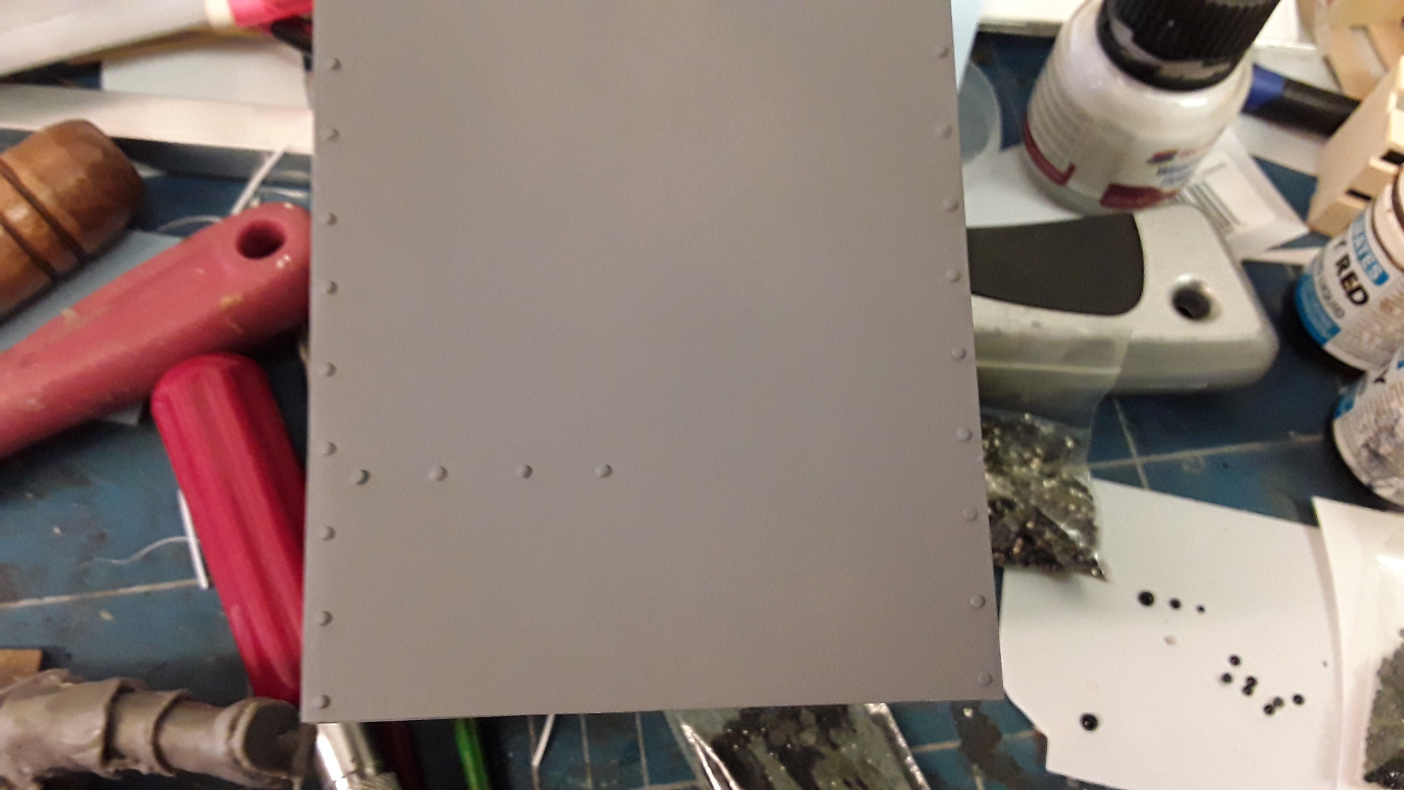

I tried to use the Cambrian Models rivets heads but I lost the will to live after a few attempts so went for the drill and rivets approach instead :mrgreen:

Nice and square Tom. I have never used Cambrian rivets but have found the nail art rivets have a flat base and hold well (so far)on wood with a drop of super glue.

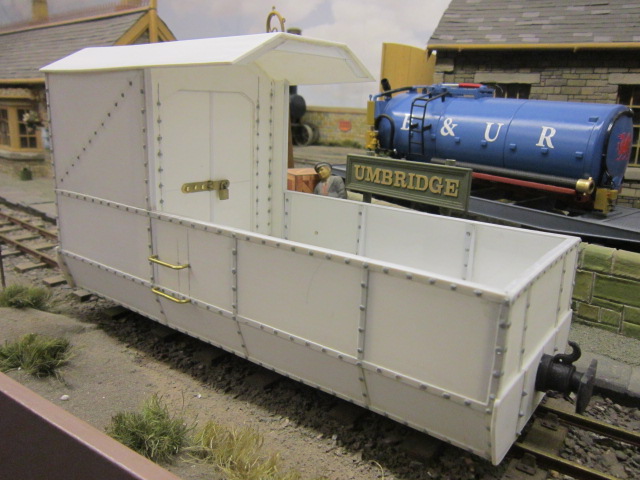

I think Cambrian rivets would be difficult to use on wood but on my plastikard builds I find them very user-friendly despite being fiddly. I have described the method I use in my 'Time to build a railway' thread and have just finished the construction of my latest project.
I'm not a rivet counter but I have counted the rivets on this build which took me about five hours to apply...... 517 in total.

Hi Rod, Cambrian are a company that make odds and ends for 16mm and other scales. Their 4mm kits are similar to airfix where the parts are moulded on a sprue. Their 16mm rivets are made in a similar manner and come on a sprue. They also do bolt heads that might be handy.
I have used "rivets" designed to stick on to finger nails. This was a suggestion on here a couple of years back. The 1mm ones come as a flat disc but the 2mm and 3mm come as half dome and flat backed so easy to stick to styrene sheet . The 1mm ones require a tad of pressure to ensure they stick, they are obviously punched as in the bag they are usually 4 or 5 deep. I have just noticed one of my wagon rivets is double thickness :evil:
I buy from a Swindon based ebayer and they come in bags of a 1,000 for about £2 post paid.
All said and done the brass rivets look really good but are more expensive. I may use some to secure the planks on the latest build. Model engineering suppliers carry them or Macc on ebay.
