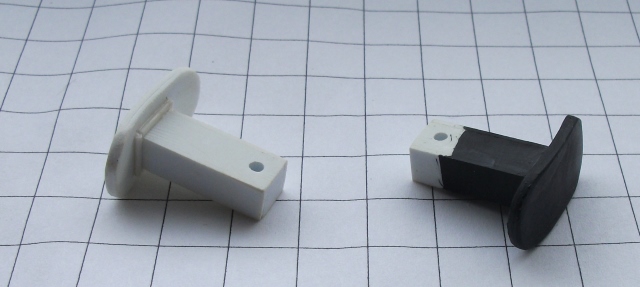

Accucraft chopper replacement
Post by FBGR » Sun May 20, 2012 10:41 am
Well I made replacement inserts in plasticard - vis
Coupler Inserts.jpg (90.77 KiB) Viewed 2786 times
These were my first attempt, which turned out to be too long, so the ones that were fitted were similar but shorter.
By making the shaft width a little narrower than the hole, they can swivel a bit side to side.
