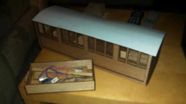

I cut some pieces today!
I ended up using standard 1/8" ply, which I bought a 3'6" square piece for $5. I went a bit thin in some parts, but I guess that just provides an incentive to assemble it before they have a chance to break! Still need to decide how I'm constructing the base and roof. Not sure if Plasticard is available here in Canada. I'm sure I can find something similar...
Also, the astute among you will realise that, only after printing the side panels did I figure out the "engrave" function on our laser cutter. Needless to say, had I realised earlier, I would have added more detailing to the outsides! For now it did a great job adding panelling detail to the dividers though.
Also need to decide if I'm painting it. The finish from the laser cutter is kind of appealing. I'm tempted just to clear varnish it, but I suspect it might be harder to add convincing doors in that case. Maybe just scribing and going over it with a thin black marker will do the job...
Fun times!

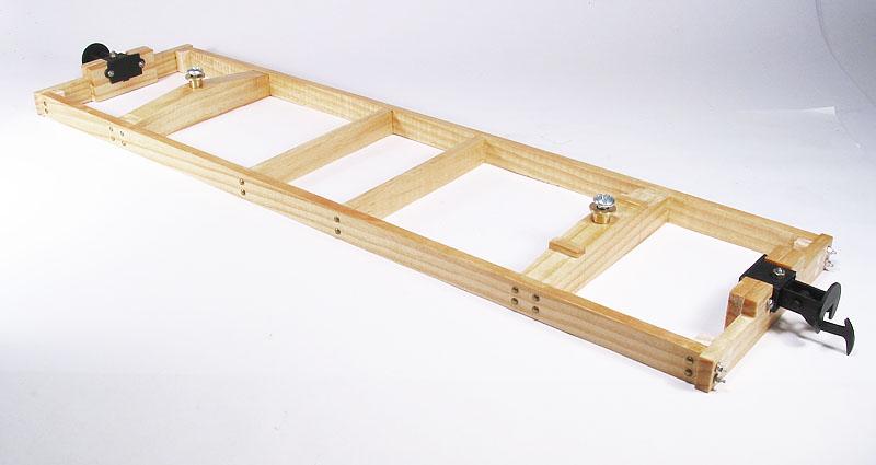

big-ted:73096 wrote: In the meantime, I'm eyeing up bogies so that I can figure out the floor thickness.
Some bogies come with mountings some don't. The bolster height varies brand to brand and even within a brand as well. It also depends on wheel size...
Probably best to decide on your bogies and wheels, get some, then make a mounting to suit. I use a block of wood shaped like a prototype bolster, but you can stack pieces of ply to form a suitable thickness block, or use ply as shims if the bogie supplier includes a mounting block.
You need to have a reasonable width bearing surface for one bogie (or small side support blocks) to keep it stable and have the other one a bit loose on a smaller block, so it can flop around. The carriage stays stable on the track that way, in much the same principle as a 3 leg stool.
Just a stack of washers on a bolt at each end would result in a carriage that shimmies down the track like an Egyptian belly dancer....
This photo of a work in progress shows how I mount bogies.
The screws are just short wood screws, but the mounting holes in the bogies were much larger than any screws I had in stock, so the brass sleeves were made to take up the slack. They also stop the screw being tightened too much.
The bogies I use have a flat top to the stretcher, so the closest bolster has two blocks to provide side support. This bogie can rock longitudinally to some extent, but not laterally. The rear bolster has a small support area allowing the rear bogie to rock in any direction, which will keep all wheels on the rails even on fairly rough track.

Post by big-ted » Wed Jul 25, 2012 4:50 pm
Thanks GTB, that picture helps a lot. I'd planned on doing something like that (allowing one bogie to rock in two planes, whilst the other can only rock in one) after reading about the design of the Swiftsixteen bogies. Just to be clear though, in your picture, the bushing passes through a clearance hole in your chosen bogies, and is what is used to fix the bogie to your stock? This would require the screw head to be accessible from below with the bogie in place, correct?

I decided to cut out pieces to make an open wagon also. I've made up a removable roof for the carriage and begun to put together an interior. To be honest, there's a lot of things I would do differently next time, particularly regarding the roof. Still, I embarked on this project as a learning exercise. I've still not pulled the trigger on wheels, mainly because I've not been able to find any uk-style bogies and axle boxes here in Vancouver. I'll have to order some I guess...
Anyway, my dilemma now is how to make detail parts for the open wagon. Dummy hinges, corner pieces etc. I had a go at making some from recycled tin plate, but this proved difficult to paint due to the coating, & it was hard to cut crisp, even lines on such small pieces. Likewise my attempt cutting bits from sheet metal was pretty poor.
