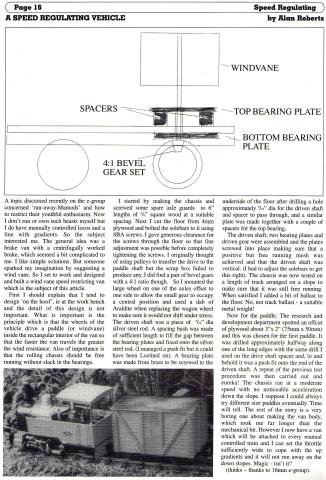

Interestingly I aquired several old copies of SMT recently one of which has an article related to this. SMT 95, February 2001, Page 16 ' A Speed Regulating Vehicle'. Basically this is a van with a bevel gear on one axle driving a shaft which goes vertically up through the floor of the van. On the top of the shaft is a paddle or windvane which provides wind resistance the faster the wagon goes thus acting as a governor. Drop me a pm or make contact via 5inchrail and i'll scan it during the next week and email it across.
Barry

I've finally managed to get to the scanner. It was hidden behind christmas. The implication from the attached article is that it worked ok for the builder.
I've sent a better quality image to those that requested it.
