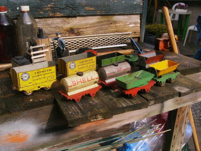

Whilst looking for cheap and interesting things to run on my 16mm line, I have collected a small group of Hornby and Lionel O gauge wagons & tankers and realised though small for 16mm (though I have small industrial locos) some would do for Gn15.
I like the mistreted and rusty (has a real feel) and have re wheeled some (though kept the originals in case I sell on) as the wheels do not like running through O gauge points.
Hornby seems to have two sizes (scales?) but either would do.

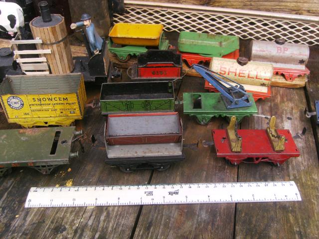

Photos enclosed (and I hope you can see the ruler)
Crackingjob
Note Coopercraft trucks for comparrison (yes I know they are blue..but thats why they were cheap 2nd hand!)

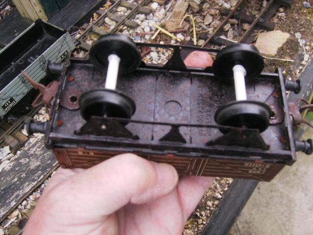

Rewheel method 1. Binnie wheels and plastic tube glued toether over the original axle..ideal as larger stock is a little heavier.
Method 2. Brandbright steel wheels...ideal for smaller stock that need weight

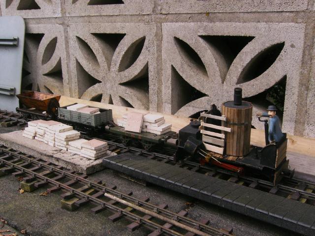

Earning revenue!

I am hoping to have a mining track running in/out under my raised track bed

Now to the point of this post.You can turn the flanges down on Hornby plastic wheels and put washers on axles to bring the wheels out to right back to back.That should fix the running problems.
Crackingjob
Post by Crackingjob » Mon May 09, 2011 8:01 am
I have a couple with plastic wheels that run ok...the majority are the tin plate so cannot be altered...however one log wagon came with small black wheels which are Binnie/Cambrian..so someone had ago already
