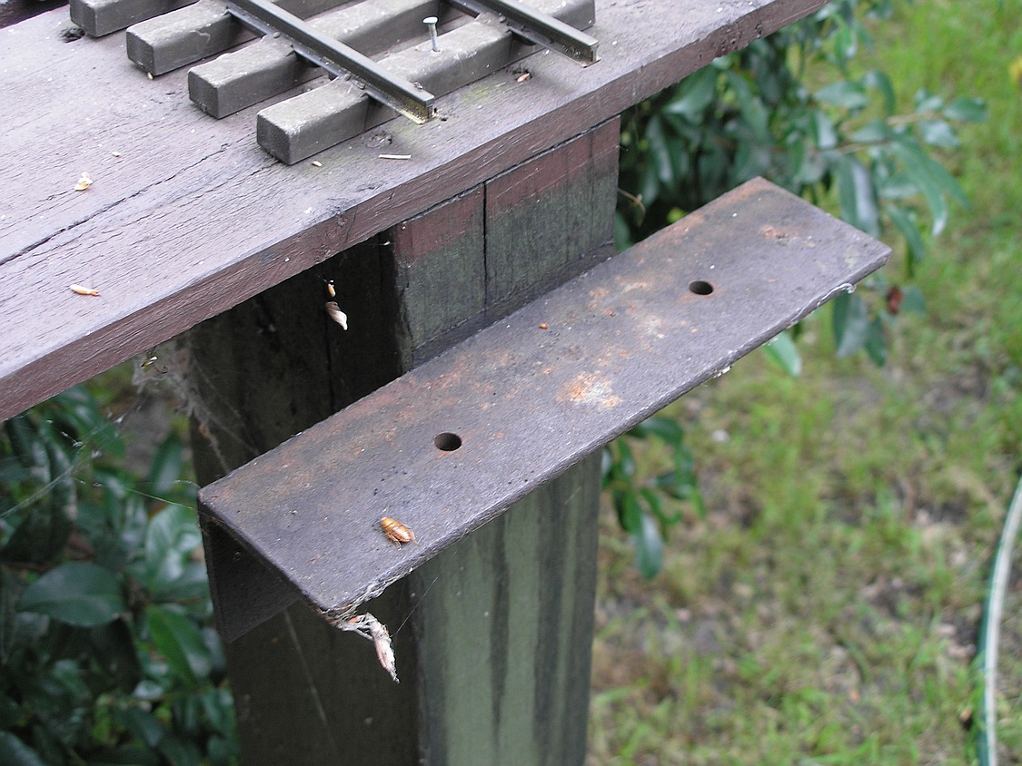

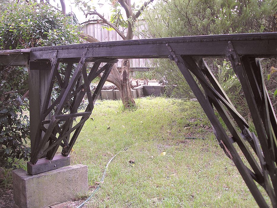

The bride over Warringine creek on my layout has been in situ since 2007, is timber constructed and is simply removed by sliding back 4 standard brass track joiners and lifting out. the positive lining up is achieved by the steel pins and holes in angles bolted to the post and bridge, as shown (excuse the cobwebs!) and has never failed to line up.
The plates at each end the bridge sits on.
The pins slightly tapered to assist engagement.
