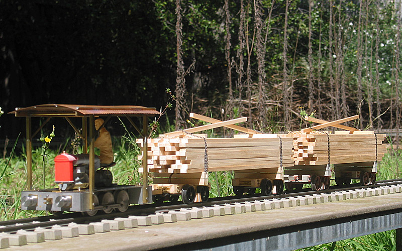

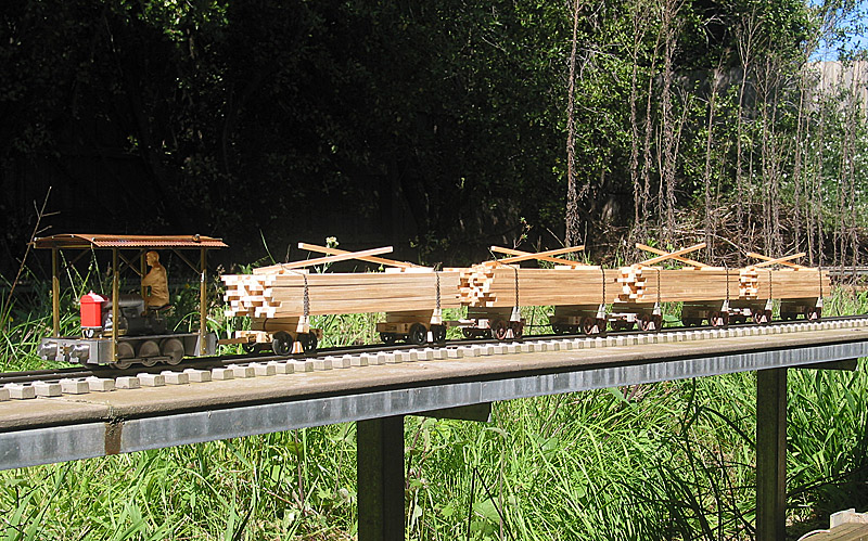

The long delay in building these two rail tractors was that suitable rtr miniature Fordson Model F tractors are unobtainable in 1:20.3 scale. The somewhat crude Ertl model and the expensive International Hobbies model are both made in 1:16 scale, which is far too large for a scale model Days rail tractor. That left scratch building and I was in no hurry to get into scratch building tractors.
Then at the last GSSU in 2025 opportunity knocked on the door. One of the commercial tables had a 3D printed 7/8" kit for a Days 0-4-0 rail tractor displayed. I was more interested in the 0-6-0 version, so I politely asked if it would be possible to get the tractor part of the kit printed off in 1:20.3 scale. The answer was yes and I ordered two.
The consequence was that work started on the model rail tractors, beginning with turning the wheels. No research needed, as that was done years ago and the search results were already in the files. The models are based on one of the Days rail tractors that ran on Russell's timber tram that interchanged with the VR at Gembrook and ran to timber mills out along the Black Snake Creek.

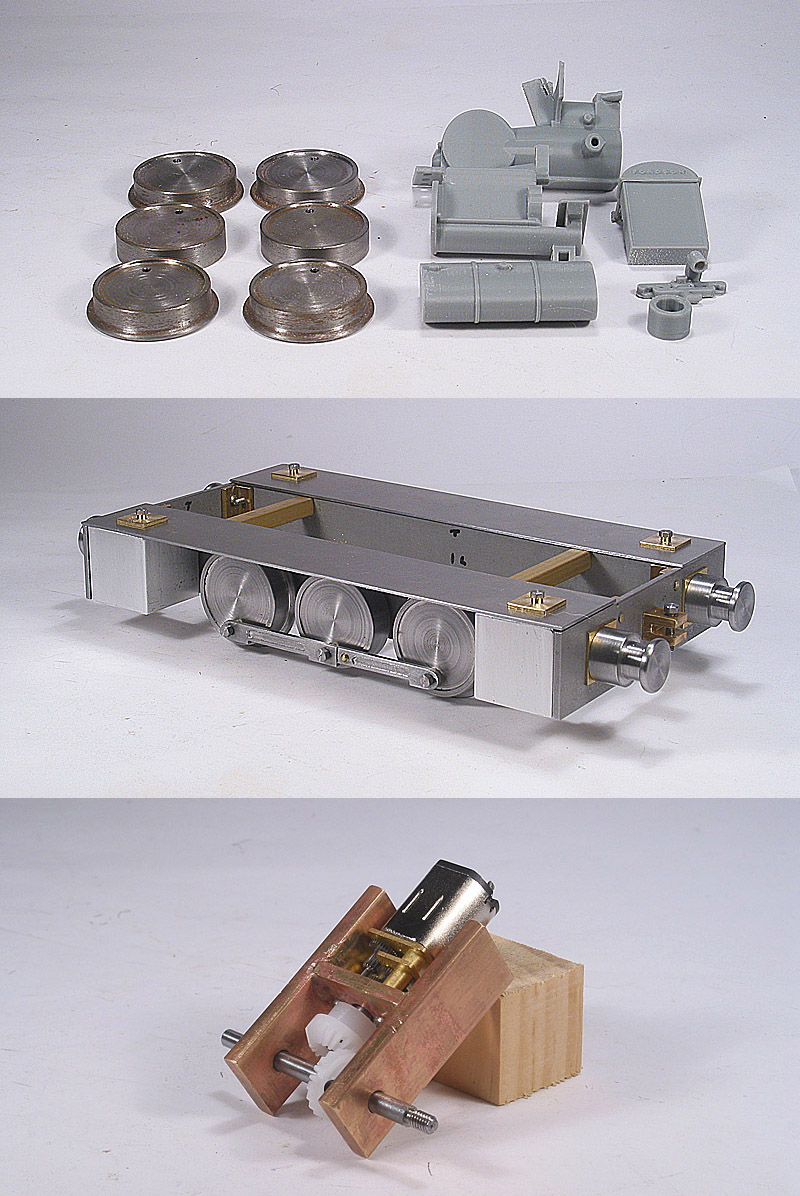

The first pic in the composite photo shows the turned wheels and 3D prints for one tractor. The kit I saw had a tractor printed in one piece but the supplier decided to convert to a multi-piece to make printing easier. Fine with me, it made detailing a lot easier as the build proceeded. The 3D prints are hollow, so don't add anything much in the way of weight to the model.
The second pic shows a chassis ready to be fitted with the motor/gearbox, The design being built with my usual preferred methods and is basically a simple small diesel chassis. Designed to be nice and heavy for hauling a scale load.
The third pic shows the assembled drive minus the covers, ready to be installed and wired.
The chassis of the models is built as heavily as was practical, to get a drawbar pull high enough to pull a scale load. The motor drive is more visible than I'd like and there was no space to also fit rechargeable battery cells, or hide the on/charge switch, the charging socket and the rx-esc. These were built into the timber load on a pair of log bogies.

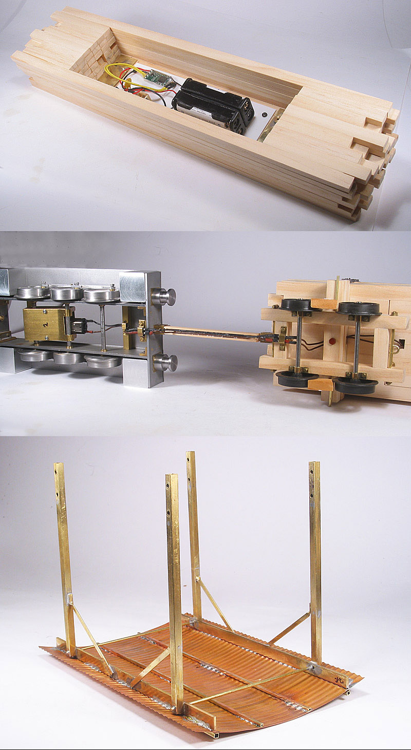

The first pic in the next composite photo shows the electrickery arrangements hidden away inside the load of timber. Shown from above, before the top layer of the load was added.
The second pic shows the timber pair coupled to a rail tractor. Visible is the gearbox fitted to the chassis and the wiring running in a groove under the drawbar, as well as the miniature plugs fitted so the electrical can be separated for maintenance.
The third pic shows a completed shelter assembly ready to be fitted. The framing is K&S brass tubing and the corrugated sheet is copper shim fed through the corrugator rolls I built using the rolls from a paper crimper. Fully annealed 0.25mm copper shim is much easier to form than 0.25mm brass shim. Standing on the bench on its own it looks like a small hay shed.......

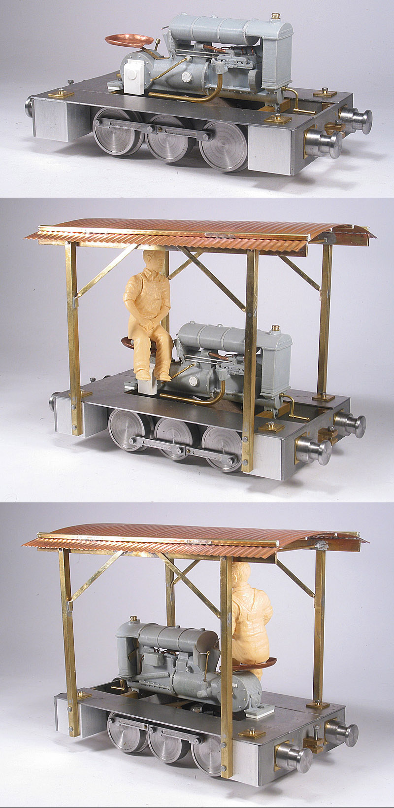

The first pic in the next composite photo shows a running chassis fitted with an assembled and detailed Fordson Model F print. The pressed steel seat typical of tractors was beaten to shape on a wooden former. Again copper shim was found to be much easier to form than brass shim.
Some of these rail tractors ran in this condition, not that the usual shelter did much except keep the sun off. There's an old photo showing one without a shelter, running on the timber tram at Tanjil Bren in winter. Some poor soul is huddled in a greatcoat driving the thing in snow up to the footplate.
The second and third pics show a completed model rail tractor with a driver figure temporarily fitted. Ready for the paint shop.
There seems to be no record of paint colours used on Days Fordson rail tractors when they were new. Preserved ones are in all the colours of the rainbow, so when the weather improves enough for painting I'll need to make an executive decision on the paint scheme.
The final weight of the completed model has come out at a 640g and the max. drawbar pull was measured at 150g during a bench test. So a single rail tractor should easily handle a scale load on the track.

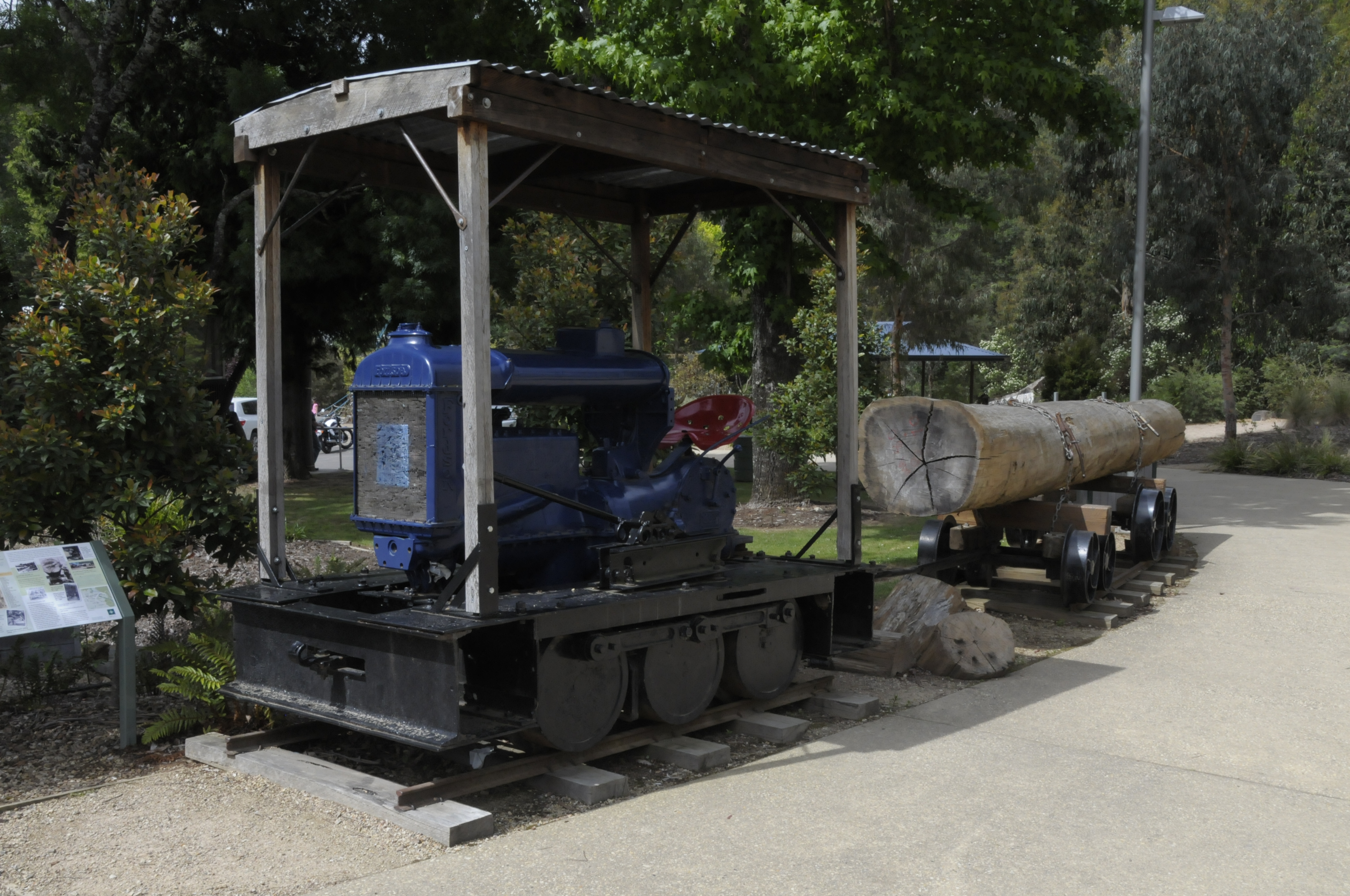

A Days Tractor has been on my list ever since I saw the Marysville one back in 2002. Very nice!
Timber Tram by Stuart, on Flickr

Spring has sprung hereabouts and with a lot of help from a friend, the mainline loop of my track has been dug out of the undergrowth. There is still a lot of work required, but with a few sunny days I've been able to test run the rail tractors.
The first photo shows one of the rail tractors pulling a prototype load of two pairs loaded with cut timber. Timber was measured in super feet at the time and measuring the loads they are about 6300 super feet, which would be about 12 tons. On a horse drawn line this would have required two teams of three horses pulling one 6 ton load per team. The model rail tractor managed this without much effort and maintained an average speed of 11 smph around the mainline.
The next photo shows the same tractor with a load of four pairs, which is well over the maximum prototype load shown in old photos. It could just manage this on flat straight track, but was struggling on curves and the slight grade approaching the bridge.
The final test load was two tractors with a load of four pairs. The battery pack and electronics are in the leading load and one tractor is through wired so they can double head. The two tractors had no problems handling this load, which would be about 24 tons in full size.
The models performed as designed and can handle a prototype load, at a prototype speed. Can't complain about that..........
The results demonstrate why locos need as much weight built in as possible, as drawbar pull is a function of the weight on drivers. The model rail tractors have the same motors, batteries and speed control as the model of the Harman loco., but both tractors together weigh less than half the weight of the Harman. Which is why the Harman can handle ten loaded timber pairs and the tractors together can only manage four loaded pairs.
Next stop, the paintshop and an appointment with a tin of grey paint.
