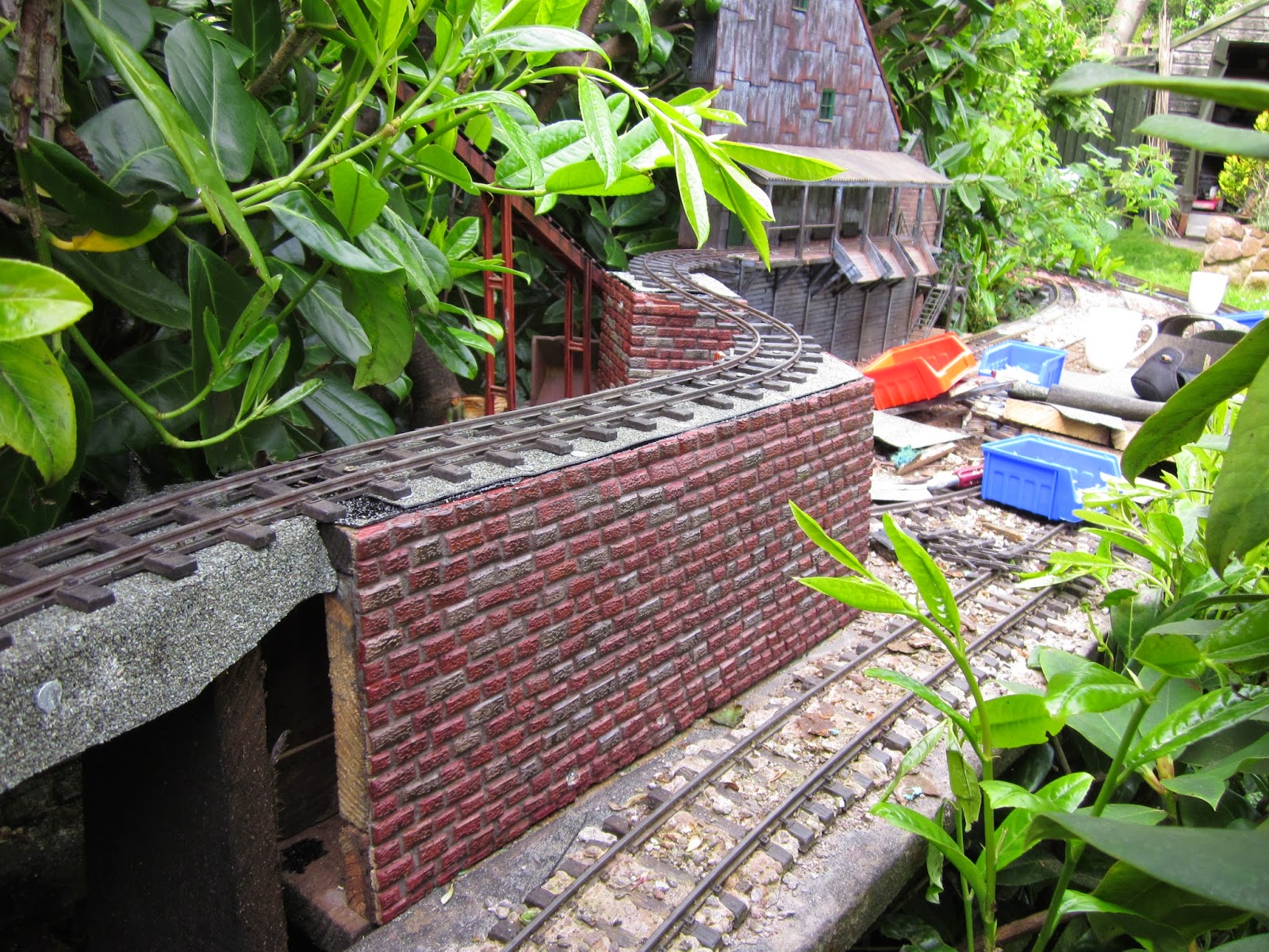

When I renewed the baseboard at Beeston Market, I also replaced the boards at the Copper Mine. For a while, I've been living with the original arrangement of the buildings at the Copper Mine ....
..... but I've never been happy with the way the 15" and later the 2' gauge feeder lines were configured.

So, I did a bit of head scratching and decided it would be easier if the feeder line actually came in at the other end of the buildings. This required some careful excisions with a circular saw and various handsaws to reorganise the layout of the buildings, .....
.... and an extension to the baseboard for the new feeder line.
I might even have a go at making some dual gauge track .....

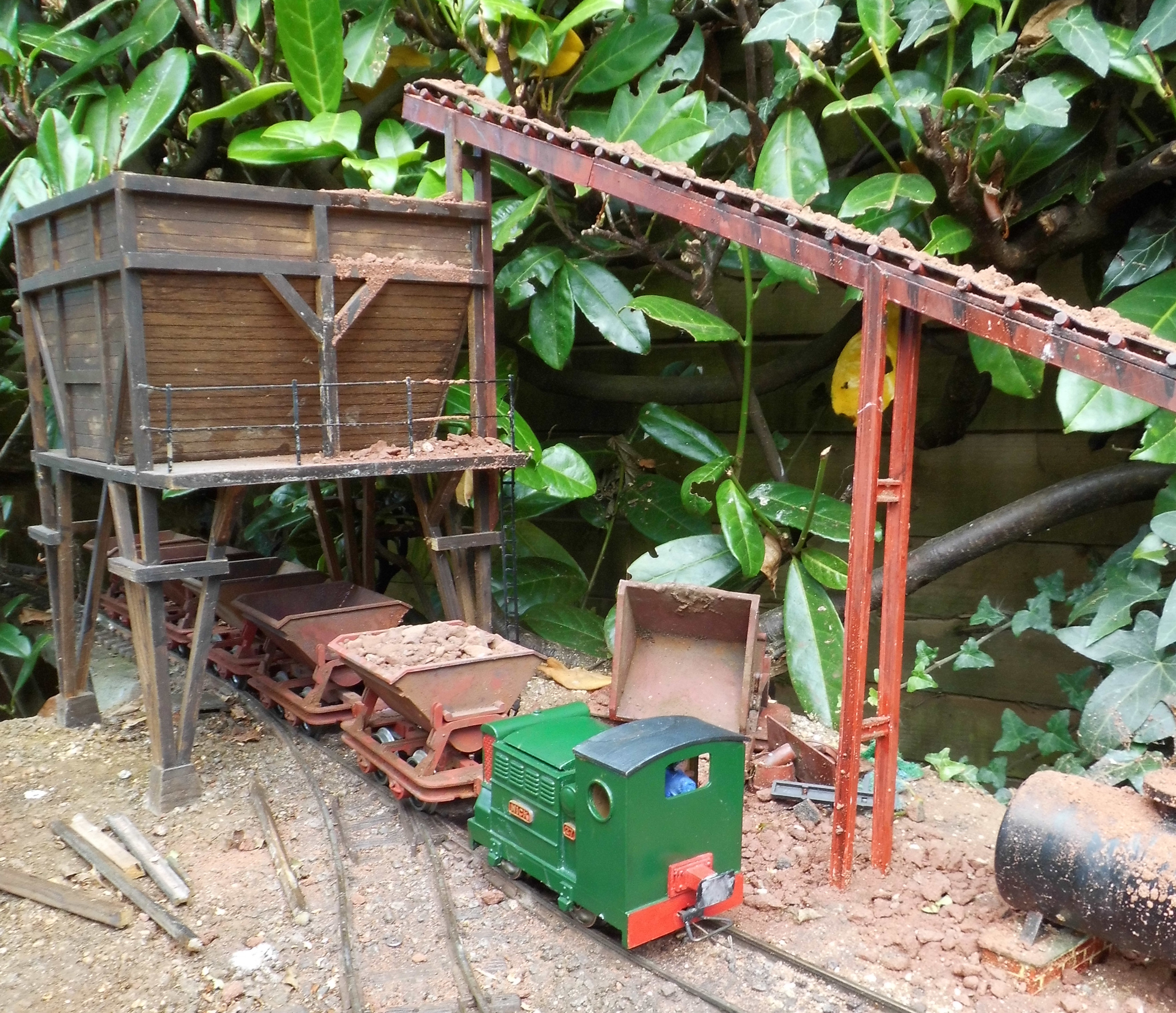

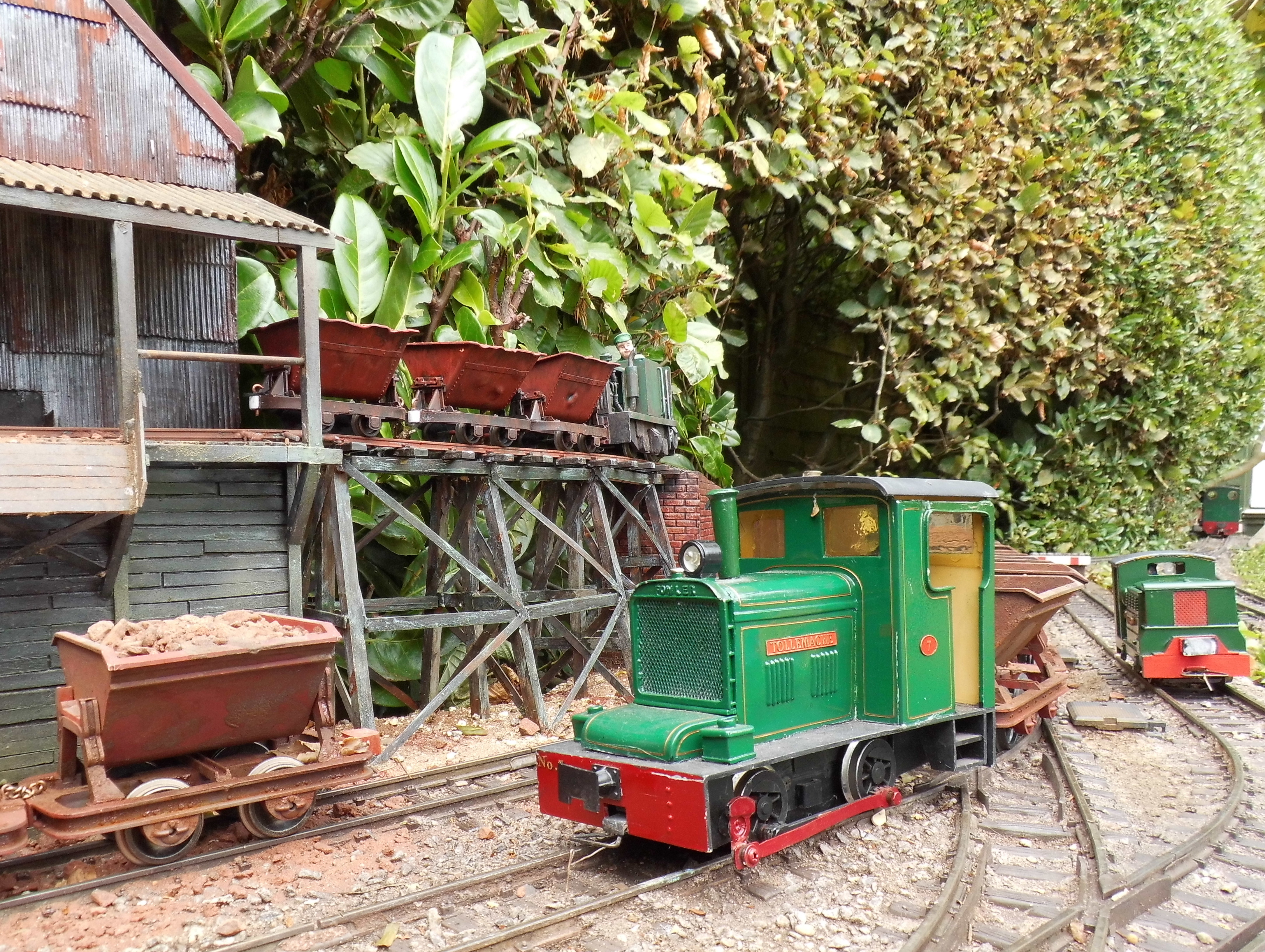

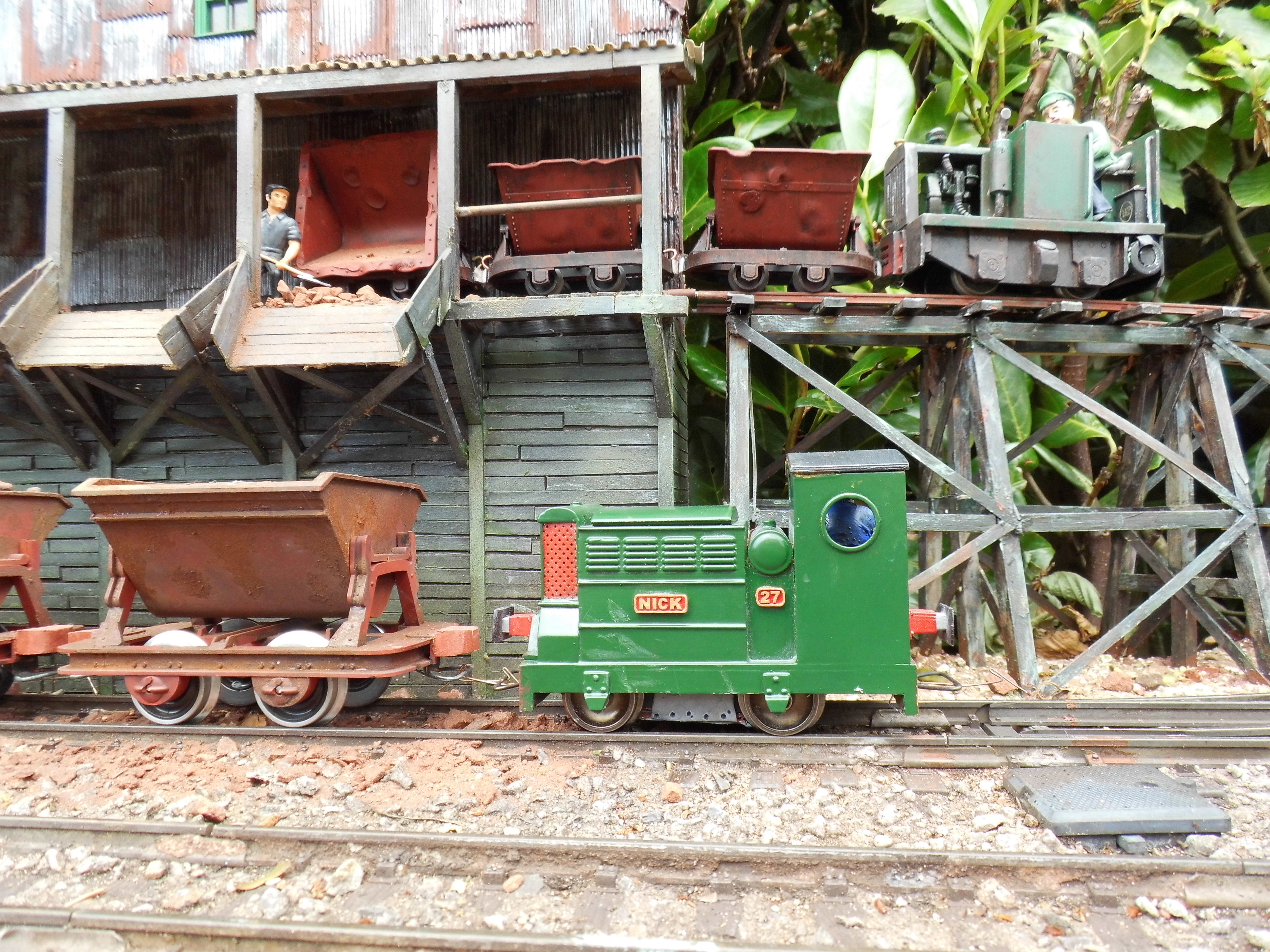

It's taken about three weeks, on and off, but I think I've very nearly finished revamping the Copper Mine.
Freelance (HGLW) 2' gauge loco propels three loaded skips up the incline from the mines to the crushing shed and loading chutes.
3' gauge Ruston 44/48HP (ish) shunts tipplers to be loaded with spoil from the mines
The Ruston loading more tipplers with crushed ore from the hopper.

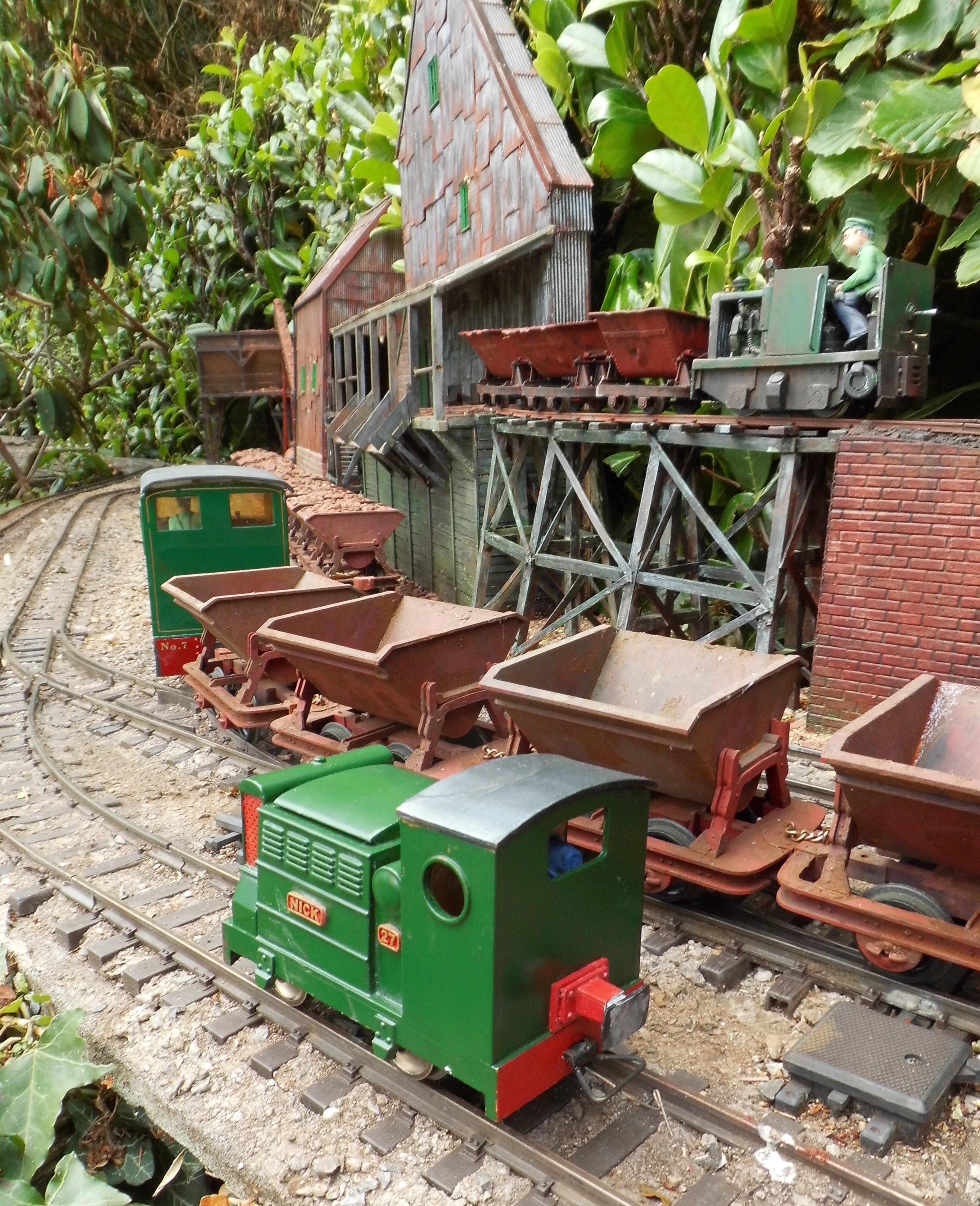

Fowler 0-4-0DM arrives with a train of empty tipplers to be exchanged for a train of now filled tipplers for transportation Up the line to Beeston Market.
Fortunately, the Copper Mine is under the shade of trees in the afternoons and so I've been able to continue working without getting scorched.

The Copper mine sure looks a hive of activity again Rik, nice job. I imagine you could spend an hour or so just shunting various rakes of wagons and tippers around.

I'd forgotten what a superb bit of modelling the copper mine buildings are Rik, and until I saw the 2nd picture of this last set, I don't think I had ever realised that the big building at the RH end is actually low relief! Fantastic job all round and I'm sure the revised trackwork will give you hours of pleasure.

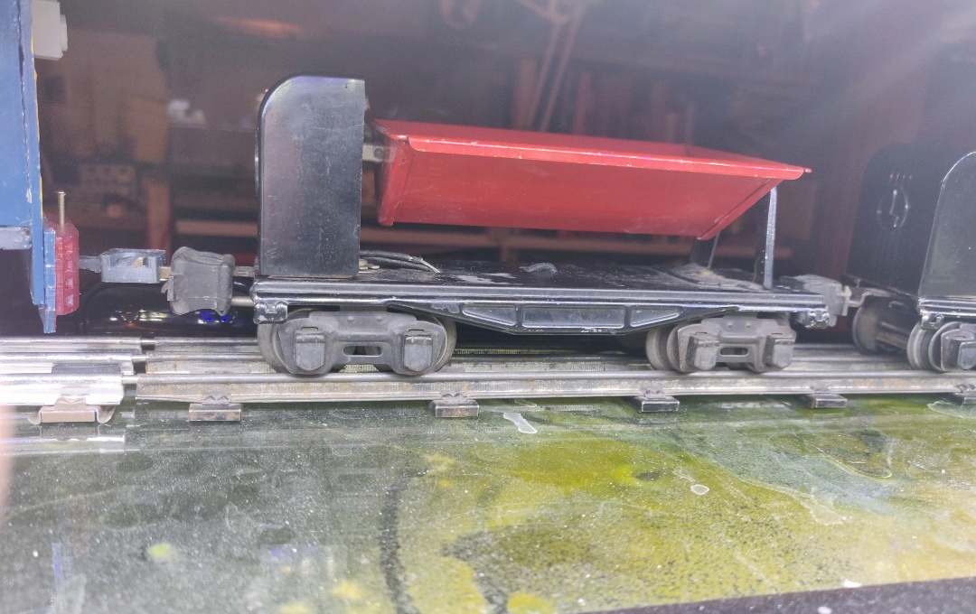

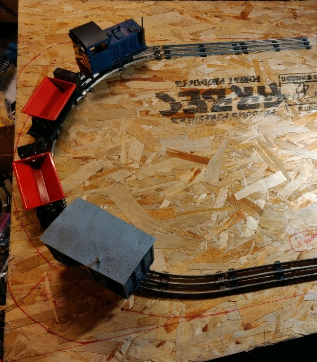

I collect old Lionel and I think I recognize that tipping log car! I don't have one (yet) but I do have some older tinplate tipping coal hoppers. Personally I think they look just as much at home in 15mm narrow gauge as they do in an O-gauge consist:
I'm in the process of relaying the track in my garden and considering adding a powered unloading section for these. (The rest will still be dead rail.)

The powered coal tipper looks like something you might see running around a metal smelter, or a steelworks. What's the power source under the black cover, a solenoid, or a motor and gears?

I figured it was probably a browser being helpful dropping all that useless "clutter". ;) I usually use Firefox but I've noticed Chrome doing that stuff too lately.
Under the black cover it's just a big solenoid and a couple of gears, and the trucks have offset pickup shoes to pick up power from fourth and fifth rails between the usual three in a special section of track. Both of these came to me with crumbling insulation and sparking when run, I've rewired one of them but haven't gotten around to redoing the other one. Here's the repaired car in action:
