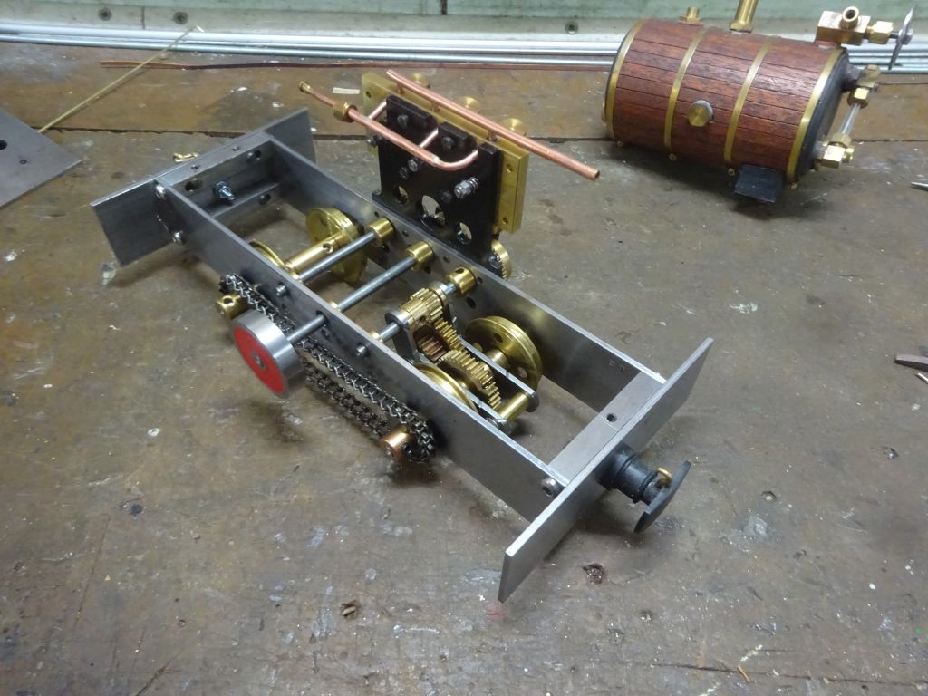

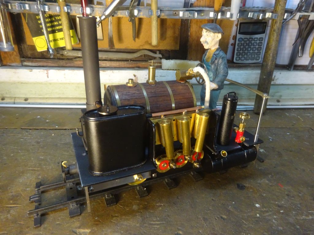

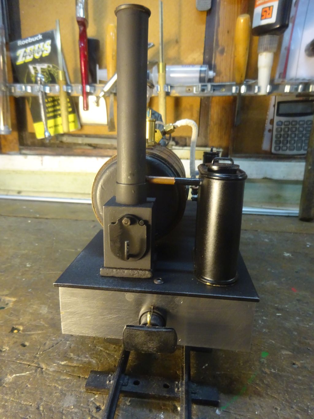

Hi,
I am coming towards the end of constructing a steam locomotive that uses previously built prototype parts that were made for other projects and some Meccano parts.
Take care Tony.
Take care Tony.

Tony
been watching your build on FB etc, I am a bit confused about what each engine is driving. The first is the main drive shaft driving the gearbox to the front drive wheels, and a chain drive turns the rear wheels, the second drives the flywheel, is this correct? But what does the third engine drive? I can't tell from the various photos. just curious, thanks

Re: Locomotive nearly finished
Hi,
The three single acting engines are set at 120 degrees to each so that the engine is self starting; their fly cranks are gear wheels that couple the engines together. The engine was a prototype marine engine which could drive via its outer engines two propeller shafts, the flywheel being between them. The engine had been 'under the bench' for years and I thought I would do something with it
Take care Tony.
Take care Tony.
Hi Tony,
a fascinating loco. with the offset boiler is that a crackShay?
Hi,
All ready made; only Cracker with a reverse.
Take care Tony.
Take care Tony.
Never seen a 3-cylinder loco in this scale that wasn't a Shay. Looks great.
I doubt you'll ever run out of unique loco ideas, Tony.
