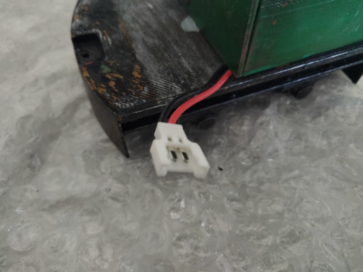

Can somebody confirm is this a JST connector? I am trying to identify a suitable battery for this small loco.

It doesn't look like a standard JST connector to me. I think it's a Molex - possibly MX2.0mm 51006 MOLEX Male 2-Pin

Thanks! Looks like you are right, seems to be a Molex one. This is connected to a Loco Remote modul and I found that the manufacturer recommends a Syma X5C battery which indeed is with a Molex counterpart :thumbup:
