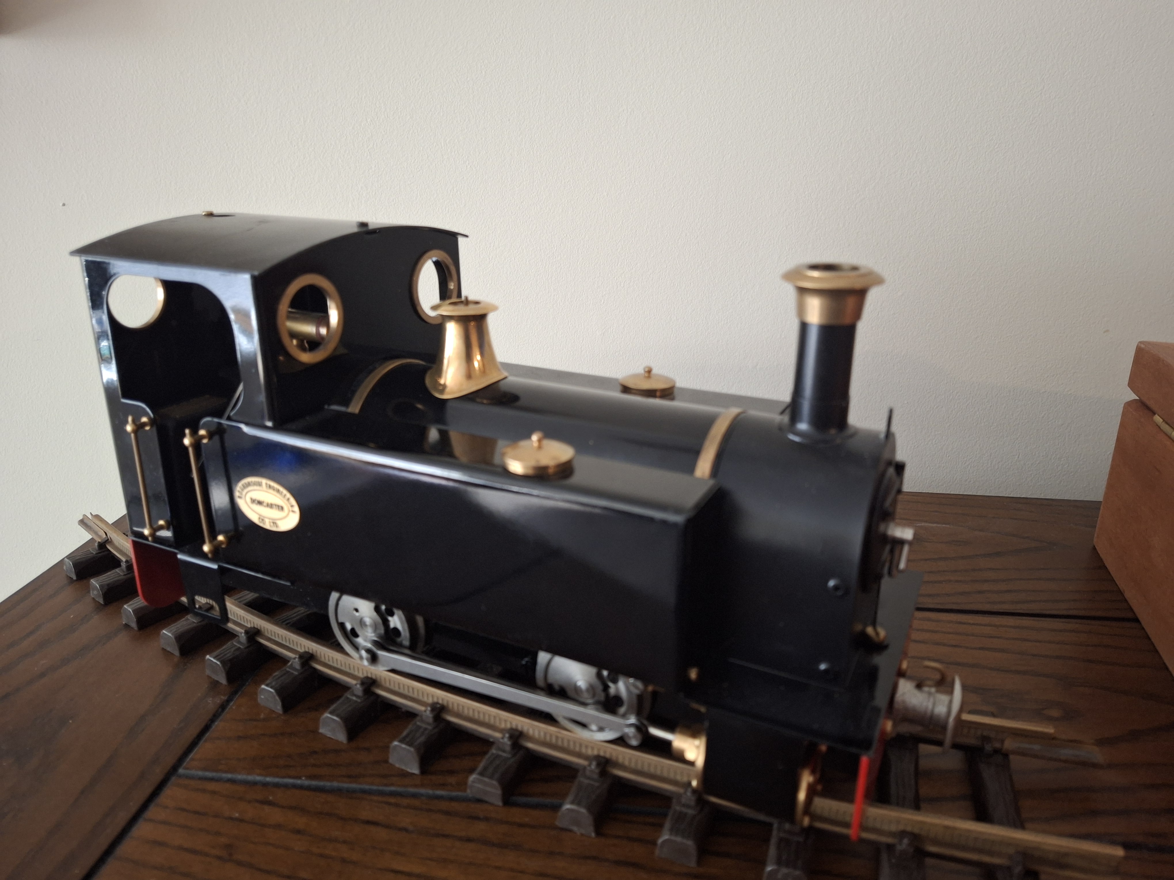

A few years ago I bought a millie with a full cab which has been running fantastically. At the end of last spring, I a bit foolishly tried running it ona friends railway with a bit of a grade, and sadly it took a short tumble. Thankfully besides a few light scratches to the roof it was no worse for the wear, but this has gotten me to reassess installing rc.
My question is where to stick the batteries/reciever. It appears I have two options, neither perfect. Ive seen some people stick them on the roof, but without a dedicated compartment that makes me a bit nervous. I dont know if its a rational concern, but I worry that if the batteries fall and come into contact with the boiler, that could result in significant damage/hazard.
Other option would be to have a dedicated car behind it. To my eyes a tender doesnt quite look right, given the stock back wall. I do have an accucraft van that could serve that function.
Just wanted to hear other people's thoughts/experiences.

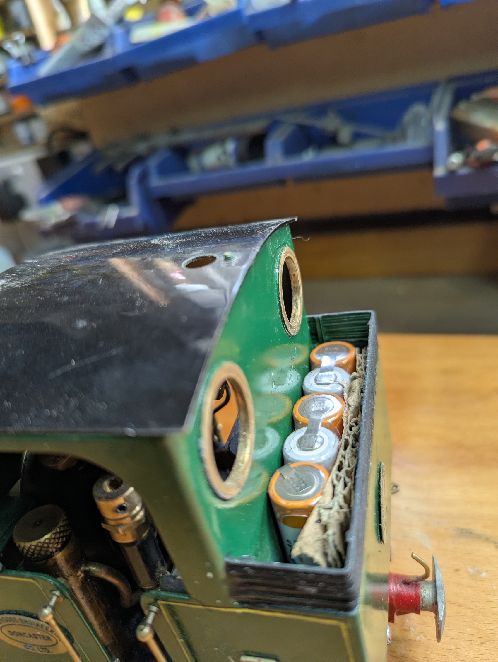

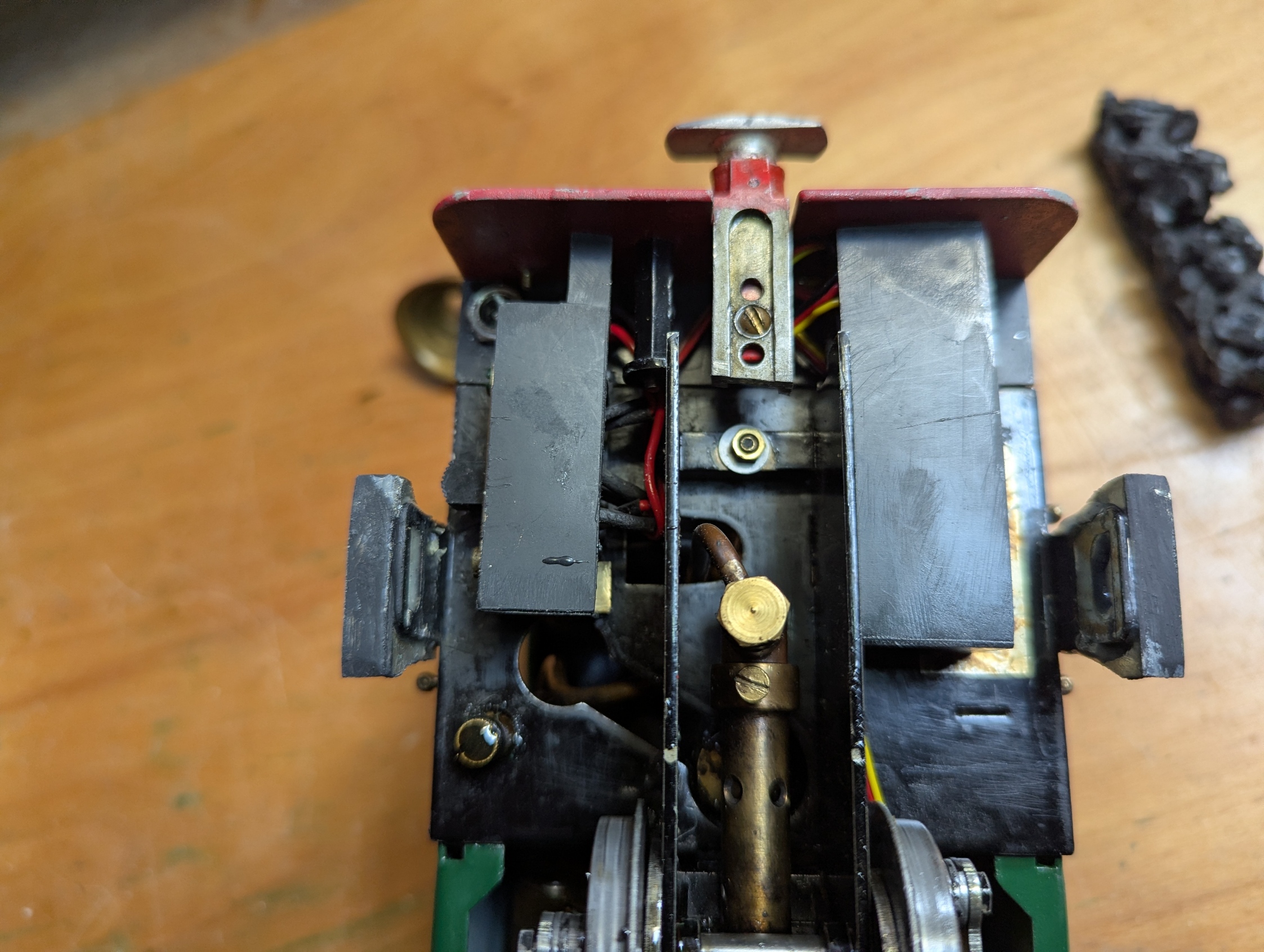

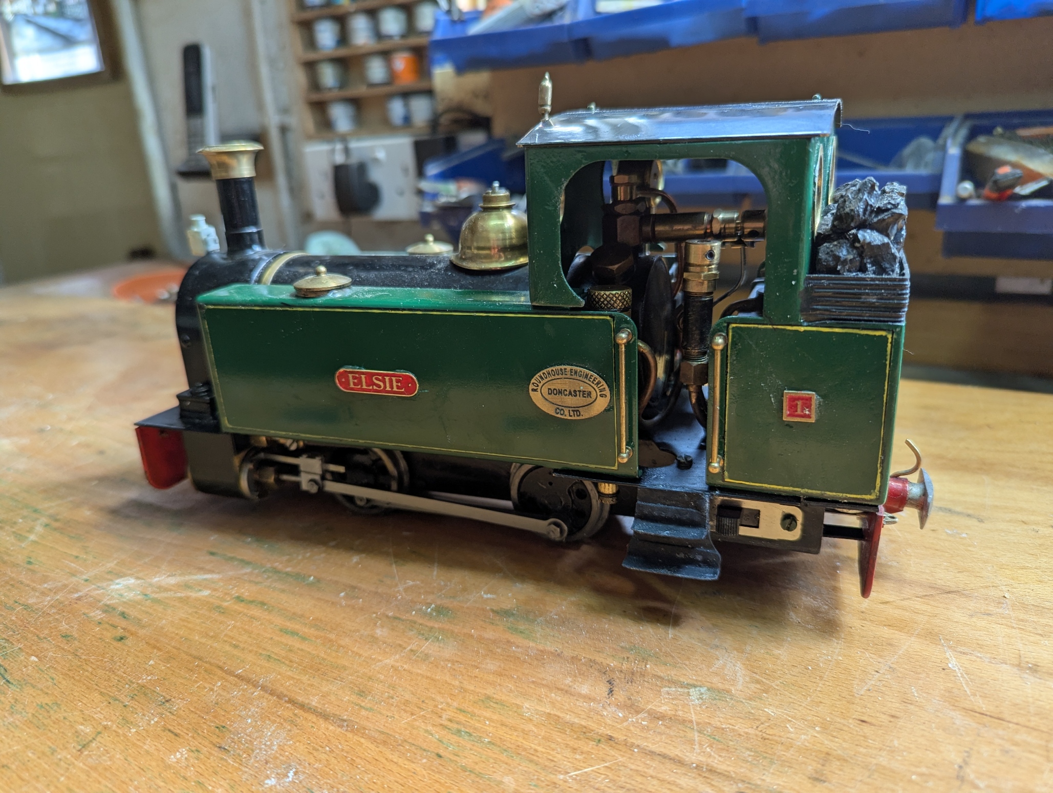

This is my Millie. It was bought second hand and came with a cab. The loco was manually operated when I got it but I have extended the cab to form a bunker where I have located the NiMH battery pack from Strikalite. The servo controlling the regulator is in the conventional Roundhouse location . The receiver and switchgear are in simple Plasticard "boxes" under each side of the extended rear. I hope the attached photos make everything clear.
Bryan

Post by ge_rik » Tue Apr 21, 2026 8:12 am
Clever modification. Looks very in keeping with the original loco. In fact, if you hadn't pointed it out, I'd have assumed it was part of the original design.
