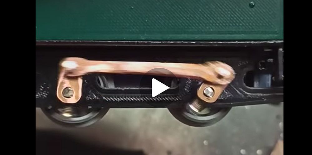

Dear all,
I am building à thornas loco powered with batteries. I modified the design to use Rick's motor support.
viewtopic.php?t=15019
Unfortunately, my link rods system between the 2 axels don't work as expected, the slave axle doesn't turn as you can see here:
Could someone help me to solve that
Thanks

I don't think the rods should be on the diagonal I think that they should be straight between the wheels.
Re: Link rods issue
Posted: Sat Mar 21, 2026 9:57 pm
I think Graeme is exactly right. Its difficult to be sure at that speed, but I think the quartering is out. If you drop the rod off one wheel, turn that wheel so that the rod goes back on the crank pin with it being horizontal, you should find the other side is now correct. If you then power it up and it goes back to oscillating, then that tells you that either the crank pin holes are probably too big or that the wheels are not firmly fixed to the axles at the correct quartering positions.
Re: Link rods issue
Posted: Sun Mar 22, 2026 2:15 am
by LNR
If you freeze the video at 1second, you will notice that the left hand crank is almost at top dead centre while the right hand one is about 1 o'clock indicating that your connecting rod centre to centre is too long. Rod centre to centre should be IDENTICAL to axle centre to centre.

My rods are straight but go diagonal immediately after the first turn.
I will control there length better. I put a rivet between the crank and the rod. Should this rivet be loose or tight?

Sam95 wrote: Sun Mar 22, 2026 6:55 am I will control there length better.
Sam, trying to help here but it is hard to explain.
Are you able to undo the rod from the "slave" axle crank pin? (presuming the one on the right!)
Now if you set the left hand crank to 3 o'clock and the right hand one the same, then offer the coupling rod up to where the right hand crank pin is, you will see that it is too long.
Before you can even setup the quartering the rods on both sides must be capable of turning the full circle of the cranks.

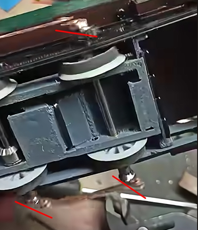

Further checking and freeze framing of your video Sam, when you turn the engine upside down while running I think I'm seeing that you have the cranks set at 180 degs out of phase, and not 90 degs as they should be. I could be wrong it's hard to pick up but I think that's what I'm seeing.

LNR wrote: Mon Mar 23, 2026 2:19 am
I agree with Grant, they do look to be at 180deg - these red lines are as close as I can get to showing the angles on both sides.

Drewzero1 : indeed I used your files and also philipy files of its modified design of your small loco. At the begining I thought that the problem was from the 3d printed rods not stiff enough. So I tried to make them with copper.
My axle lenght is 52mm.
LNR : indeed my cranks are set at 180deg..... So I must set them to 90° I was not aware of that..
Re: Link rods issue

Sam95 wrote: Mon Mar 23, 2026 8:45 am So I must set them to 90°
Sam,
Right hand side leads traditionally, so LH side at 12 o'clock, RH side 90 Degs. ahead at 3 0'clock.

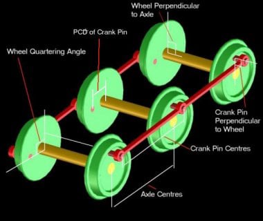

by Durley
This diagram might be helpful to explain quartering, this is an 6 coupled wheel arrangement but the same principles apply to four coupled:
Image borrowed from here: http://www.steves-workshop.co.uk
