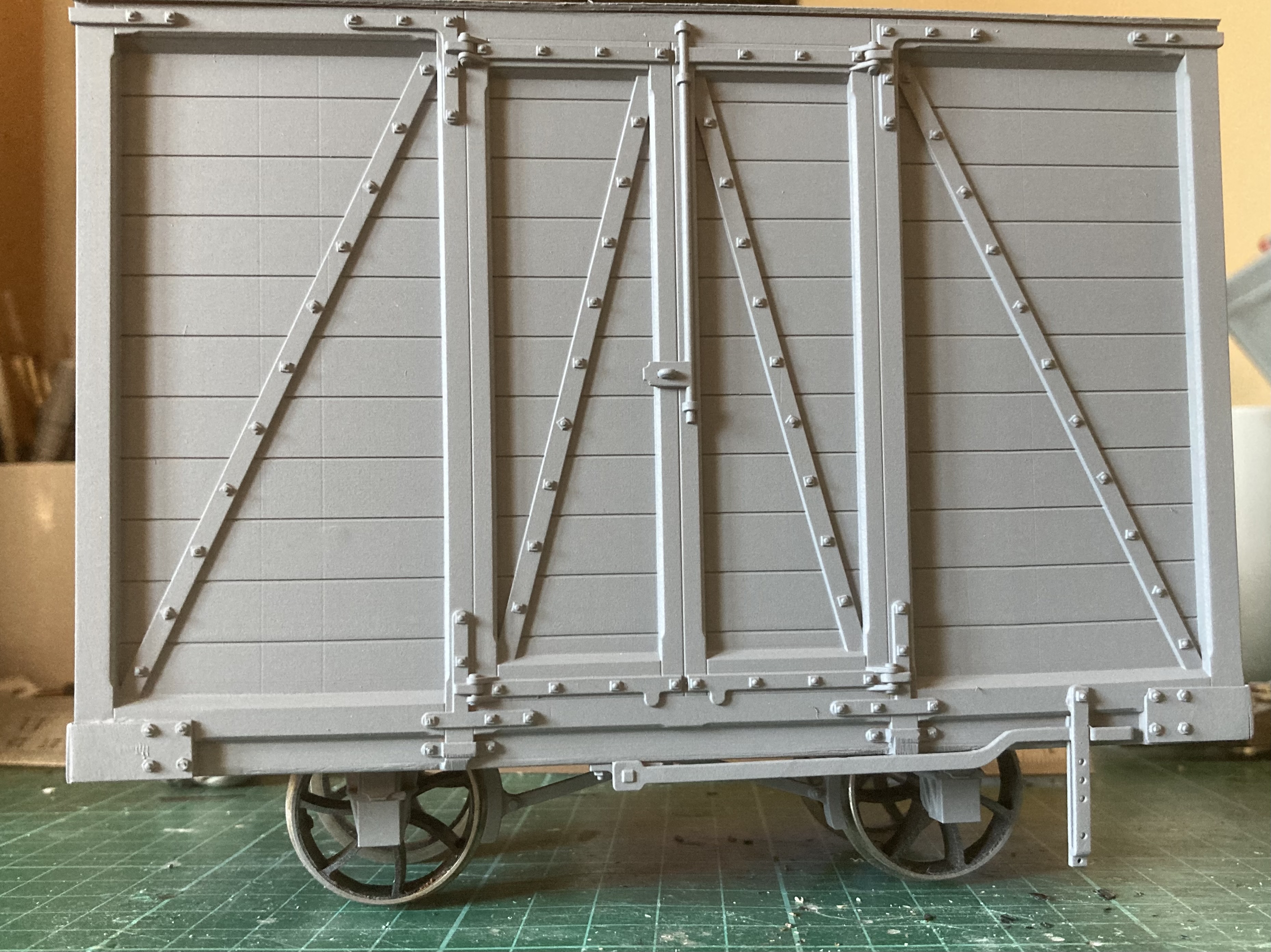

Hello All
My latest project has been this GVT covered goods wagon at 16mm/ft. Whilst my railway is 45mm gauge, I incorporated the ability to build the wagon for either 32 or 45mm gauge so I could share stock with my father who models at 32mm gauge.
The photos of the finished wagon (painted in undercoat) are of a 32mm gauge version using Slaters wheelsets, who supply the correct 29mm (scale 22” diameter) 7 curly spoke wheels. Binnie wheels also are the correct pattern and is what I will use for my 45mm gauge version, but are a little less refined in their appearance.
The body is 3d printed to my own design in one piece, with additional details (brakegear, axle boxes, central longitudinals, roof supports and corner plates) printed separately. The floor is 3mm thick Perspex and the roof is 2 sheets of 0.8mm ply laminated together.
I’ve milled two aluminium angle solebars/bearing holders which provided the structural mount for the wheel bearings. These aluminium pieces are screwed to the floor through slotted holes, allowing their positions to be adjusted for either 32 or 45mm wheelsets and also allowing the wheel side play to be fine tuned. The brakegear is mounted on a couple of M2 screws that are tapped into the aluminium side piece and held in place with nuts on either side, allowing the brakegear position to be altered to suit whatever wheels are fitted.
I’m happy to make the 3d print files available if anyone wants them but do note it’s been designed specifically for a resin (SLA) printer. I don’t have a filament printer so I’ve no idea if it would print on one of those. It needs a print bed approx 200mm x 100mm minimum to print the body at 16mm/ft scale. I have a Creality Halot Mage printer, but any resin printer with a 10” or bigger screen should be suitable.
I’ll update this thread to show the build steps on a 45mm gauge version that I am putting together now (not that there is much to it!).

Thanks for the kind comments.
The latch is all part of the body as you can see in the photo. Sorry about the colour, I’m using up my stock of flesh coloured resin!
I have already had a request for the files, so will make them available in the next few days on the 3D print area of the forum. If anyone fancies giving it a go in filament, I’d be interested to see the results.

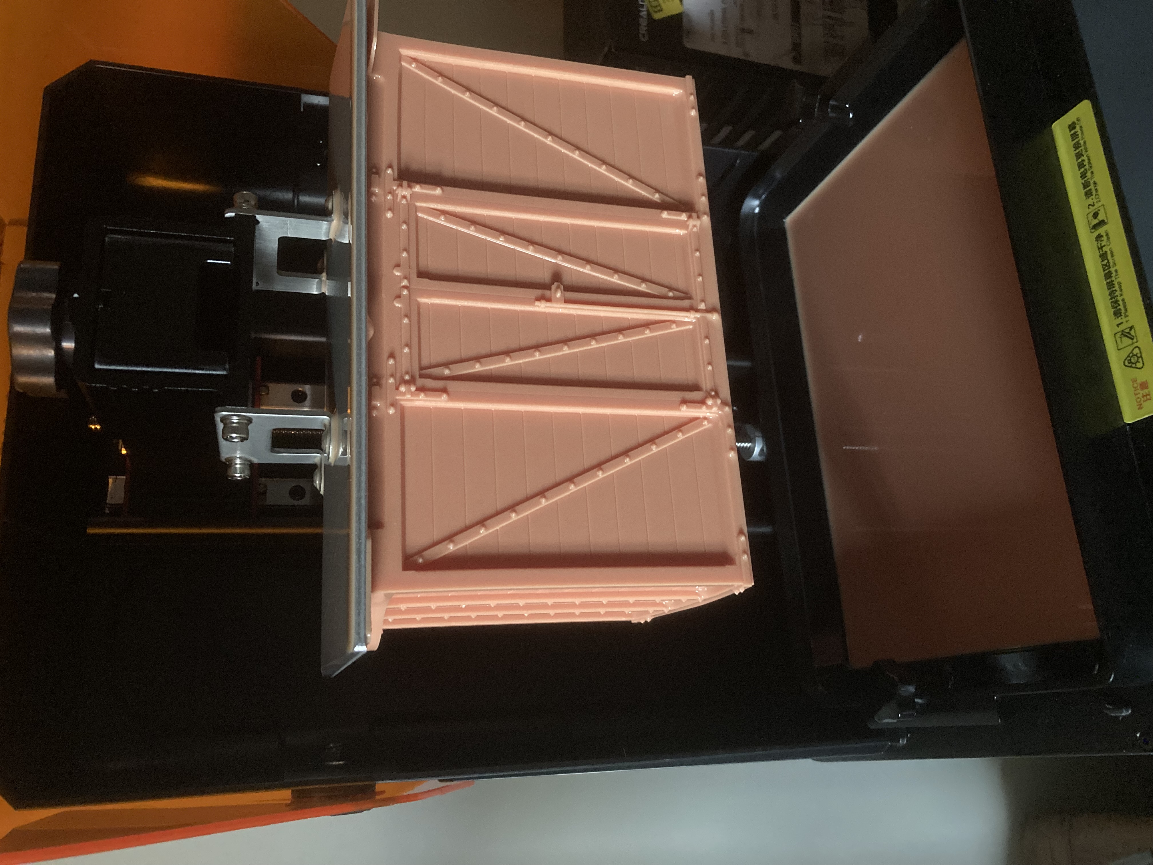

I’ve gone on a slight deviation this weekend…
The Glyn Valley Tramway ran on somewhat unusual 2 foot 4 and a half inch gauge track (724mm) meaning that at 16mm/ft, 32mm gauge (scale 2 foot) is too narrow and 45mm (scale 2 foot 9 and three quarter inch) is too wide. My railway is 45mm gauge, which approximates to the GVT’s gauge at 19mm/ft or 1/16 scale (45mm x 16 = 720mm).
Apart from one odd-ball open carriage, all of the GVT’s rolling stock was under 12 foot long. 12 foot at 19mm/ft is 228mm which coincidently is the length of the print bed of my 3D printer. The two covered vans were actually longer than the other passenger carriages at 11 foot 10 and a half inch.
I could therefore design and 3D print any of the GVT rolling stock and have it running on correctly scaled rails, if I could successfully print something that large, which I had never tried before.
So I took a bravery pill, scaled up the van body by 118.75% (19/16) and set the printer off. 16 hours and 600ml of resin later, here’s the result: And a comparison against the 16mm/ft version: Wheels will be a bit of a compromise but the Slaters 7/8th scale range includes a 1'6" 6 Curly Spoke Wagon Wheel (Festiniog) wheel that works out at about the correct diameter, although is one spoke short to be prototypically accurate and has a much thicker tyre, but I can live with that.

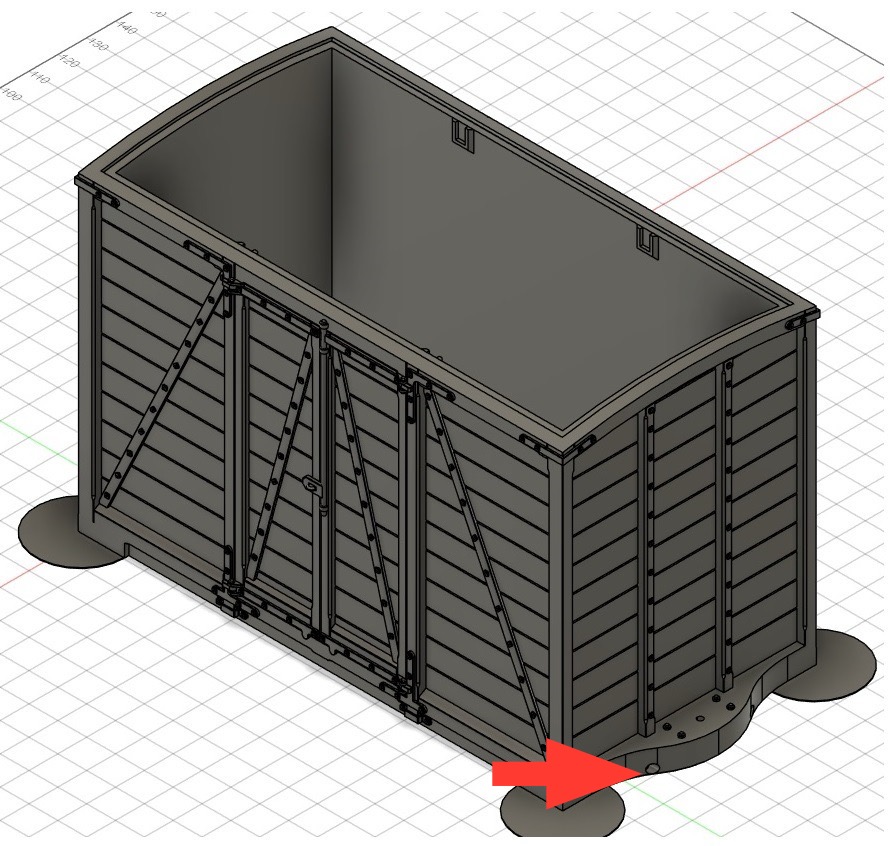

Hi Philip, yes I print directly from the bed of my Creality Halot Mage and have incorporated some features in the design to deal with the problems you correctly identify. Firstly there are vent channels in the headstock that allow resin to flow out as the build plate moves down into the vat and then relieves the suction as the plate moves up. 4 channels of about 3mm diameter appear to be sufficient for the 16mm/ft version. The channels are later covered over by a separate black plastic strip that represents the buffing plate, so are not visible unless you look at the underside of the model. Using black plasticard for the buffing plate has the advantage that were the paint to rub through, it would reveal black rather than the rather garish flesh coloured resin I have used!philipy wrote: Mon Feb 10, 2025 6:07 am
Having said all that, it appears from your photos that you are printing the sidewall 'box' directly on the plate? If so, (a) how do you avoid the suction effects as it progresses down the box, and (b) how do you deal with the 'elephants foot' effect? Those have always been a problem for me and the only way I've found round them has been to stand the print off from the plate on supports, which then makes getting a clean bottom edge a bit of a 'mare - and adds to the print time!
To minimise the elephant foot effect, I have chamfered the bottom edge of the curb rail and headstock with a 0.5mm 45 degree chamfer. As I use 10 bottom layers with a layer height of 0.05mm, the elephant foot effect mostly just fills back in the chamfer, leaving very little material to sand back.
To ensure the model remains adhered to the build plate, I have added ‘ears’ to the corner of the model. These are just circular features 0.25mm high that are easily removed after curing by scoring with a scalpel and snapping. Without these ears, I do find the corners of the model can lift during printing leading to the bottom developing a slight curve. In addition there is a false floor inside, again just 0.25mm thick, that is removed after curing in the same way as the ears. This gives a huge bottom layer area (most of the build plate in fact) that is significantly greater than the area of subsequent layers, so ensures the model stays firmly stuck to the plate during printing.
I tidy up the print to remove any remaining elephants foot and remnants of the ears and false floor with a Perma-Grit tungsten carbide file. This chomps through the resin in quick time (used under a running tap to minimise dust), finishing with a finer sanding stick.
To avoid losing any detail in the clean up process, I have made some features low down on the body as separate pieces, to be glued on after the clean up. This explains the separate plates on the corners (representing the side extensions of the buffer plate) and missing bottom to the door posts, which I add back with printed parts and a strip of plasticard respectively. This makes clean up very straightforward as I am not trying the file around fine details.
You can see the vent channels in the headstock (arrowed) and ears in this screen grab from Fusion 360

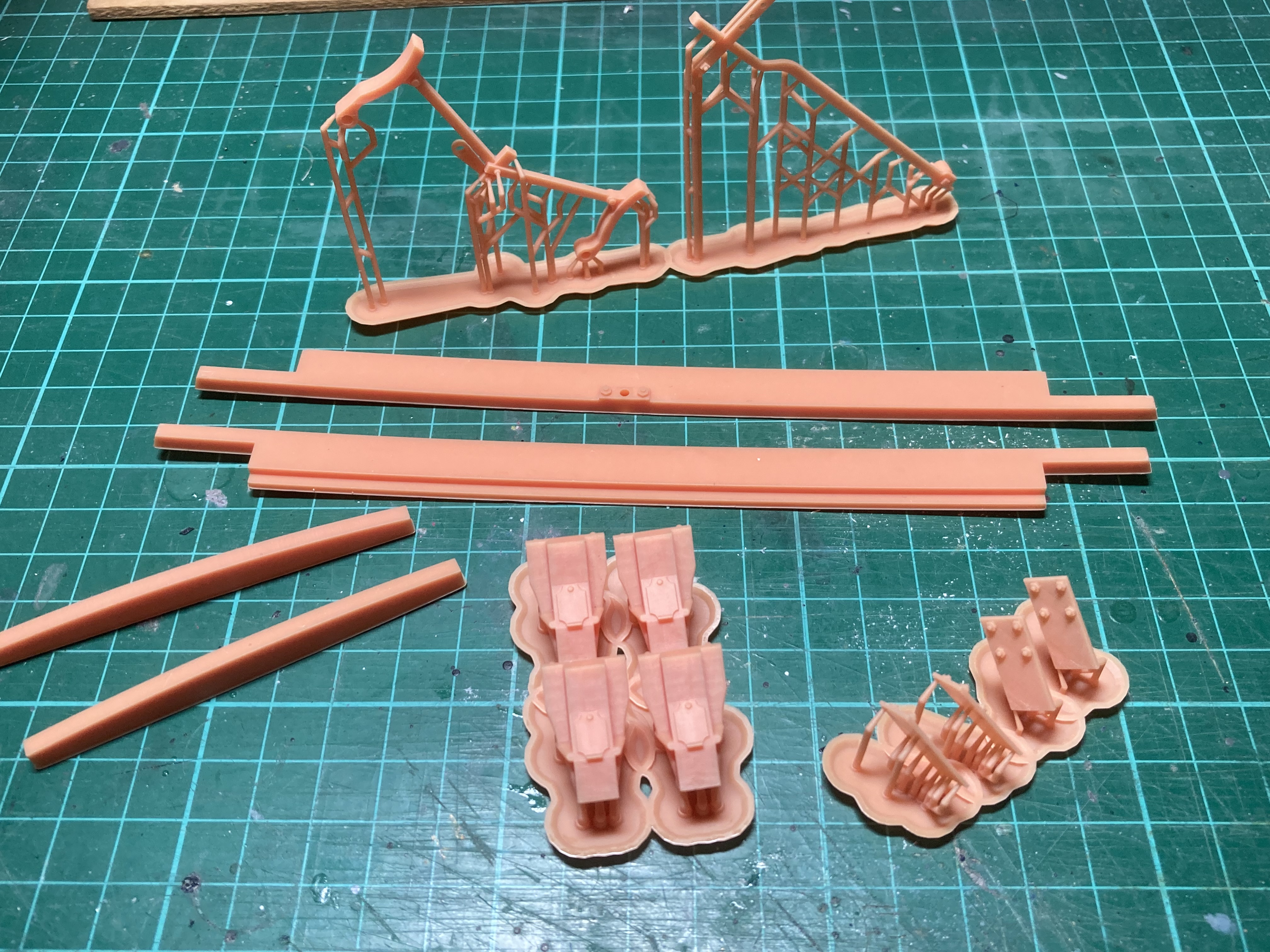

I’m putting together a 45mm gauge one now so will post up the build steps as I progress.
Firstly, here’s all the parts printed off. The longitudinals and roof supports were printed flat on the build plate, other parts supported as shown using manual supports in the slicer software.
