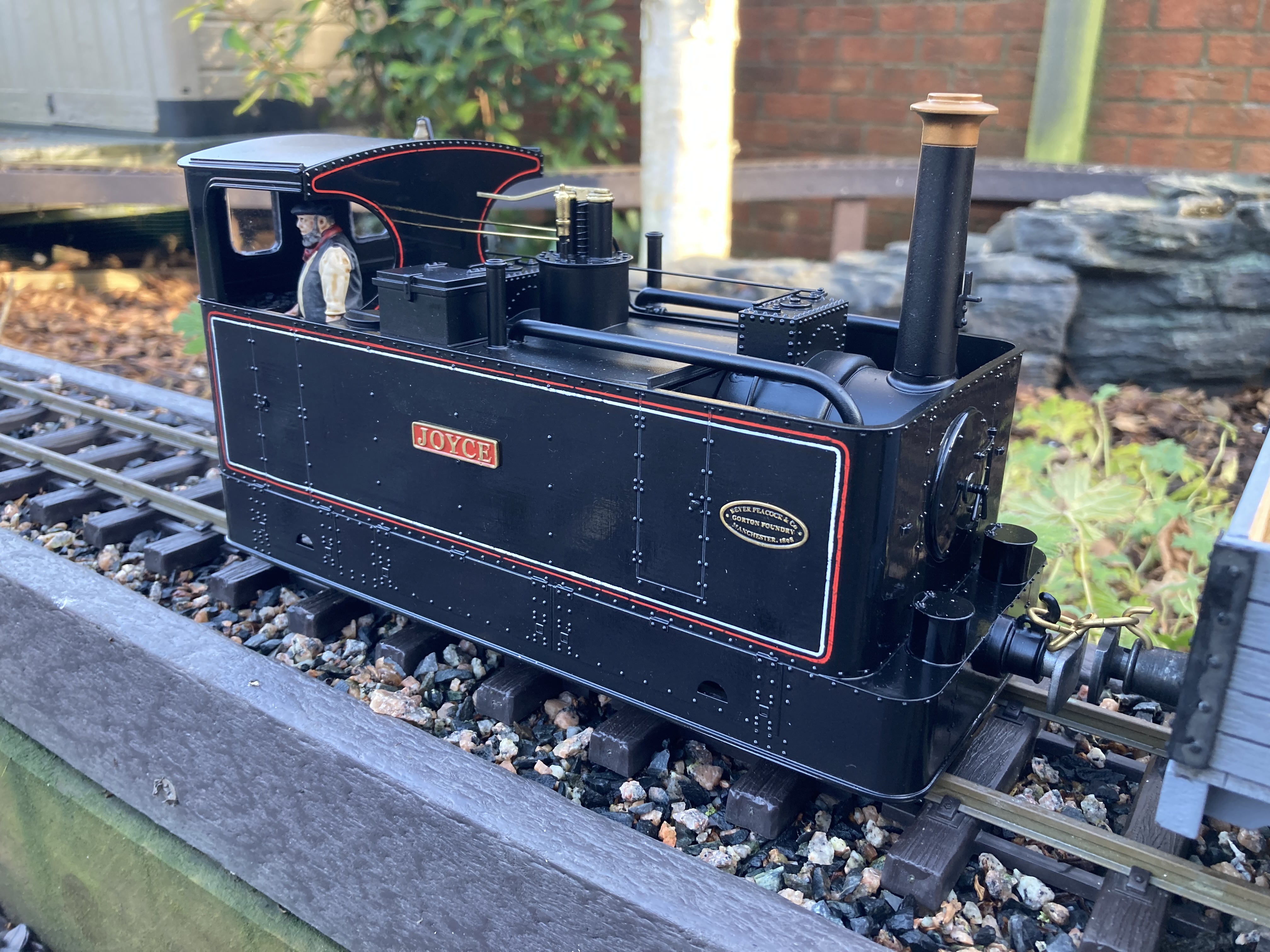

Some photos and video of my recently completed tram engine ‘Joyce’ based on GVT’s Sir Theodore/Dennis. This is mostly 3d printed, with some Cnc cut brass and Perspex sheet. It’s to my own design to a scale of 14.4mm/ft, which is the largest size I could squeeze on to the build plate of my resin 3d printer. It runs on an LGB Stainz motor block, using a 3s 1000mah LiPo battery for power and Micron rc receiver for control.

What an absolutely beautiful job you have made there. Wonderful detailing and superb finish.
Great runner too.

Now THAT is a very nice model, love the accurate chimney shape!

Beautiful in every respect.

The printing is very crisp and smooth.

I should have credited Rik for the inspiration for this build. I had started with the intent of printing off his design for Glyn and ran up against the problem of size restrictions with my printer. Sir Theodore/Dennis were 1ft shorter than Glyn so I modelled them instead and could print at a slightly larger scale.

I much prefer your model. Mine started off in 7mm and was rescaled to 15mm. I think your earlier version with the gull wing style cab front looks a lot more interesting. I also did away with the condensing pipework which they removed later on in the loco's lifetime

I'm loving this model! I'd pay good money to have a 16mm scale version, I have a PDF models example but it isn't TOTALLY accurate, so perhaps the new owner might appreciate a design that is closer to the real thing?

Would this work if the original GVT gauge was scaled to 32mm track? 13.4736842105mm to the foot roughly

Hi Tommy, rescaling would need some redesign as the model is made up of 3D printed parts and 3mm Perspex sheet. Just rescaling the print without a corresponding change in sheet thickness would mean various parts wouldn’t fit or would be misaligned.
