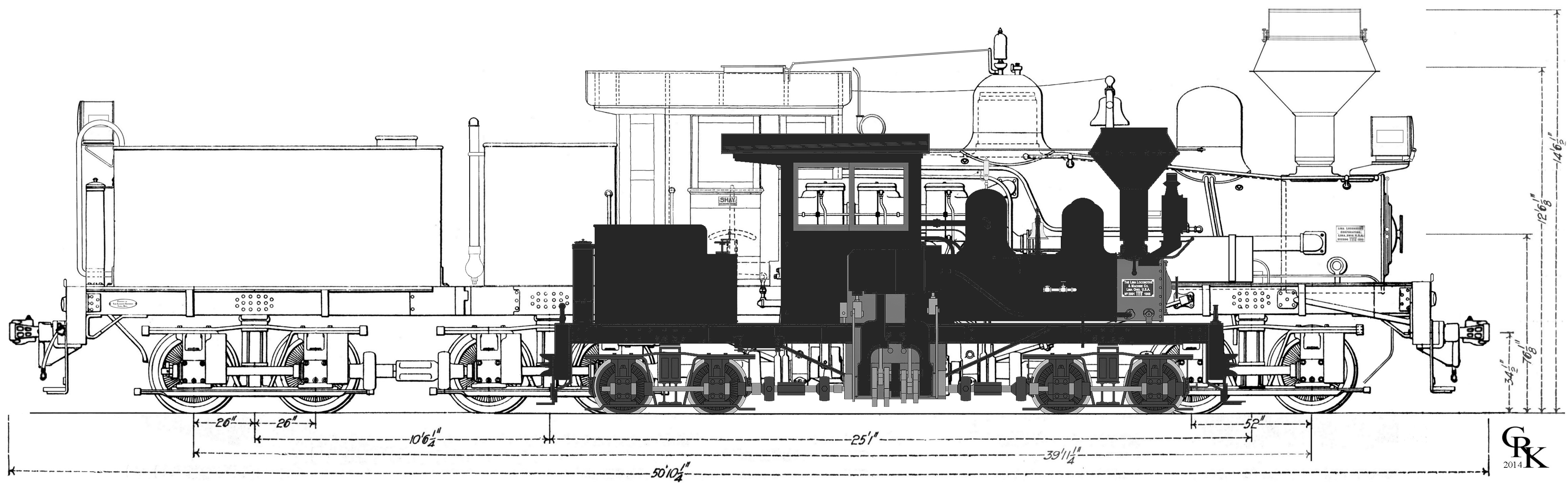

Colleague of mine sent me this image - sort of puts the 13 Ton Shay's size in perspective:
