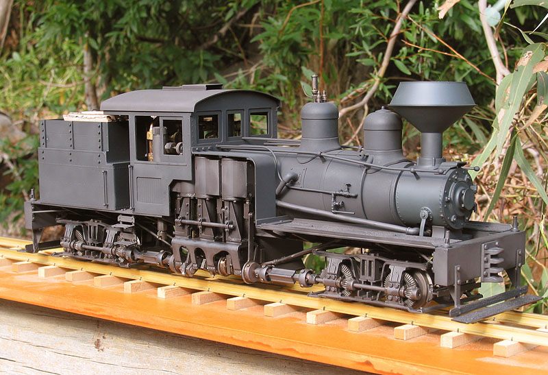

Back in 2014, Accucraft announced they were building a 28T Class B Shay and I put my name down for one with Michael at Argyle Loco Works later that year. It took until late 2015 before the Australian shipment finally arrived and I took delivery of mine in August 2015.
This photo is the loco straight out of the box, sitting in spring sunshine, ready for bench testing and running in. The plan was to then modify it to look more like an Australian shay, for work on the Mt. Delusion Timber Co. timber tram. This is the side usually seen in shay photos, as it shows the engine and drive line and looks more 'interesting'.

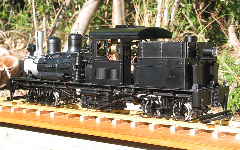

The second photo, is the other more rarely photographed side when it comes to shays.

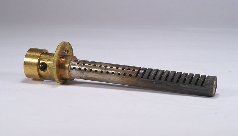

This photo shows the burner after modification by Gordon. As designed the area with the holes was blank and only the short slotted area was doing anything useful. Gordon drilled the holes to extend the heating area and fitted some mesh under the slots to even out the flame. This also noticeably quietened the burner down.

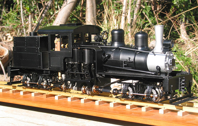

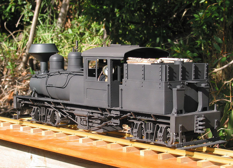

At this point I made a spark arrestor and fitted it, then removed some parts not appropriate for Aust. timber tram service, before taking it around to Grant's for a track test to check the modifications. This pic. shows the loco ready for the track run. Spot the changes.

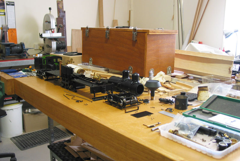

The test run was on a stinking hot day, but being a geared loco, it didn't need to be chased around the garden, so heat stroke was averted. The first run was light engine and the second run was with a light load. These went well enough to encourage me to finish off the cosmetic changes and strip it down for painting. This pic. shows the workbench with a shay jigsaw laid out in the process of being painted.
The model is a nightmare to dismantle, even for minor repairs, being held together with a large number of M1.6 hex head screws, some of which are almost inaccessible. I had to make up some special drivers for those. If you don't get the disassembly/assembly sequence right, you have to backtrack and start again.

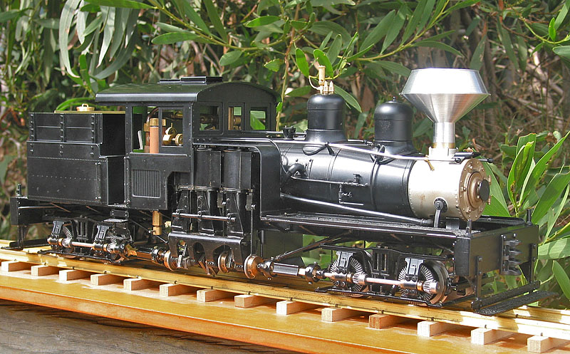

The final pics. show both sides of the loco with all the modifications completed and after leaving the paint shop.
I eventually got there, with help from Gordon Watson, but the burner and smokebox work should not have been necessary. This one isn't an isolated case either, as I noted another one running at last years GSSU that was struggling to maintain boiler pressure.
