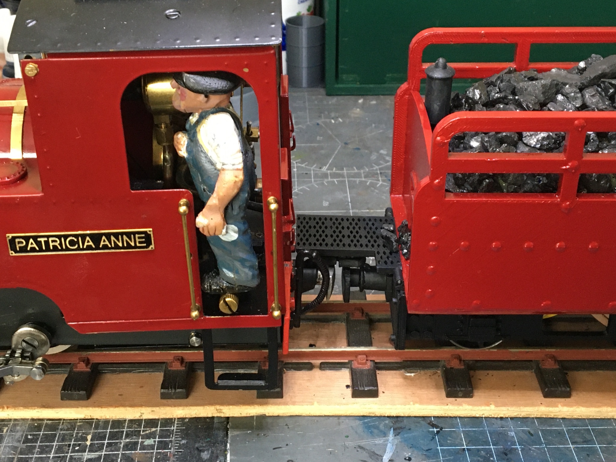

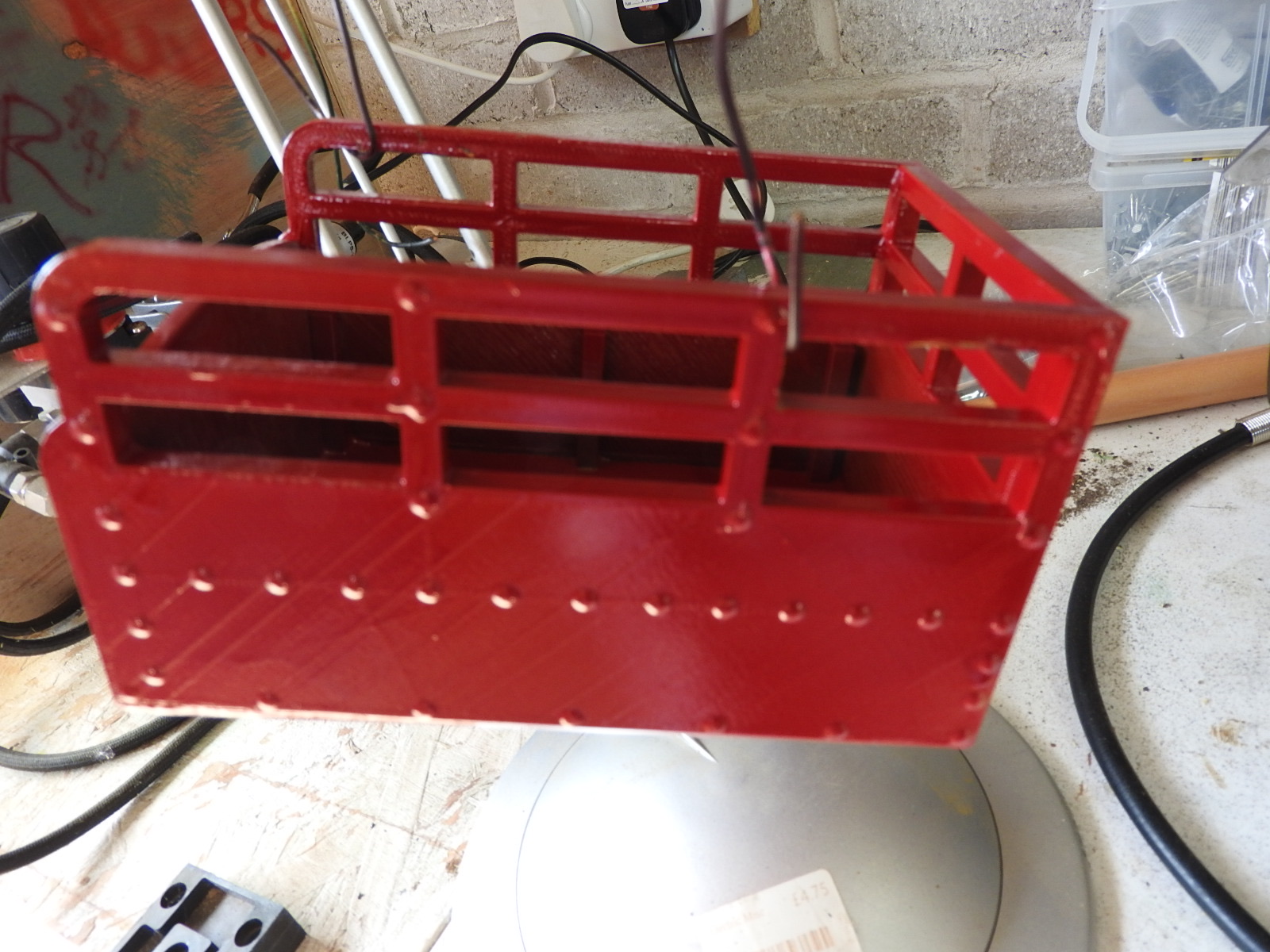

Re: SSP slomo
I have used those Zeecar's on the tender for my RH Billy.
This was all 3D printed on my printer with the coupling links and the chassis. It works great, but I do have to reduce the clearance a bit more so it can go over points. I did use real coal also and I think it looks more authentic. It's a lot cheaper than the Slomo's, but then again like Rik says, I do have to pull it behind the loco and maybe it's not as controllable, but I can get smooth running. It all depends on were the gas valve is set at. It's worth a try I would say and they aren't that expensive, well they weren't 2 years ago. I did use two also.
