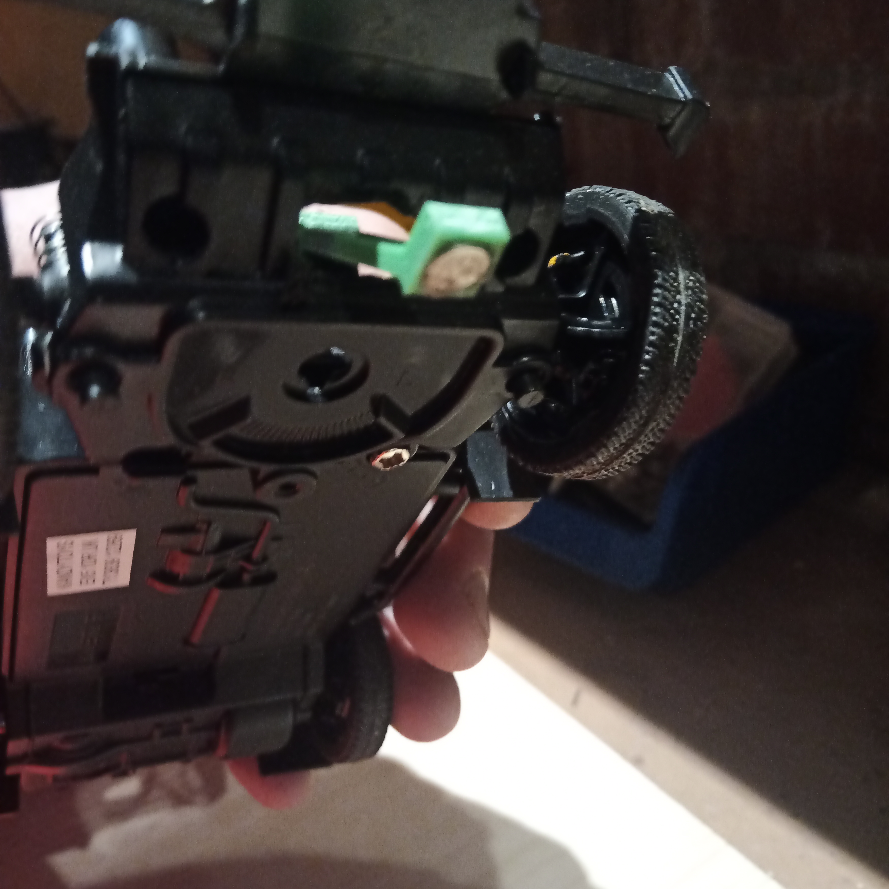

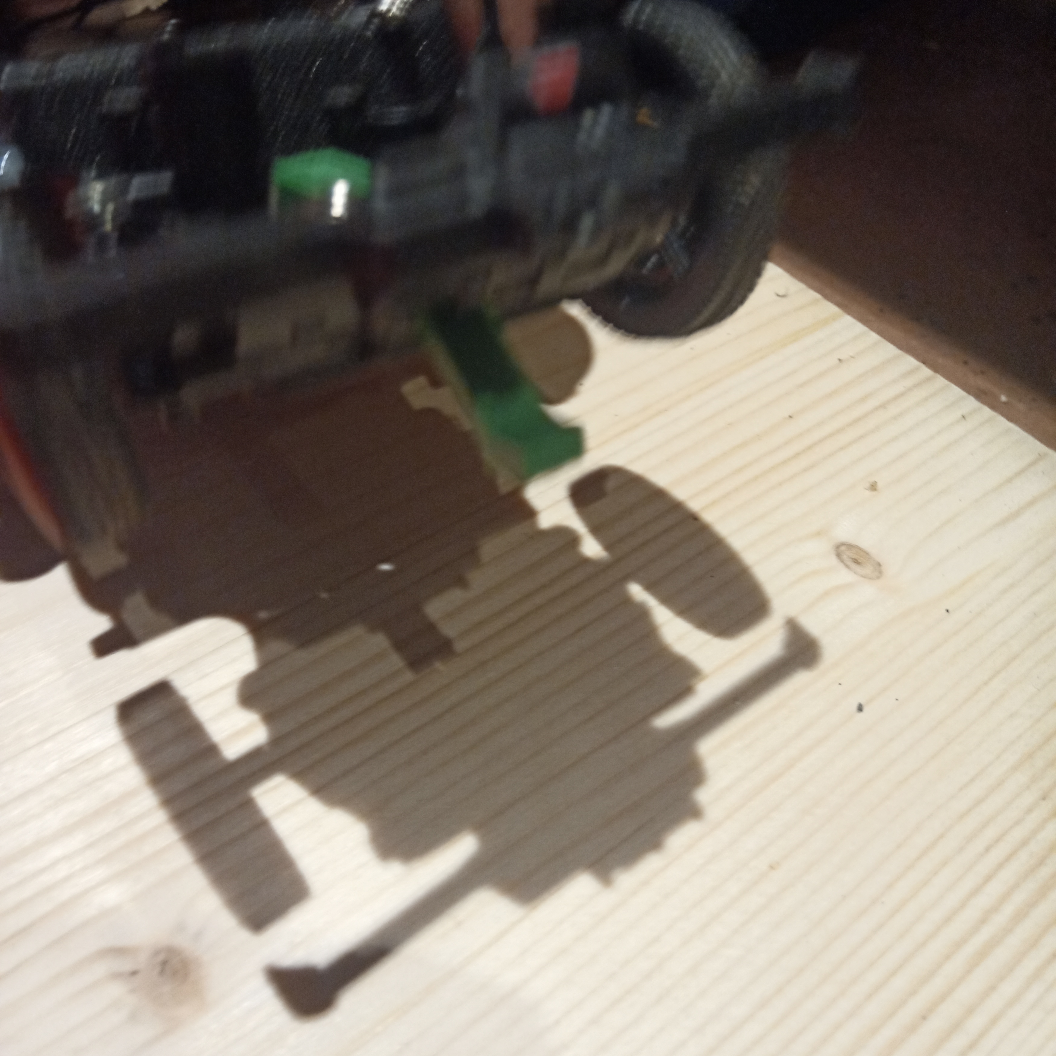

Initial progress has been to purchase two of the same vehicle.
Open it up, remove parts of the steering system and replace with a 3D printed guide arm with magnet.
It really did end up being quite simple for this particular vehicle as the steering system parts left over could just be attached to and a small slot cut in the chassis for the guide arm to go through.

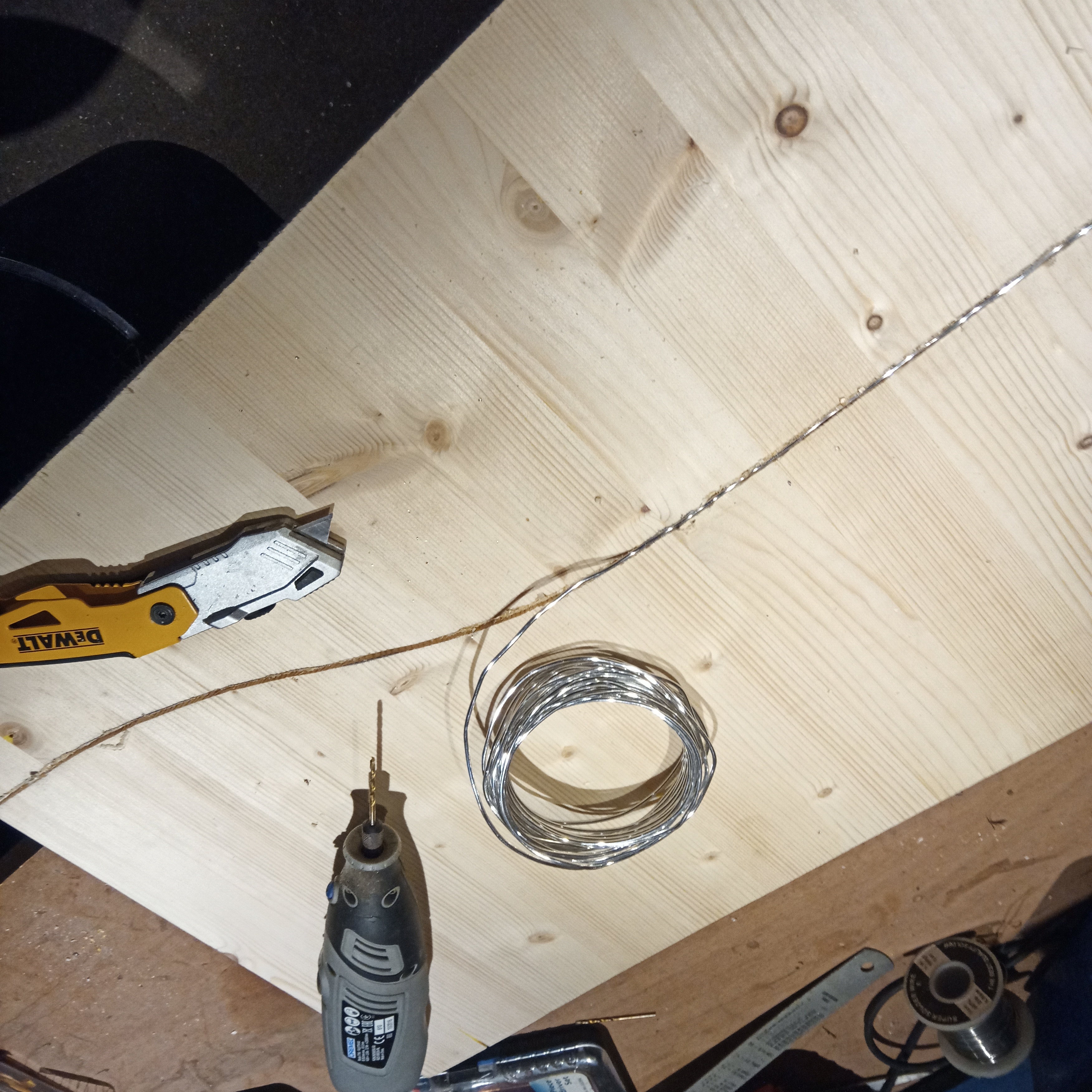

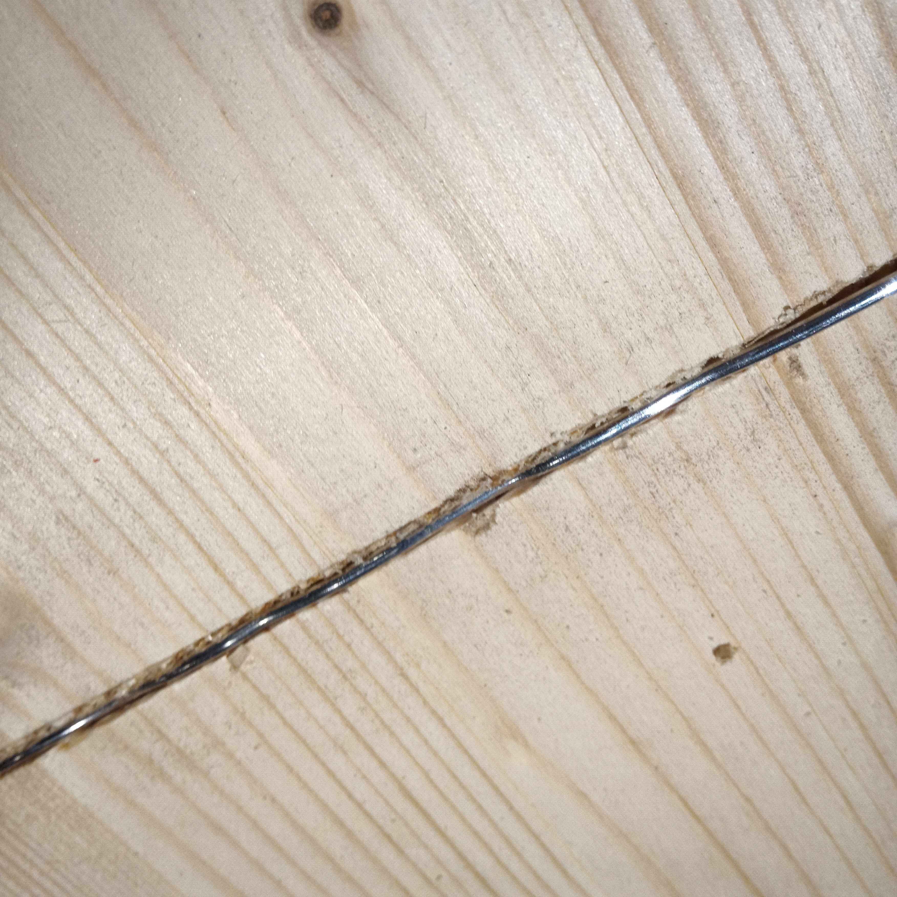

Next came making a test track by cutting a groove in a wooden board, running a metal wire through it and covering with tape to keep it all in place.
stevenfitch
Posts: 223
Location: Northumberland UK
Re: Faller Style Magnetic Guides Road Vehicles - G Scale

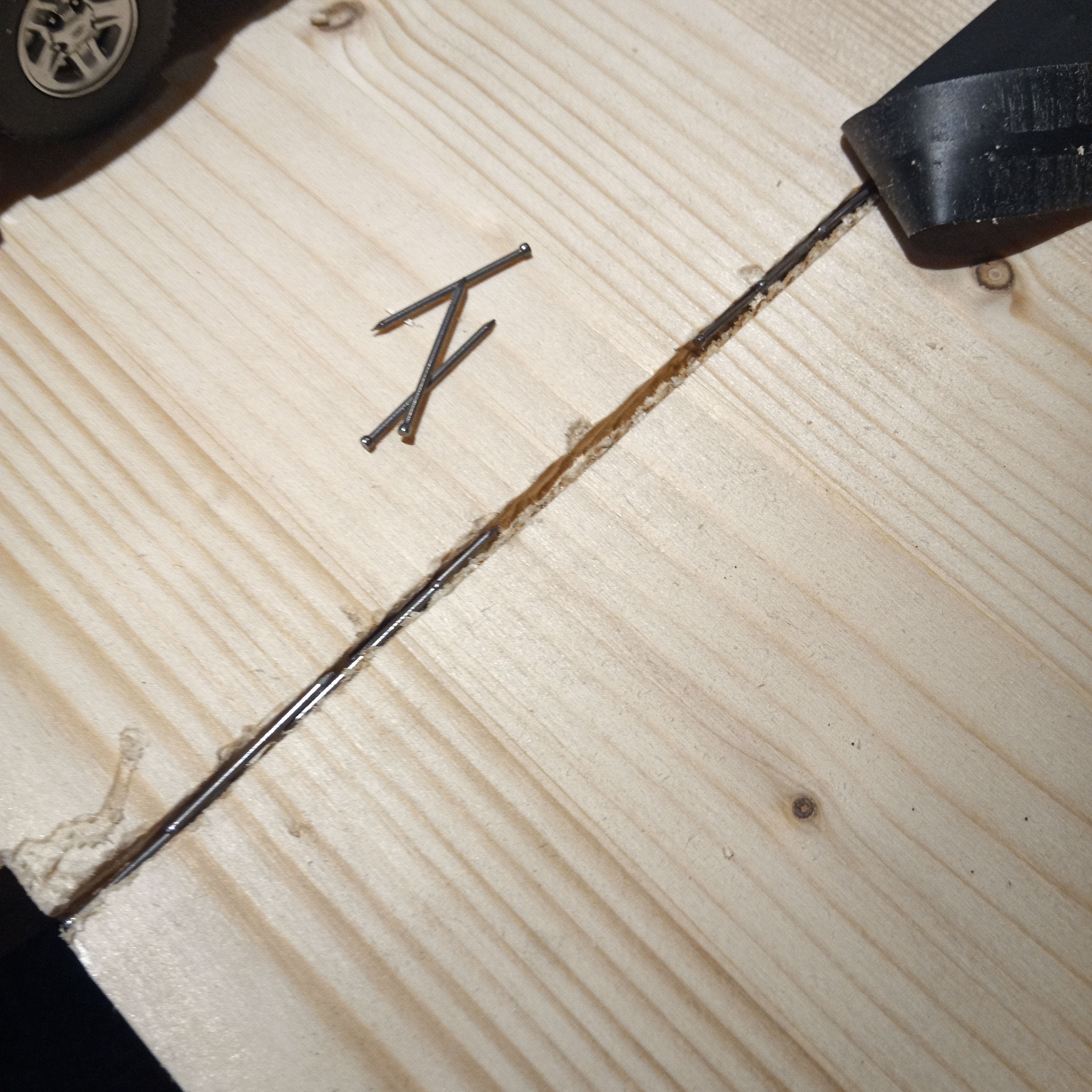

Post by stevenfitch » Thu Nov 17, 2022 3:08 pm
At this point the car would not stick to the track at all.... this is when i discovered for some reason i had ordered Aluminium wire.... non-magnetic!
So a temporary solution was to fill the groove with steel panel pins and tape back down.

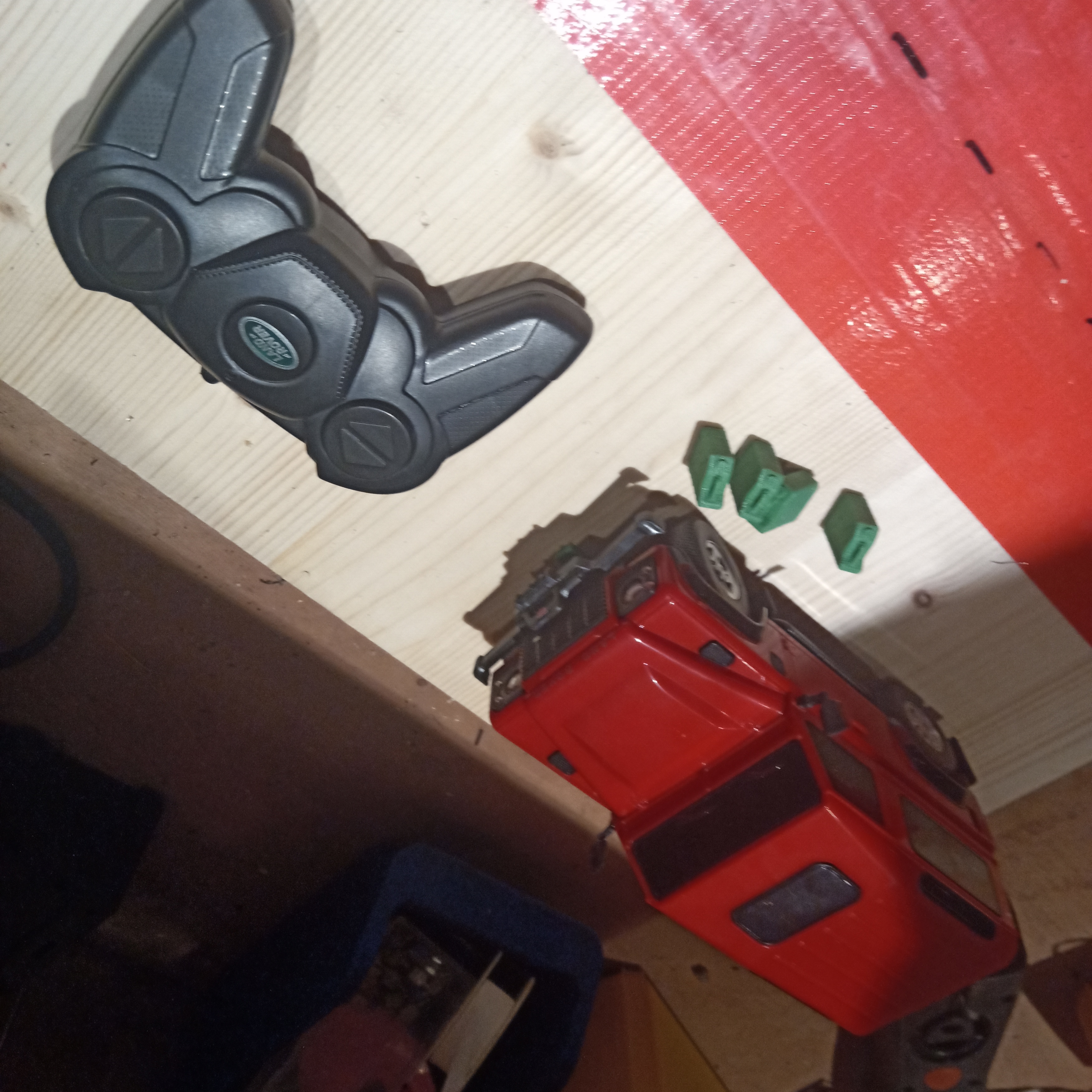

Post by stevenfitch » Thu Nov 17, 2022 3:09 pm
Once taped down the whole thing was covered in red gaffer tape and black dashed lines drawn to show the line of the groove / wire / pins.

Post by stevenfitch » Thu Nov 17, 2022 3:11 pm
Initial testing using the controller which has the forward speed as either ON or OFF looks promising.
