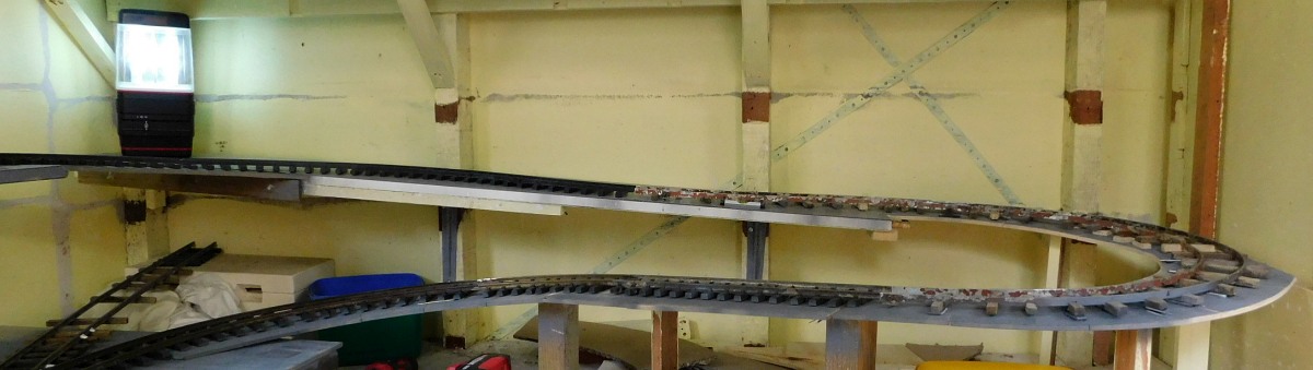

The upper to lower level connecting track
This section is just 13’ of track long and rises 10 1/2” from the lower station. It is VERY steep and sharp curves, but it will let me do some scenery of mountains and tunnels etc. Maybe even a high trestle bridge.
the curve and dwg.jpg (369.15 KiB) Viewed 304212 times
For the 12" radius semicircle I used aluminum bar for the rail as it was easier to bend to such a sharp curve. (I used this method of making track when I first started outdoors.)
Vaseline is used to lubricate the inner parts of the rail heads!
I originally ‘designed’ the grades to be 1:16 on the semicircle and 1:14 on the straighter bits. But due to some miscalculation or mis-measurement by ‘someone who shall remain nameless’, I finished up with 1:18 on the semicircle and 1:11 on a 16” radius curve.
That is the new Ruling Grade and is the left end in this pic...
side view of grade.JPG (102.87 KiB) Viewed 304212 times
One of the small locos I plan to use can handle 3 wagons on that grade but the other loco can only do two. Will make for more interesting operations!
Here's the link showing a test train: https://youtu.be/UlKOfV2FODQ
