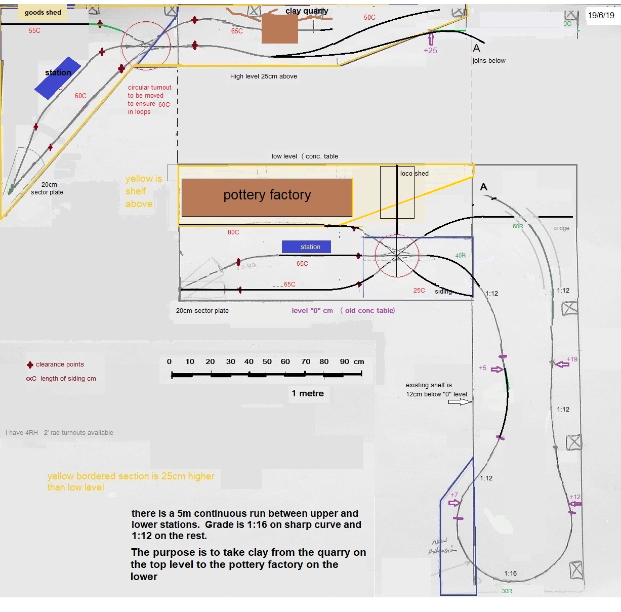

I wanted more than an Industrial / shunting layout - there had to be somewhere for trains to go to, and come from.
Even though it is a small space (about 6' x 8') I wanted to use my existing G trains - my shorter locos and wagons - max 8" long with 4" wheelbase. The locos are all battery+RC.
Trains will have a maximum length of three of my existing 8” long wagons!
Here’s the plan
IMG_8954J .jpg (307.45 KiB) Viewed 213614 times
You can see there are two stations more or less above one another with a height difference of 10" – the plan shows them separated for clarity.
And they are joined by a steep, curving line with a semicircle of 12" radius on a 1:18 grade. The 'straighter' parts of the line are on grades between 1:11 and 1:14.

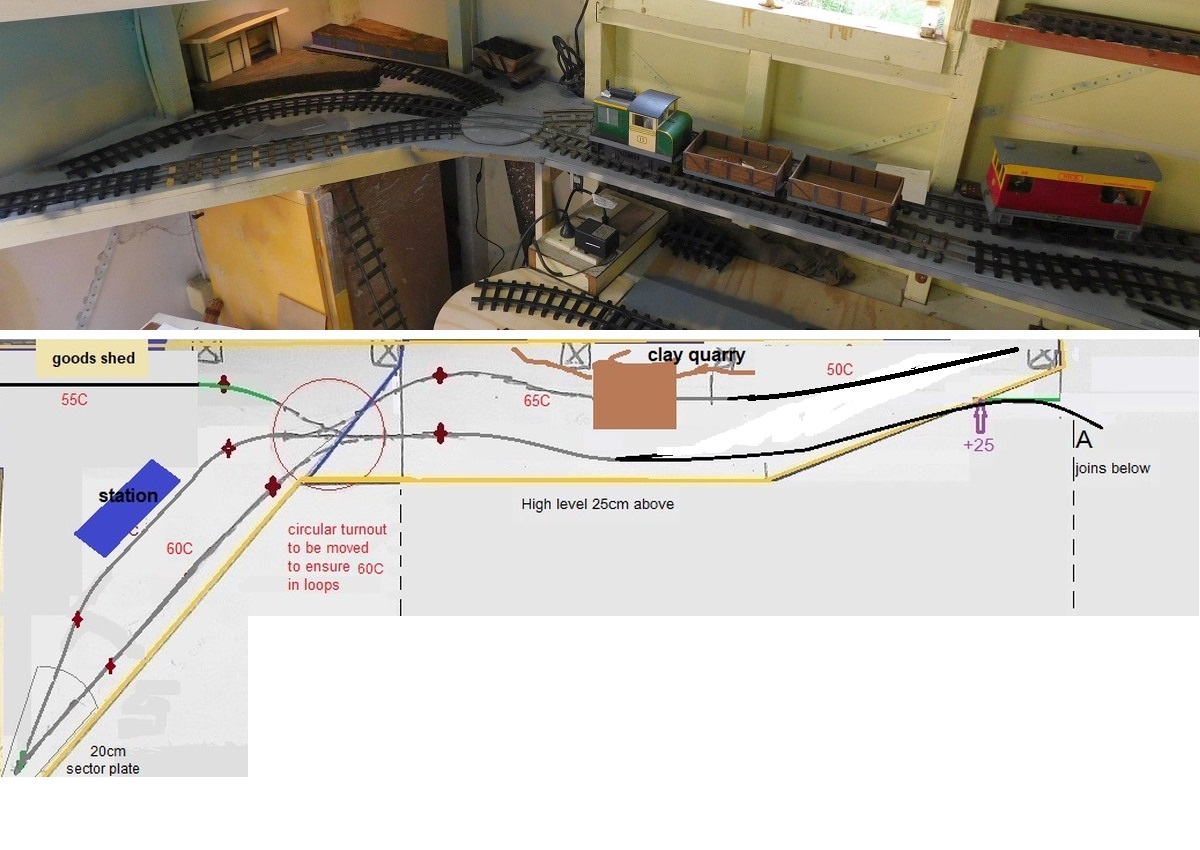

Claymine station – the upper level
Tracklaying is complete at the upper level - I used lots of plastic track from cheap 'christmas train sets' where possible – these are 2’ radius. The crux of the whole small layout idea, allowing space saving, is the 'circular turnout' which I have devised. Instead of a 'normal' turnout 30cm long and needing say 3 of them in series taking a metre or so, this circular turnout is just 20cm long and allows up to 6 lines to radiate from it. BUT it is very finicky to build and install !!
I made the two of them on 7mm thick ply using plastic RAILS (not plastic track) epoxied to the wood. They are VERY finicky to make - all 4 ends must have EXACTLY the same gauge and make EXACTLY the same angles at the perimeter. And be all the SAME length to allow it to turn without binding. Using plastic rails made it a lot easier to do these adjustments - a dremel with cutoff disk! (the plastic rails came from TrainLi USA.)
Where I have to use curves less than 2' radius, I am making the track from brass rail (and to 46mm gauge) nailed to timber sleepers as I did outside, or LGB track.
The upper station has a main+loop and two sidings. One of these will be a 'clay mine', and the other a goods shed. In memory of Pauline and her pottery hobby, the clay will be transported downhill to the pottery factory at the lower station. This picture shows the plan and the actual build.
upper station and dwg.jpg (240.82 KiB) Viewed 213496 times
This is a link to a video showing some testing: https://youtu.be/U7_h70yw74Y

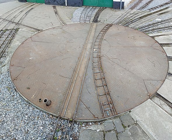

I thought I'd see if anything like your turnouts exist(ed) in the real world. This was the nearest I could find. A dual gauge straight and curved turntable on a miniature railway in Brussels

ge_rik wrote: Tue Nov 08, 2022 7:04 pm I thought I'd see if anything like your turnouts exist(ed) in the real world. This was the nearest I could find. A dual gauge straight and curved turntable on a miniature railway in Brussels
Amazing. Really just a turntable as most of the tracks could not be lined up for 'through' running. But I wonder why they even bothered with the curved track.
Greg from downunder.
Posts: 728
Location: Staffs. UK
Re: A tiny G gauge indoor layout
Post by Phil.P » Wed Nov 09, 2022 10:32 am
I think it probably evolved over time?
The curved route being a later addition..
Though I could envisage a through-route, using the curve, to the tracks to the right of the sheds?

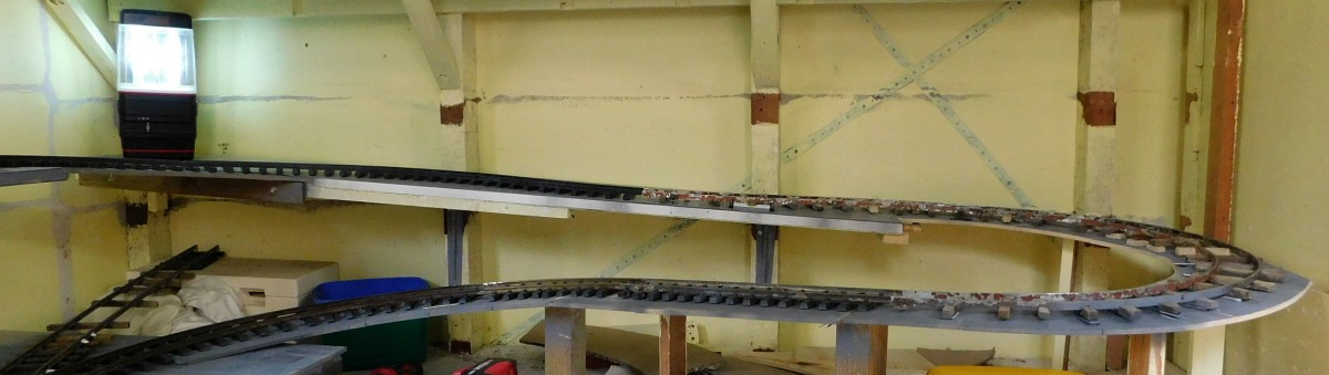

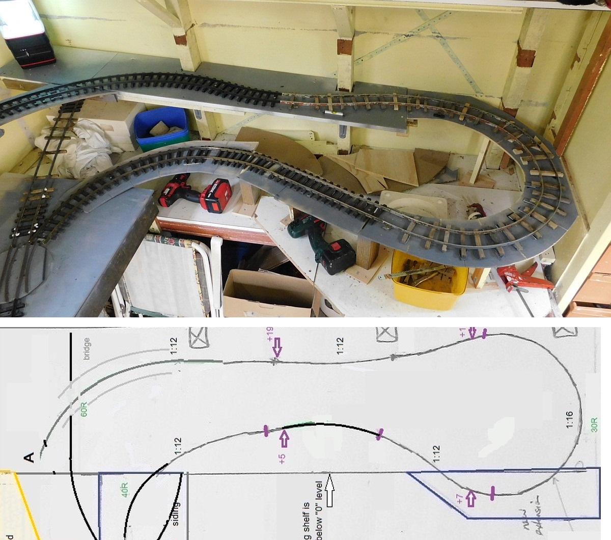

Part 3
The upper to lower level connecting track
This section is just 13’ of track long and rises 10 1/2” from the lower station. It is VERY steep and sharp curves, but it will let me do some scenery of mountains and tunnels etc. Maybe even a high trestle bridge.
the curve and dwg.jpg (369.15 KiB) Viewed 213331 times
For the 12" radius semicircle I used aluminum bar for the rail as it was easier to bend to such a sharp curve. (I used this method of making track when I first started outdoors.)
Vaseline is used to lubricate the inner parts of the rail heads!
I originally ‘designed’ the grades to be 1:16 on the semicircle and 1:14 on the straighter bits. But due to some miscalculation or mis-measurement by ‘someone who shall remain nameless’, I finished up with 1:18 on the semicircle and 1:11 on a 16” radius curve.
That is the new Ruling Grade and is the left end in this pic...
side view of grade.JPG (102.87 KiB) Viewed 213331 times
One of the small locos I plan to use can handle 3 wagons on that grade but the other loco can only do two. Will make for more interesting operations!
Here's the link showing a test train: https://youtu.be/UlKOfV2FODQ
