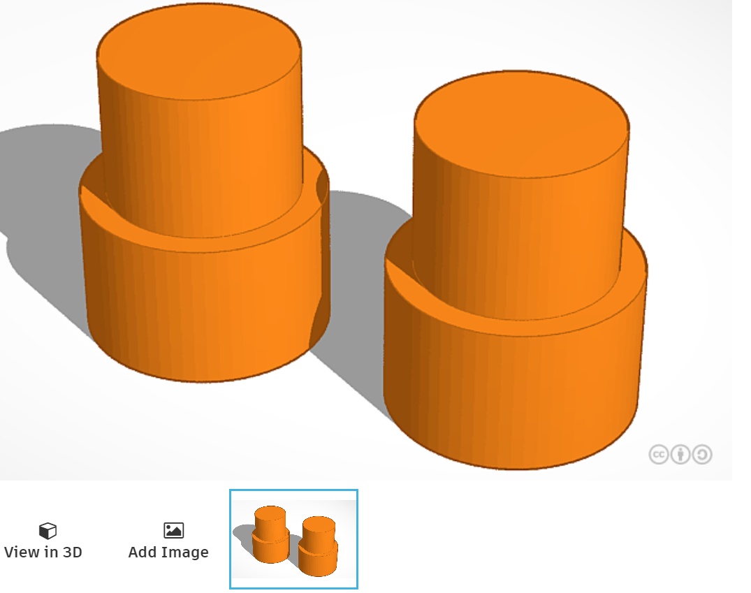

On the latter topic, you may recall (many moons ago) that I was having trouble with my el cheapo Anet A8 clone 3D printer giving me 'corrugations' in the vertical plane when printing. I have tried all sorts of ways of beefing-up the structure of the printer in an attempt to stabilise it. I then read (yet another) forum post suggesting firming-up the vertical rods might help. I wasn't entirely convinced, but I drew and printed out a couple of plugs to help stop their wobble .....
Anet plugs.png (210.8 KiB) Viewed 5567 times

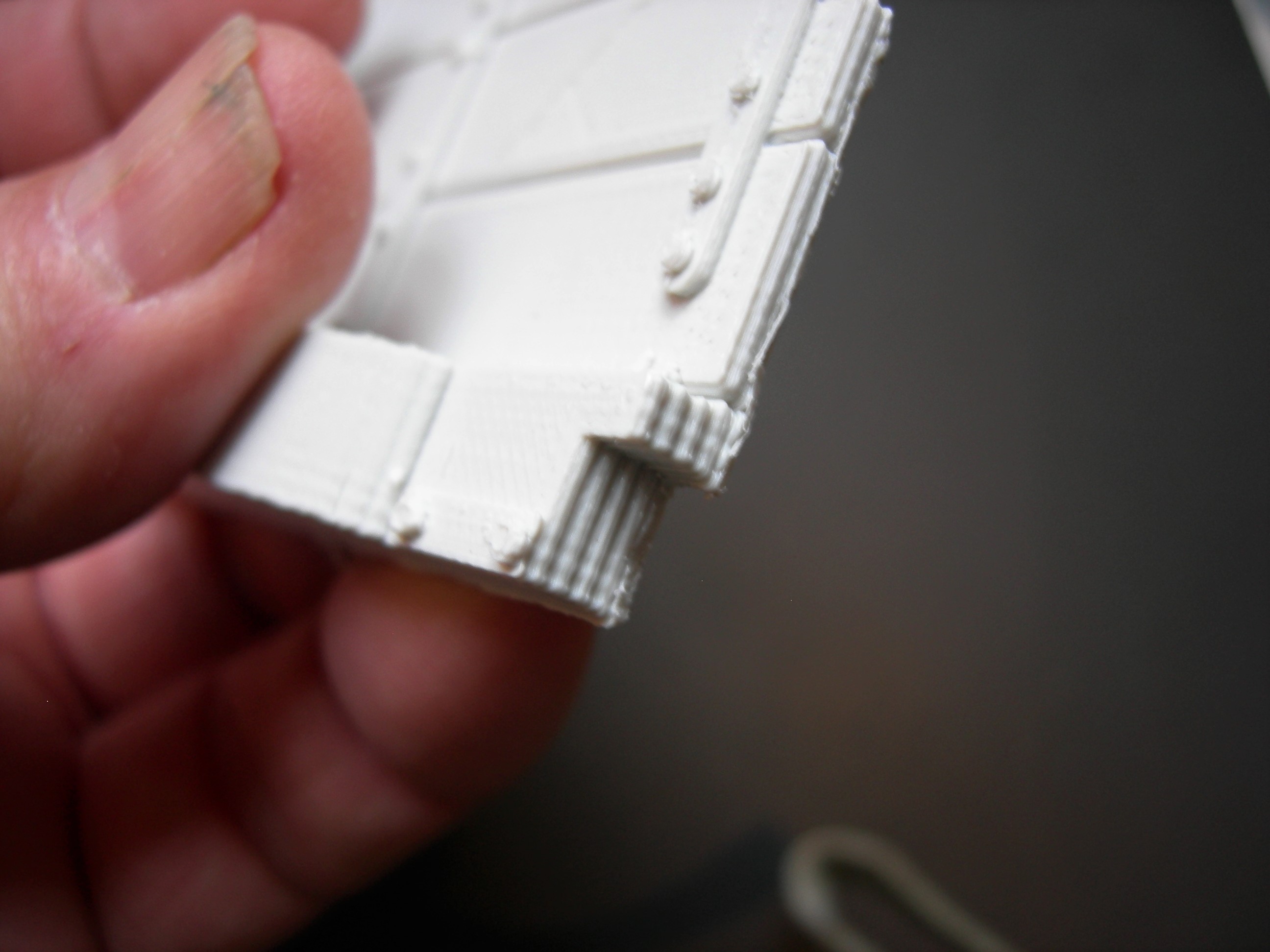

.....and hey presto - what a difference it has made .....
BEFORE .....
AFTER ....
If only I had figured this out three years ago!!!!
