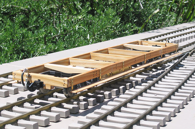

The underframe was built first, to confirm that it would handle the curves and clearances on my backyard track. As expected there were no issues, although like the US style cars, the coupler swing on some locos needs to be taken into account when marshalling a train.
The first photo shows the finished underframe sitting in the sun just after Christmas during track trials.

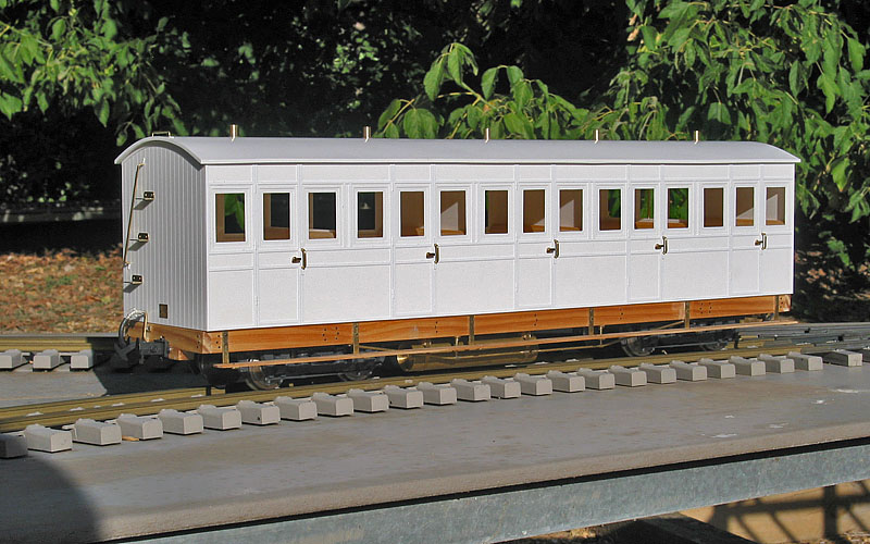

The next photo shows the completed bodywork fitted to the underframe and ready for the paint shop a couple of months later. The underframe had sat around while I worked on other things, as I was waiting for Brandbright to open up again. I needed more of the same ventilators used on the other cars in the set, but eventually decided to complete the model and fit ventilators later if/when they became available.

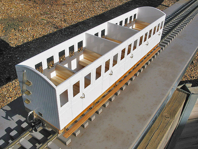

This photo shows the internal arrangements. Two compartments at each end with half height dividers and a single compartment in the centre with full height ones. The centre compartment would have been for ladies, one of the end compartment pairs would have been a smoking compartment and the other non-smoking. Interior detail is just basic seats made from custom wood mouldings cut to length and assembled, with the interior walls painted to resemble stained wood.

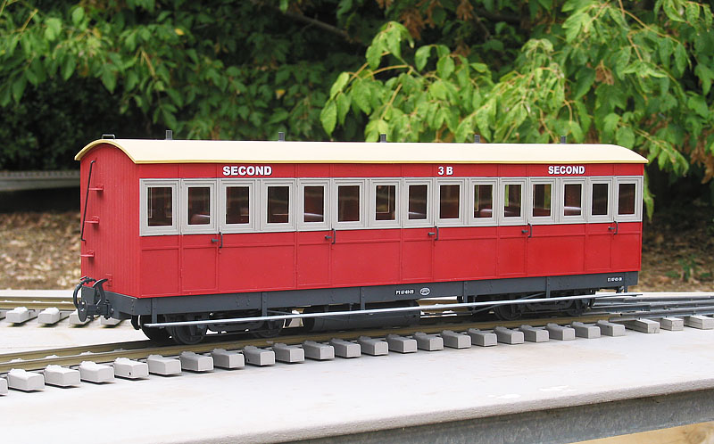

The next photo is of the model painted and finished, ready to go into service. As always the sun finally came out after the photo was taken.....

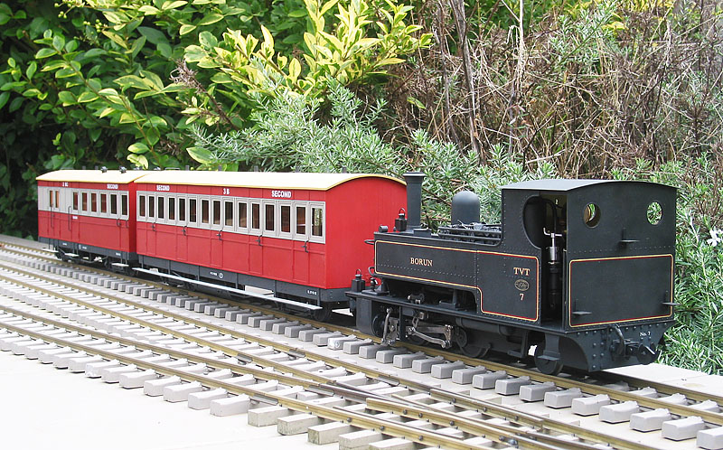

Finally, the last photo shows the branchline loco making up the weekly branchline mixed train. It will place the pass cars at the platform to load, then add a couple of goods trucks, before setting off. Normally the train crew outnumber the passengers on this service, but an excursion group have booked a return trip and the new dog box is included to provide enough extra seats.

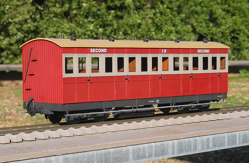

With Brandbright now coming back online, I was recently able to order the roof ventilators I wanted to complete this model so the roof matched the others in the rake. The package arrived the other day, the vents were painted the usual shade of faded black and they were fitted today.
Which now completes this project. One more job scrubbed off the whiteboard.
The photo shows the finished dog box car sitting in afternoon sunshine for it's portrait, with two rows of roof ventilators front and centre......
