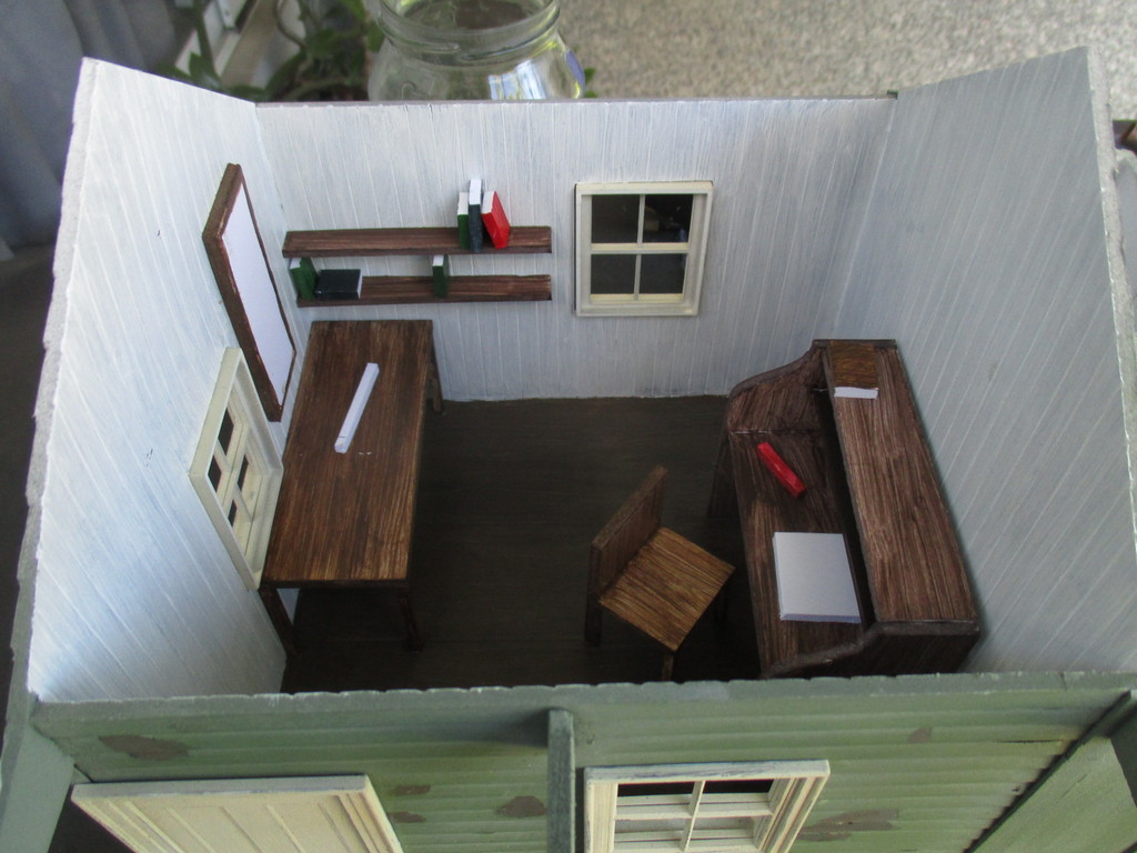

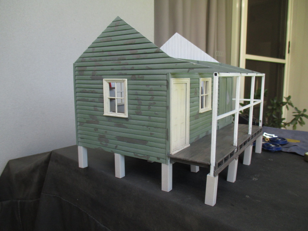

This foamboard and styrene traffic office, modelled on the long-since demolished example at South Johnstone sugar mill, has been sporadically-progressing for the last year.
The peeling paint effect was unintentional - the low-tack masking tape removed quite a bit of green topcoat. In spite of the grey primer showing underneath, it made for a reasonably realistic peeled paint effect; so I just stuck and ripped more tape from all over the building until I was satisfied. The exposed "wood" and "fibro" was then picked out with a wash of Tamiya enamels. The "hazy" effect on the green is because I sprayed during a storm. I tried gently buffing it with a kitchen scourer, which worked, but couldn't get into the corners without fully removing the paint. This turned out to be another happy accident, and has given the green another layer of age. An enamel "dirt" wash and flat clearcoat once the roof is done should see the weathering complete.
Jackson's Miniatures doors and windows are just loosely fitted, awaiting glazing with real glass. More effort, but more durable. Couldn't find any interior photos of period narrow gauge traffic offices, so this was knocked up from foamboard scraps, and will be illuminated before fitting a corrugated iron roof.

Accidental or not, the weathering looks fabulous. I just hope I last long enough to see all this in situ!
- Posts: 5726
Re: Stockpiling structures
I agree with Philip, the peeling and weathered paint effect is just perfect; it suits the style and period of the structure well.
- Posts: 8031
Great effects by happy accidents! I wish mine worked out so fortuitously ...

That is such an atmospheric little building Aaron. And a fortuitous way to add weathering effects - good job you didn't want it pristine!

As soon as I saw that paint peeling from the fibro, I was taken back to the old garage in the family home. Must have been the post war paint or fibro composition. Great work by you.
But the interior. Surely no railway office was without its Seth-Thomas pendulum clock. I expect to see a working model real soon.

Never seen peeling paint on fibro, so quite pleased to hear that. I considered a clock, but had to keep myself on a short leash for detailing this interior, lest I spend too much time on it, like the Imperial Hotel..gregh wrote: Tue Mar 22, 2022 9:09 pm As soon as I saw that paint peeling from the fibro, I was taken back to the old garage in the family home. Must have been the post war paint or fibro composition. Great work by you.
But the interior. Surely no railway office was without its Seth-Thomas pendulum clock. I expect to see a working model real soon.![]()
My local heritage line has made a very faithful 1:1 scale model of the TR's traffic office erm, "system" in the volunteers' cottage on-site..

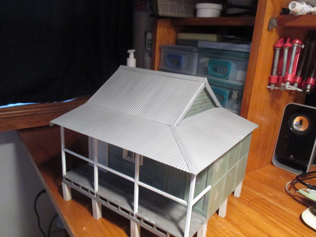

After grey etch primer, the building was sprayed all over with silver zinc, grey, a couple of browns and black, to get a galvanised effect. Short bursts and misting the paint seems to give good results, building up the effect in layers. It pays to leave the thing to sit afterwards and come back to it - you'll likely find you want to tweak some spot or other with a little more black, silver etc. Then the building was forgotten for a couple of months to work work on other projects.
On a Sunday whim, I decided to mask off and spray the randomly coloured sheets, approximating the prototype. Yesterday, I drybrushed some black and brown for age, and gave the timber around the roof's edge, what I think the prototype had. That's another one ready to go in the cupboard until it's needed.
Still needs an enamel wash all over for some more depth, but I want to complete a few more buildings first, and spend a day washing everything in one session.
Next up, a small shop and finishing the traffic office - it's roof was fitted and painted as I did the shed, but it still needs a couple of details before it can be shown..

The style is unfamiliar to UK structures but the material is not. You make it look so 'right' and will fit in well with your other buildings.

the traffic office roof was painted to look like new-ish galvanised iron. (Camera doesn't really show the colour variation, but it's there) I wired in a pair of 12V "grain-of-wheat" incandescent bulbs when I did the roof. A pair of wires hangs out from under the building, and will one day be connected to a buried grid system. That's the plan, anyway..
This was the first time I'd actually powered the thing beyond testing the bulbs before assembly. Really pleased.

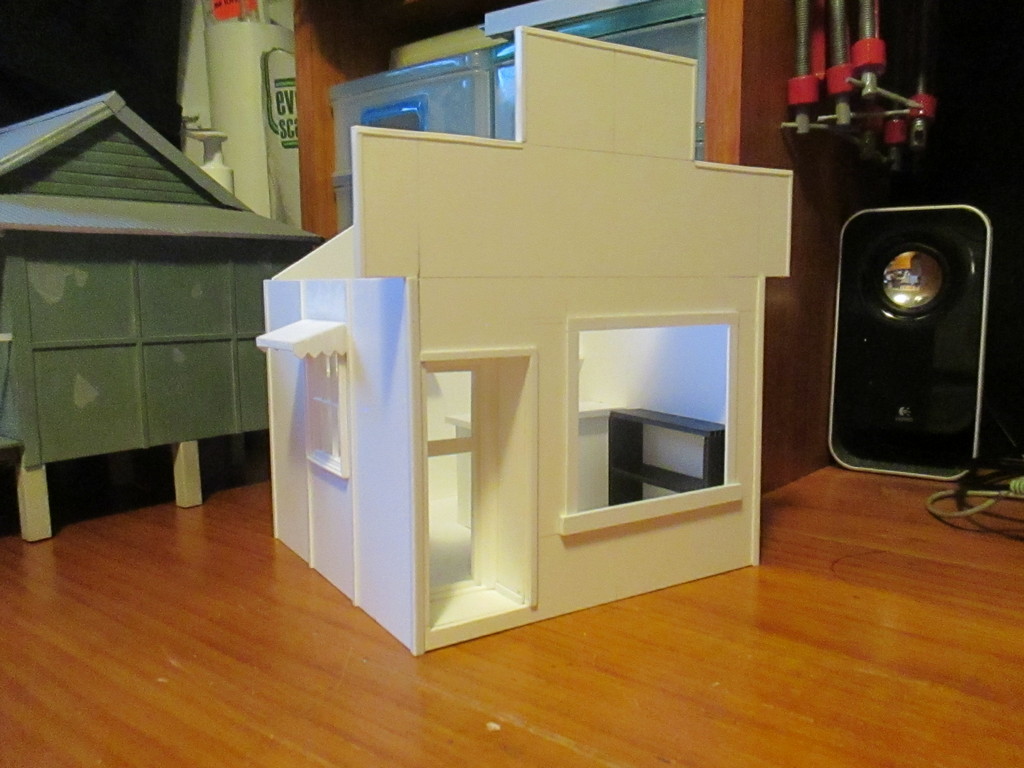

There's a tiny fibro-clad jewel shop in Woodford, Queensland, around the corner from the Woodford Railway where I sometimes volunteer in the workshop.
It's too damn cute not to model.
With a picture from Google and one from Street View, I got this far some months ago. Today I glued in the basic interior, and gave it a coat of grey primer after the photo. Tomorrow I'll topcoat it white. Cheers,

Nice to see the Aussie outline buildings. Love the awning over the window. Very Queensland.
