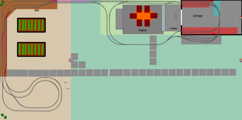

The new track plan:
(everything to the right of the red line pretty much survived the strom damage so is being kept as is)
Garden 2022.jpg (78.21 KiB) Viewed 31469 times
Re: New Beginning for 2022
Post by Andrew » Sun Feb 13, 2022 3:28 pm
That's a very impressive design, and a lot of track! How many trains will you be able to have operating at once?
I'm looking forward to further progress reports!

Andrew wrote: Sun Feb 13, 2022 3:28 pm How many trains will you be able to have operating at once?
(Under computer control)
Normally 4 as I'm planning on using the main loops (newest part) for most of the running but up to 6 if using the loop through the garage and various sets running too and from the storage in the garage.

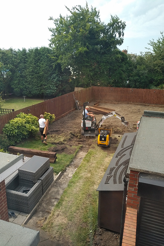

Post by stevenfitch » Fri Jul 22, 2022 2:01 pm
After much planning and deciding, work is now underway.
Decided in the end to just rip up the whole garden and start again from a level base.

Post by Peter Butler » Fri Jul 22, 2022 2:23 pm
Serious stuff that, and still some garden left over for the extension!

Post by BWLR » Sat Jul 23, 2022 8:29 am
Heavy duty civil engineering going on there!
Posts: 8048
Post by ge_rik » Sat Jul 23, 2022 12:54 pm
Any excuse to hire a digger ....... :lol:

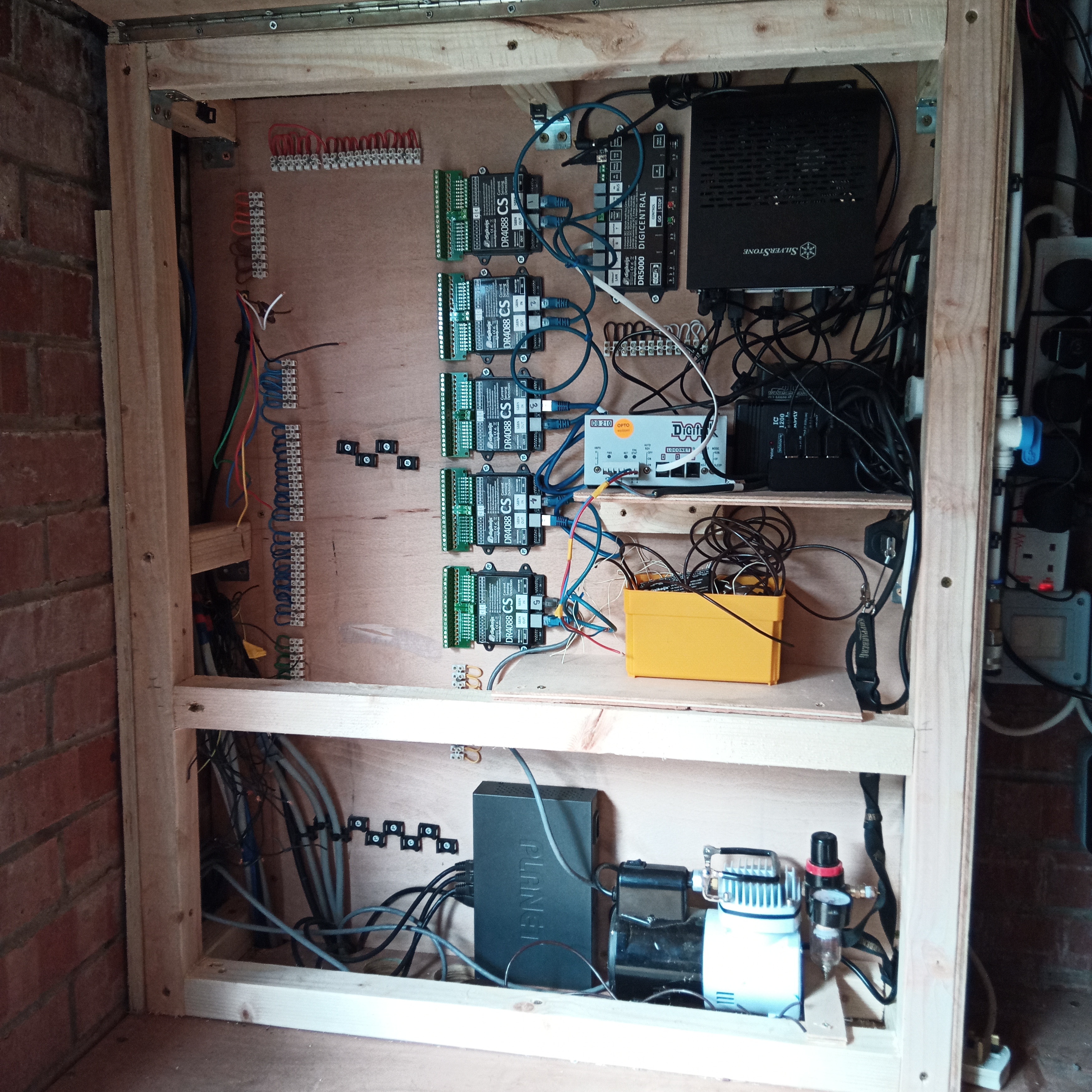

At some point a railway will make an appearance but for now the control box has been re-built

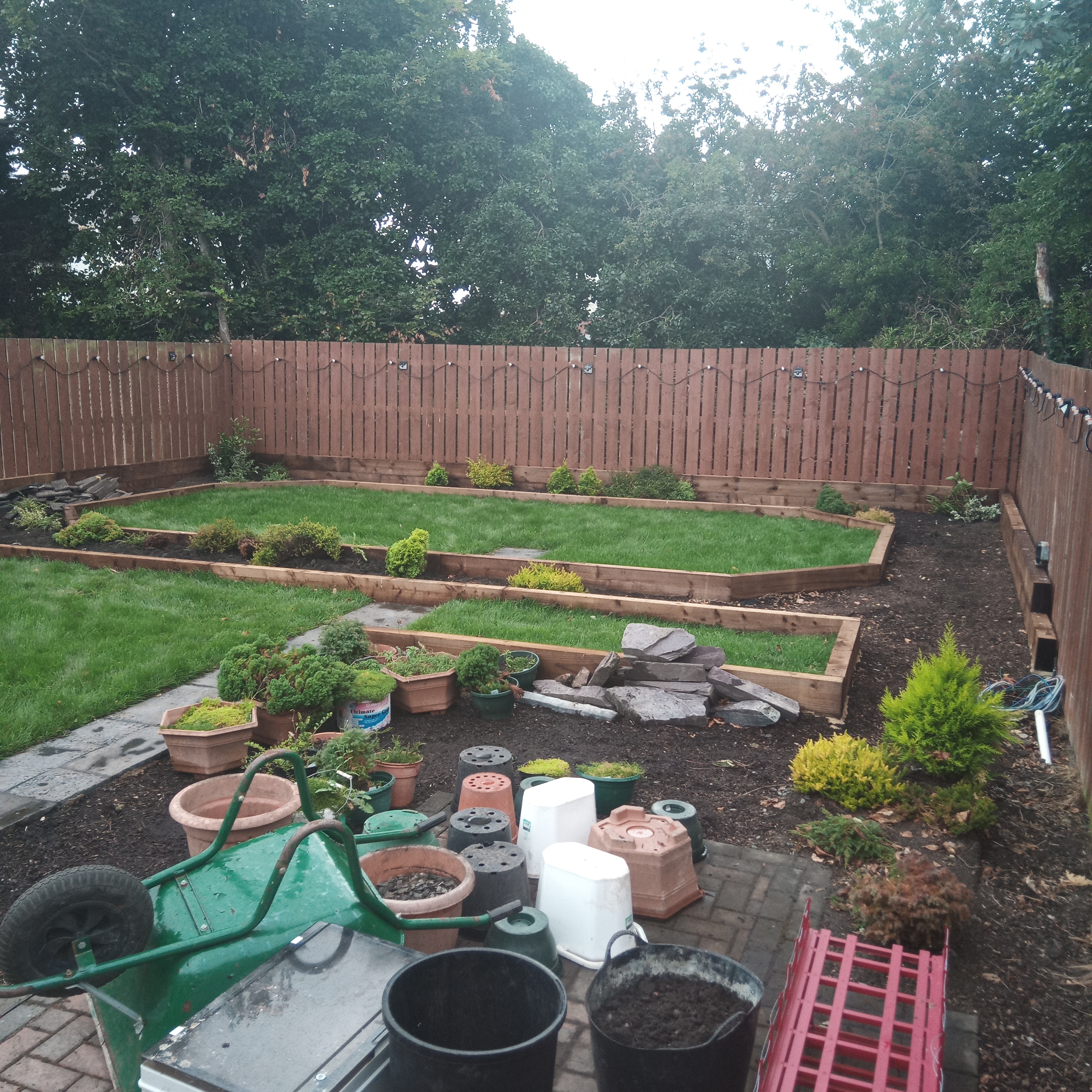

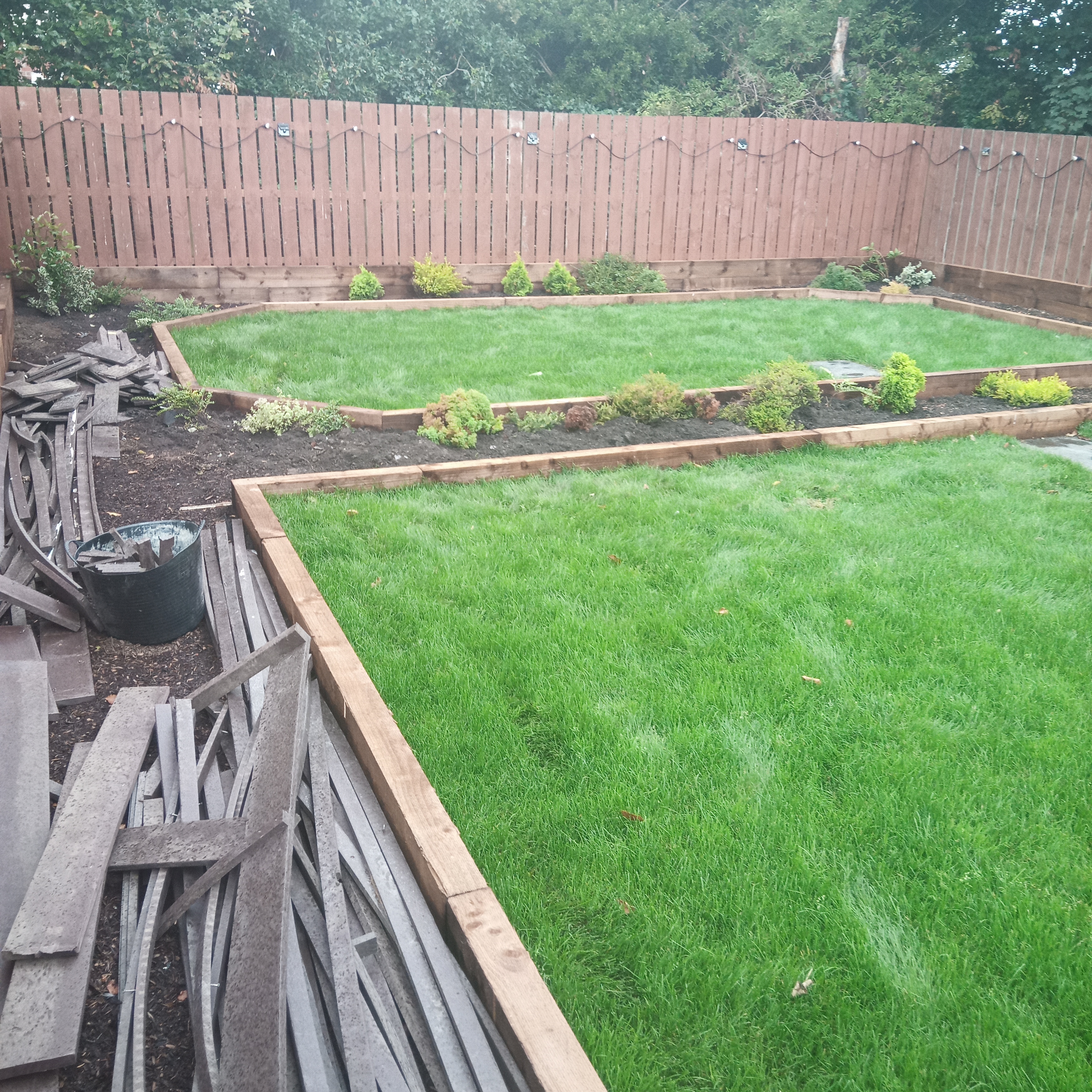

Post by stevenfitch » Mon Aug 22, 2022 3:03 pm
Major landscaping complete and some planting done, just waiting a delivery of some more materials for road bed from filcris.co.uk then that can all go in.

Post by Peter Butler » Mon Aug 22, 2022 3:58 pm
Wow, that's quite some progress since the end of July, well done!

Post by Old Man Aaron » Tue Aug 23, 2022 10:51 am
Great work, especially in the heat in your part of the world. Not long before the real fun begins! :D 8)

Air operated pointwork?

ge_rik wrote: Tue Aug 23, 2022 5:14 pm Air operated pointwork?
Yes, using the Sunset Valley Railroad equipment and a small air brush compressor
