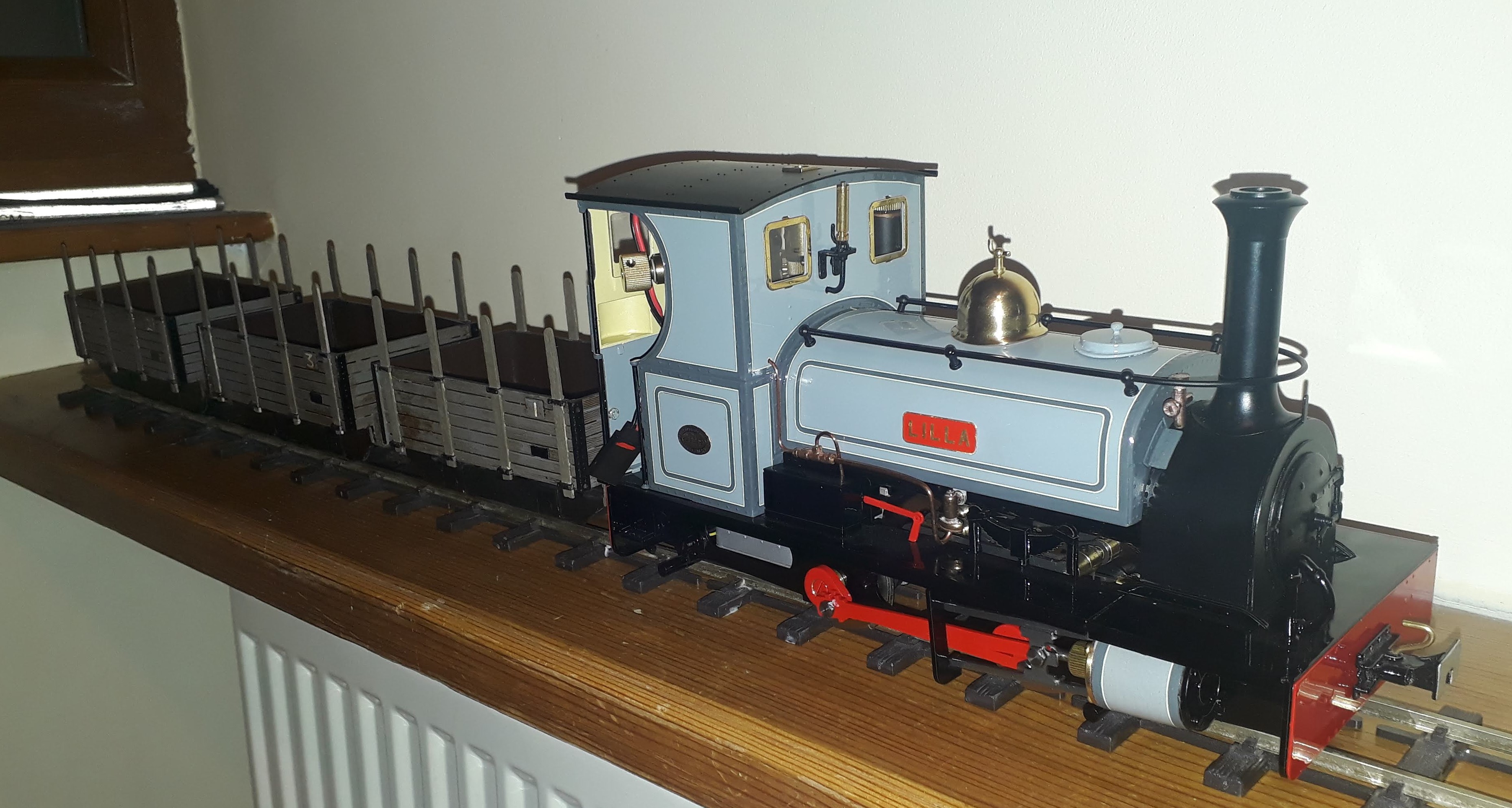

https://gardenrails.org/download/file.p ... e7d1baab6c
behind lilla are my faller conversions as copied from an ebay purchase for small wagons, they are plastic and working drop sides, remove three of the planks all the way round and use a hinged strap and curved brace from plasticard and you would have a smart little wagon.
