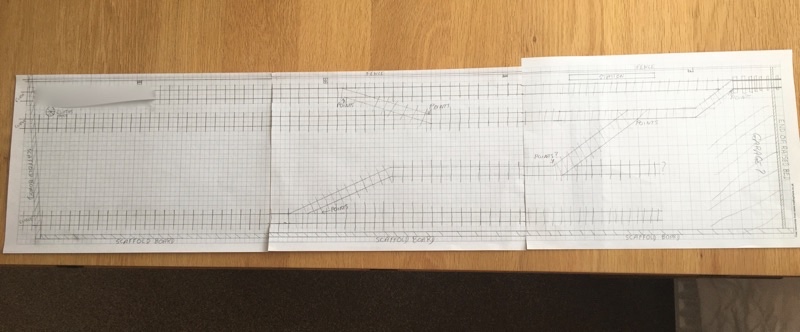

This is my track plan BTW.
It has changed somewhat just like you have mentioned it may do. The point at the top right hand is a lot further on and the so are the other two now which have moved towards the left also.
The reason I asked, is the line at the bottom I was going to have it run back to the top right hand into the tunnel and have the other track from the point go over the edge of the scaffold board and go around the bush to the other side of the bush. But now I am going to in the near future, just have a continuous line instead.
This is after your'e comments Phillip.

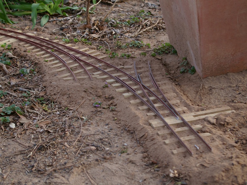

I used a wye on a previous layout as it came straight on towards a hill located in the middle of the loop. Because of the topography a normal left or right wouldn't fit in the available space which was fairly tight. Constructing it was something different as were the several curved turnouts I built.

Rod,
Here's a photo of it in place on my first layout. The switch to the left was a curved right hand turnout.

Thats nice Dwayne, and it does nicely illustrate my point(!) that you can't just swap turnouts without considering the geometry. A LH wouldn't work nearly as well as the Y and a normal RH wouldn't work nearly as well as the Curved RH.

Thanks for the photo, it does show how it should be perfectly. However I see that you have made your own points have you. I don't think you can buy curved points for 32mm can you

Rod... yes, I build all of my trackwork. Ties are ripped on my table saw using treated lumber that is soaked in a mix of old used motor oil & diesel for preservation. Spikes are #18x5/8" brad nails. Rail is code 250 aluminum.
It takes me about 2 hours to build a switch from start to finish. If I have all the components prepped beforehand, I can assemble one in less than a hour.
