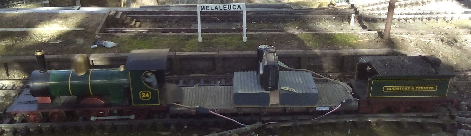

As I had plenty of servo extender leads I realised I could separate the loco and tender, put a wagon between them for the camera, and connect them with the servo extender lead, and still drive the loco.
So a quick lashup like this was used to test the idea.
camera setup2.jpg (177.18 KiB) Viewed 9940 times
Having run a few sequences along the track, I found that my 12 yr old camera gave better focus of both the cab insides and the passing scene. (but it is only 640x480 pixels video). But the view of the cab was a bit ‘static’ Then I had the bright idea of mounting the camera on a ‘turntable’ moved by a radio controlled servo. That would give me the option of varying the pan of the camera from straight inside the cab to a more sideways view. I needed to add a 2.4 GHz receiver and 6V battery on the flat car, with the Rx bound to the same transmitter as the loco control.
