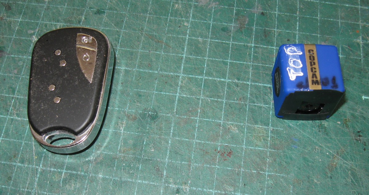

I did try some small cameras like these…. But it seems that it is impossible to get the inside of the loco cab in focus as well as the longer view ahead.
