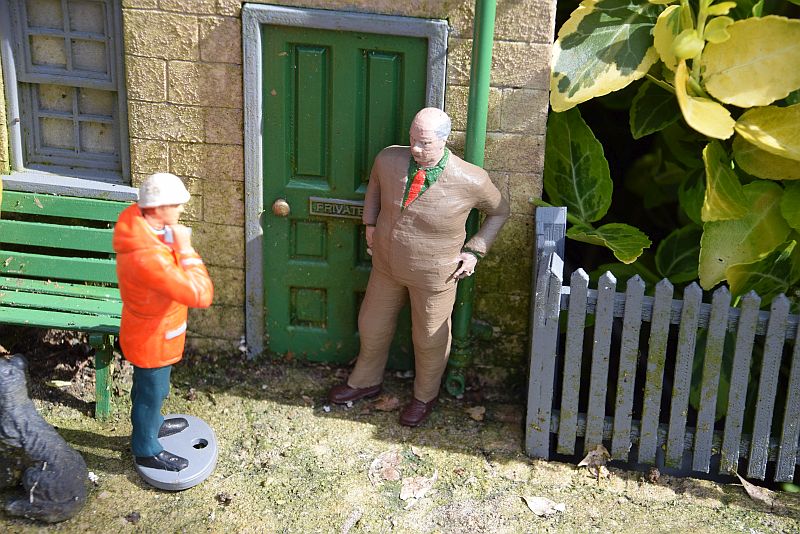

However, scribing stone courses into foamex ( etc) is dead easy and you get exactly what you want not what a dolls house supplier thinks you want.
The texture finish can be worked up using a number of products, from DIY by mixing very fine sand into emulsion paint, via Sandtex masonry paint in huge tins, to a product called "Miniature Stone Coating" available from E.M.A. Model Supplies but only in a limited range of colours.
However I would recommend you look at a company called "Stonelux" ( https://www.stonelux.co.uk/samples.html ) who do a wide range of textured finishes in a wide range of colours and, best of all they do 150ml sample pots for just over 6 quid. I have used about half a sample pot of their smooth texture paint to do 3 coats each on 3 walls measuring approx 600 x 500mm each. It's intended for outdoor use on full size gateposts etc, so is fully weatherproof.
This is a portion of one of those 3 walls, I realise that it isn't your Westmoreland finish but gives an idea of what can be achieved without too much effort.

If you look at the pictures of the front of my Lower Bench station in my Inspectors report from last week, you can see a foamex building, with scribed stonework and textured using the E.M.A. product I mentioned above. This building has been outside permanently since April 2018, so almost exactly 2 years of continuous summer and winter weather. The surface shows no signs of peeling, or other weathering apart from accumulating some surface grime, which adds to the appearance IMO.

As for the paint coating I've used, things seem to have changed around the suppliers. When I did the station building some 2 years ago, I bought a 250ml pot of "Miniature Stone Coating - Yellow limestone" from EMA, as I said, but I've just checked and EMA don't seem to have anything other than the primer/basecoat now. However, the label small print on my pot says "Charles Products patent applied for" and if you Google "Miniature Stone Coating " There is a link to Charles Products and if you click on that it takes you to Stonelux!
So, after all that, the station building is Yellow Limestone with some assorted browns and grey acrylic's washed over once it's dry. The small section of wall I showed above is Stonelux Colour Sample Pot ( 150ml) 'Magna - Smooth finish', again with some colour washes added subsequently. That is the third from the left on the sample pot colour swatch page.
I don't think all of the colours are available in all of the colours and finishes, although I did find their site a bit confusing so I may have missed things. I have to say I made a bit of a mistake with the 'smooth' finish and wished I had gone for a bit more texture.
No, I didn't need to seal the roof, it is strips of 15thou plasticard glued to a solid sheet HIPS under layer, so is completely impervious.

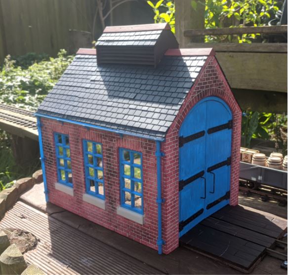

So having bought lots of news bit it was time to start yet another project. I wanted to prove my concept and look for the railway
So far rather happy with the rough slate look, needs weathering down and stones picking out in differing colours and shades. Trying to take a little architectural lead from what was actually built for the Windermere to Kendal railway. The window colour was a can of spray paint I had got to experiment with coach colours, looks more plum in the sunlight. Think it may also be a keeper.

should have said, I have not gone for the premix stone material, I used a bit of gray primer and the stencil to set my pattern then had at it with the scriber, very therapeutic.
