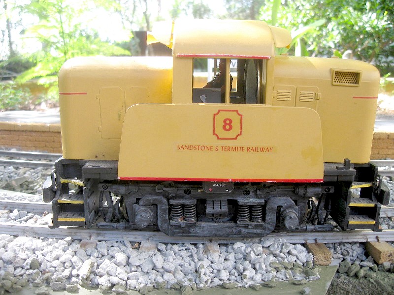

My diesel loco #8 batteries have ‘had it’ (after 9 years) so I used the eight Aldi cells to replace them. (the old 8 cells test at 4.1 ohms internal resistance 10 times the new ones!)
There are 4 cells in each end of the loco. I soldered, cleaned with metho and vaselined the connections. (Note - they are nipple type, but I have never had problems soldering to the nipples or the flat neg ends.) After about a 1 hour run, they took 600mAh to recharge.
