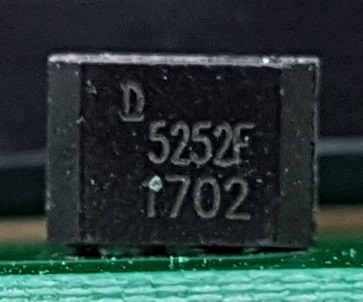

Ah and yes.... this is one of the secret components that must be identified. Any help identifying it is much appreciated. I am sure it is just a standard component but I don't have a good clue what it is called and what specifications it has.

1702 NPN transistor. Google it for spec sheets.
EDIT: No,it's a LED driver: https://www.aliexpress.com/i/32949338594.html

It doesn't look like there is any charging circuit in that. The solar panel just charges the NiMH cell. The LED driver shuts off the LED when the voltage drops below a certain point. Don't replace the LED with the motor - the chip has some current limiting function. You should run the motor straight off the cell.
The other component on the board is an inductor. The data sheet for the chip can be found here: https://www.mikrocontroller.net/attachm ... QX5252.pdf

The little black component on your circuit board is, I think, a variation on the QX5252F LED driver which is available from ebay and which I used.
