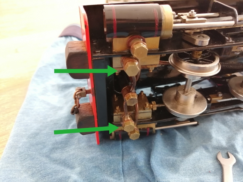

Re: Finescale Engineering Quarry Hunslet issues
I removed the following bolts and when the boiler is filled with air and the regulator is opened air comes out of the openings:
Not a blocked pipe then!
Tighten them back up and apply more air. Do the wheels lock up or can they be turned by hand? Is there any air blowing up the chimney?

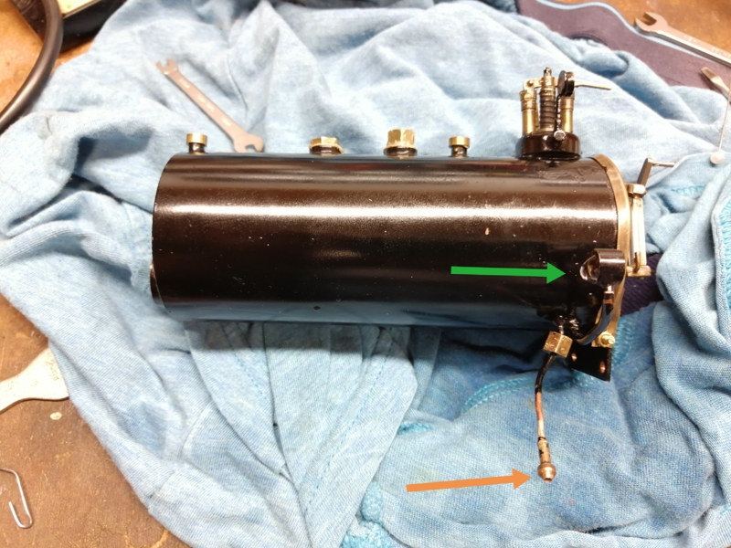

Removed the boiler and the chassis run fines on air.
Pumping air into the boiler itself and then opening the regulator air comes out of the outlet indicated with green arrow:
However, as the pressure gauge outlet marked with an orange arrow does not exhaust air despite being able to poke a pin all the way down the pipe I don't know how much pressure is in the boiler
I am not using a compressor to test just a pump with no gauge.
- TonyW
- Posts: 1357
- Location: North Wales
If the pressure gauge pipe is firmly blocked you could try this, but you might need an extra pair of hands:
Basically, you need to get some air pressure in the boiler, as high as you feel safe doing. Then gently heat the visible section of the pressure gauge pipe. It needs to be hot but not quite red hot and nowhere near hot enough to melt any metal! Hopefully the heat will dislodge the blockage and the air pressure will push the muck out, usually with a nice "pop".
That might work, it might not. I had one recently that did not clear with this method. I annealed the pipe over and over again, got it dead straight and then ran a long drill in to the end. That shifted whatever it was!
