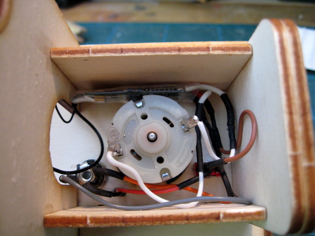

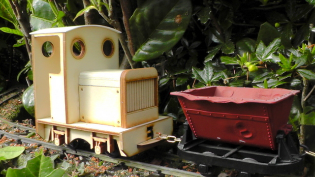

I've been at it again - this time an IP Engineering Albert.
I found the build to be a bit fiddlier than the HGLW build as some of the parts needed to be aligned by eye. However, probably a day's build to get her to this stage. She's powered by two 14500 (AA sized) li-ion batteries which just (only just!) squeeze in under the chassis. They are wired in parallel (to get twice the running time). Deltang receivers are happy to run off one 3.7v li-ion battery and include automated Low Voltage detection to cut off the supply when li-ion battery packs fall below a safe level. I've set her to 32mm gauge as she will shuttle back and forth on the copper mine feeder line (using the built-in shuttle feature on the Rx65).
She's controlled by a Deltang Rx65a receiver. The Rx65a has been superceded by the Rx65b, which is slightly larger and more powerful. However, I had this Rx65a left over from a previous conversion and so waste-not-want-not! The receiver is just visible above the motor in this shot.
I'm going to add Delrin sprockets and chain drive to improve her pulling power but she will happily pull three Binnie skips (providedI don't try going round any curves or up any hills).
I'll blog the build when I've done a paint-job on her. I focused a lot more on the wiring-up this time as I know that's an aspect which some people feel apprehensive about.

Nice little loco, it could do with a bit of weight I guess..
And it needs a scale fire extinguisher, you are a brave man putting "Trust Fire" batteries in a wooden locomotive.. :lol: :lol:

I did put a bit of lead in her, but the problem is the 2wd chasis. I know from past experience what a difference adding 4wd can make. Before adding 4wd, my Simplex could just manage 4 skips on the flat but that was her limit - and she certainly couldn't tow them up a gradient! As you can see, adding 4wd made a world of difference - no extra weight was added, just used the weight of the whitemetal body before and after adding the chain drive.

Not sure, as yet, Ian. At the moment, the HGLW loco is by far the most powerful, but that's because it has 4wd as standard. After I've installed 4wd on the IP Engineering loco I'll be able to make a better comparison.

You're quite right. It would have made a lot more sense to install the 4wd mechanism during the build, but I was doing this one as simply as possible purposefully for my blog. I realised, when replying to someone who had enquired about fitting radio control, that nowhere on my blog was a simple description of how to do it. All my descriptions include wiring-up additional bits and pieces like directional lighting or soundcards. So I kept the initial build and rc installation as straightforward as possible. Just like the HGLW build, I'll write up the detailing ( and the fitting of 4wd) as a separate posting. I'll put a link in the first post in the mechanism section to the 4wd post, mentioning it would be a good time to fit the chain drive but a first-time builder might prefer not to have the added complication at that stage (but might decide to do it later).
Sorry, long answer to a simple question.
