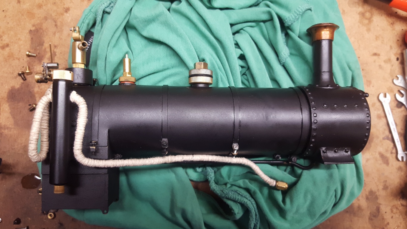

Re: Wet exhaust coal firing
As the weather is so pants at the moment I don't mind this loco being out of service so I thought I would lag the pipes:
I will paint the lagging black I think (I know most paint it white but as the lagging is over scale to be more effective I don't want it standing out).
- GTB
- Posts: 1694
- Location: Australia
Neat work.tom_tom_go wrote: Sat Jan 27, 2018 6:31 pm I will paint the lagging black I think (I know most paint it white but as the lagging is over scale to be more effective I don't want it standing out).
Ships and power stations have white steam pipe lagging. Can't say I've ever seen it on a full size working steam locomotive, although there are probably over restored 'preserved' examples out there......
