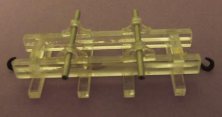

The frame is made of two parts laminated, the draw bar is preformed and retained in a slot by the end cross beams. The axleboxes are laminations assembled on the axle and all the parts are lightle engraved to aid assembly.

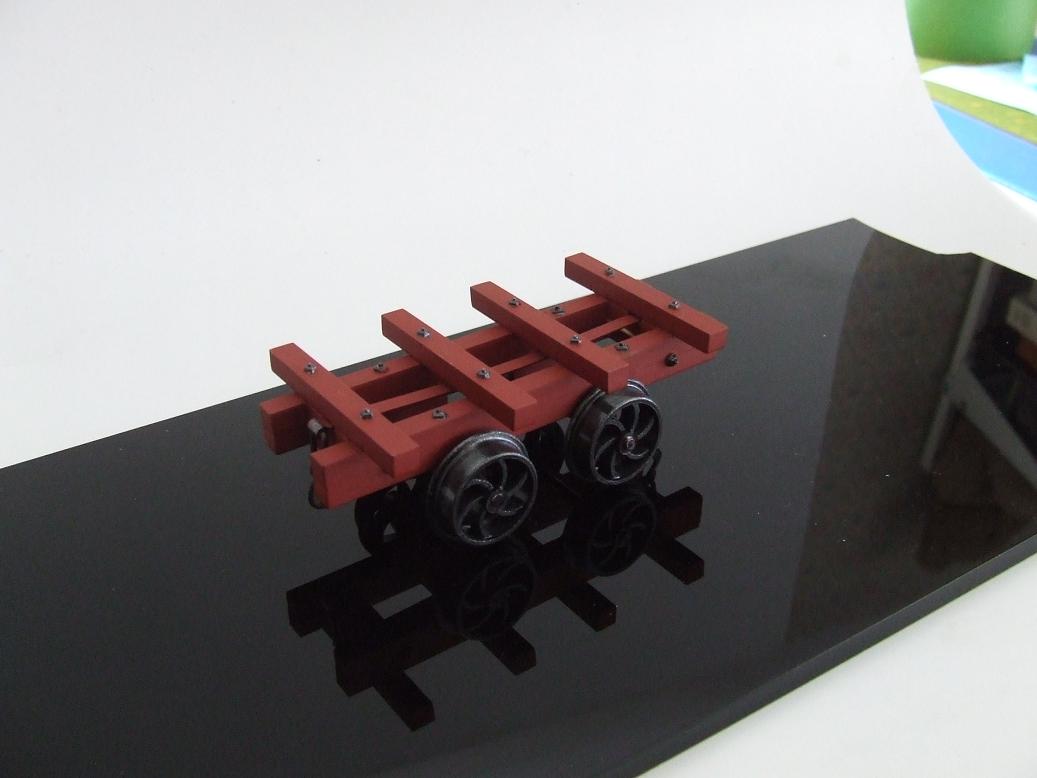

Here is a pristine slab truck just built and painted.

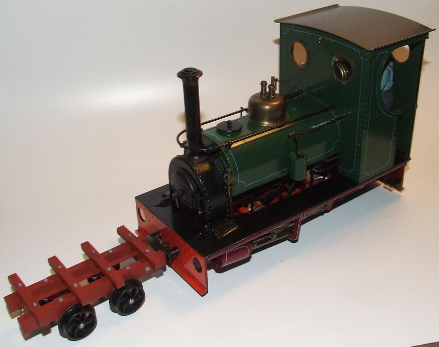

The last photo shows a quarry Hunslet of mine with the first slab truck made- just to get me in the mood to knock up some more which will be distressed and be painted up to like like really old wood. I will need a trip to Wales to find some thick slate to load them with.

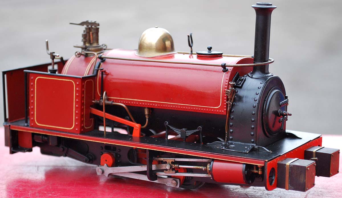

Wildly off topic but what a beautiful Hunslet - who is the maker?

Hi, Spud uk, the Hunslet was made by me. It was made in 1992 and was one of a batch of 8 I built. They were rather an error. Each (except this one) were near exact models of a quarry Hunslet as it was in a specific year. They all have full inside the correct frame profile, Rivets in the place they should for the given the prototype,full Stephenson's valve gear and consequently had gas tanks that were on the small size only having about 15mins of gas. They took a long time to built and even longer to get to run well, each was very much handbuilt and were in a business sense a disaster. The one in the picture is a quarry tank that never was. I do not think there ever was one with the attractive scalloped cab and a dome on the tank. It was my reward to myself for building them. My current Hunslets do at least use all the lost wax castings I made, so after a long wait the investment is starting to pay off!
tight from 3-quarter.jpg (111.06 KiB) Viewed 19420 times
Also off topic, but is this another one of the batch or a later one (dated MD Wright 1995 underneath). Lovely model in any event.

Hi, that is a nice Hunslet. I do not remember the dome on the tank. I was rather careless about what I made in the past. I did not systematically photograph all the engines I made. Lovely to see an old friend again thanks for posting the picture.
